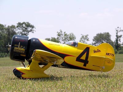

Default Gee Bee with OS 70
I flew mine two weeks ago with an OS 70 4-Cycle swinging an 13x7 prop... plenty of authority... some yaw on full power climbs. I'll adjust the thrust line with washers to correct. Flies great at 1/2 throttle. No problem with the landings 1/4 power until the main wheels touch... power off to slow down until the tail drops... full aft stick to hold the tail down until parked.
Only complaint is the fiberglass pants... minor off field landing after engine died... wheel pants caught the grass and the plane tipped up and crushed the pants... fixed with some work.
I would not fly this plane with a smaller engine but based on the power difference a 52 would be plenty. I just wanted the extra power. I have pictures posed: http://www.webmasterphoto.com/geebee
I'll be flying mine with a buddy who has the same kit with an OS 52 4-cycle on the weekend of May 17th. I'll post some video clips of the flying for high bandwidth readers to see the comparison.

If we are not blown away down here in Alabama I will try to fly mine this weekend and get some pictures of it outside. I also had to repaint my wheel pants last year after a bad ground loop. They were only scuffed and not near as bad as your photos. I have a .56 Saito in the Gee Bee and a .52 OS in a Kyosho Stearman. There is a world of difference in these two engines. I do not believe I would be comfortable with the OS engine in the Gee Bee.

Default Video has been posted...
Well,
As promised, I posted comparison video: http://www.webmasterphoto.com/geebee
Bottom line: The OS 52 powered version flies great. We were in OKC which is at 1200 feet above sea level. It was swinging an 12x8 master airscrew. The OS 70 was swinging an APC 13x8. In the video the power settings between 50 and 75% and while the potential for good vertical exists the plane is so small that we did not want to get them that far away.
It was also pretty windy as can be heard in the audio 8 MPH with Gusts up to 12 MPH were pretty standard. We did not get video but we had both in the air at the same time and it was a site to behold.
We took the wheel pants off as well since the runway that we cut to fly from was pretty rough and the replacement cost is $80 a set.
Enjoy
