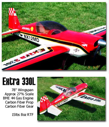

I have the BME 44 in my Patrick Extra . I am at exactly 15 lbs, 7 oz now. I was just over 16 lbs before I 1) switched to carbon fiber gear and 2) took some ballast out of the nose. The 44 has very good power. If I already had a 44, I would use it. If I was buying new, I'd probably get the BME 50.
I am just coming off of break-in mix on my 44. I just ran the seventh gallon of fuel through it this past weekend. Engine seems to be gaining power. Vertical is unlimited. I couldnt tell you much about power to vertical out of a hover, because my hovering exits have been less than vertical so for. The plane is still pretty new to me.
-Cheech
Mine is a first run Patrick. I have a few notes and some close up shot of my BME 44 mounted up at http://www.devino.org/mark/airplanepics/dp330l.htm

Hi Cheech,
I looked at your website. Nice looking covering job! I saw that you mounted your tank in the stock location. Does this have any adverse effect on flight as the tank transitions from full to empty? I am starting to build mine as was thinking of relocating the tank over the CG. Where is the CG on the plane without the additional 4 oz.? Any recommendations?
Thanks in advance.

I left my gas tank in the stock location. The CG doesnt really change much, or if it does it is not negatively noticable to me. The instructions from DP suggest CG at 5.75". Mine is at 6.25" from the leading edge and the hard core 3D guys have theirs at 7". At 6" the Extra is a baby, but that CG is still maybe a touch nose heavy. At 6" it is stable and will land nicely. 6.25" is not much different but you notice it is more neutral when inverted.
The best most complete review I have ever read is Bill Pryors . It's alot of different places on the web, but I found it at http://www.rcaerosport.com/articles/...0/extra330.htm
