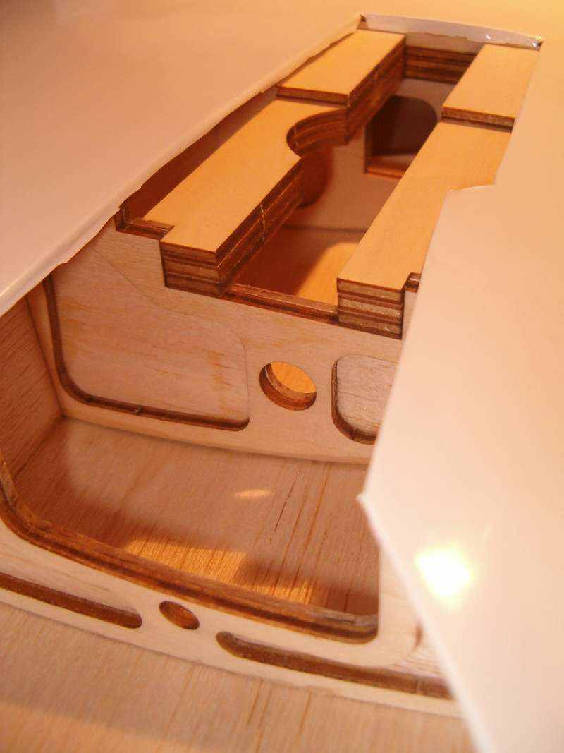

Well, time to get to work. Just got my Bear from Santa last night. Hey, have they beeeed up the gear mounts from what you others had (see pic below)?????? This looked pretty meaty to me. Just wondering if I really need to cut into the wing to beef it up or not. I have a pair of Spring Airs with 3/16 wire struts to mount.

....Hmmm have they beefed up the mounts or not [:-].....these pics were taken at the begining of October......Whatever, i employed Vamps mod....no problems.

I'll second that...No change on those gear mounts in the pictures.... If the rails that the gear screws to are narrow, You will have issues.... Think of the moment that the gear produces on those narrow rails.....Pretty easy to fold them back.
