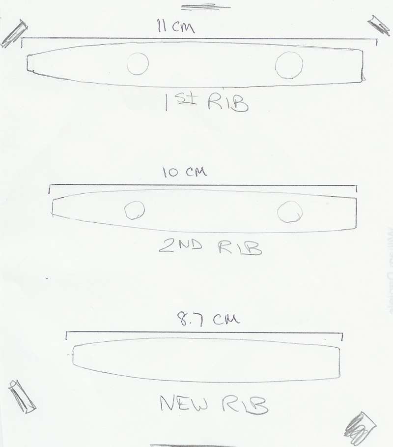

Update on Stab Failure
I called ACE yesterday and left a message for Steve in customer service about my stab failure. They are in the middle on inventory this week so I only got the answering machine.
Steve returned my call today and we talked in length. He was very supportive and is sending me new tail section first thing Monday after inventory ends.
We discussed the stab situation in length and we both agreed that if you plane to put the power to this plane you need to beef it up. He was very reasonable and sensible about the whole thing and had to admit that ARF's are made in factories by people that don't necessarily do it right all the time.
I personally don't have an issue with the RB or ACE. I think this is a great plane. Let me tell you, in the air she flies like she's on rails. For those of us pushing the envelope you need to expect to make mods. plain and simple. If it is to much work for you, get a different plane.
Some key points Steve made in our discussion:
* Make sure the surface where you glue you bulkheads is prepped well a good slow setting epoxy is used. He has had some reports of these break free from the fiber glass.
* The stab rods are not Carbon Fiber. They are Fiber Glass and can potentially flex. An ACE rep with the RB fitted aluminum rods inside these tubes to strengthen them. (I think this is a little much, but what do I know. I may look into getting some CF rods though, I don't want to add the that much weight to my tail.)
* Do not use more then 2 degrees of down thrust for the engine. I forgot to ask what the stock setup is but I think it is good deal more than 2 degrees.
Well, that's it for now. I strongly urge those of you running big power to cut into that stab and beef it up.

Just opened up the stab that was still on the plane. This one was just started to show signs of play. The first pic gives a view of the 2nd and 3rd ribs in the stab. You can see how well I got epoxy at the end of the large rod. You can also see that while the 3rd rib had good factory glue to the skin, the 2nd did not.
The second pic shows where the front rod meets the 2nd rib (which also had good expoxy contact that can not be seen due to angle). You can see the stress cracks. You can also see where the skin is separating from the first rib, and where the factory cut through the 2nd rib.

For those of you that want to open your stabs and reinforce, I have attached a PDF with patterns for the ribs. I tested and at least on my printer it prints to scale. Just to be sure I included the overall length in CM so you can verify if yours prints to scale.
There are 3 ribs in the diagram, the first rib, the second rib, and a new third rib that I am going to insert between the existing 2nd and 3rd rib. I am going to extend the first rod to be longer to meet this new rib.
I wouldn't trust the location of the rod holes, but they are there for approximate reference. I would finalize them after laying them in the plane against the existing rib.
My plan is to double the first and second rib, and then add the new third rib to accept the extended front rod. I ordered carbon fiber rod from Dragonplate.com that I will use to replace the fiberglass rods that come with the kit. The rod has the same inside diameter, but a slightly larger (about .002) outside diameter, hence a thicker wall. I am a little concerned about the larger diameter because there is not much wood between the outside if the rib and the rod hole. I think I will slightly enlarge the rod holes in the ribs, and slightly reduce the diameter of the CF rod using my 1 inch belt table sander.
This may be overkill but what the heck. For those of you reading this and saying "MY GOD!!!!!",,,, I suspect that if you just cut into the bottom of the stabs and ensure that the rods are glued to the ribs, and the ribs are glued to the skin, you would probably be ok. But since I have a 160 up front, I think I will beef it up a little since I am in there.
Also, I made the new 4inch forked pushrod so that I can move the elevator servo to the rear. I know this will add tail weight, but I was never happy with that stock balsa pushrod. The pushrod is 50 grams distributed from CG to rear of plane. The servo and new linkage is about 35 grams, so it won't be to bad.
All in all I am sure I will have to add a little nose weight, but not to worried with the 160 up front.
I will post pics when done. Waiting for the stab from ACE. Hope to have it today.
Here is the template for the ribs.
Ops, just tried and can not attach a pdf. Hmmmm. I will just attach the scanned jpg. I just tried printing and if done correctly it does come out scale. If you have a problem and want the PDF send me a private message with your mail and I will send you the PDF.
