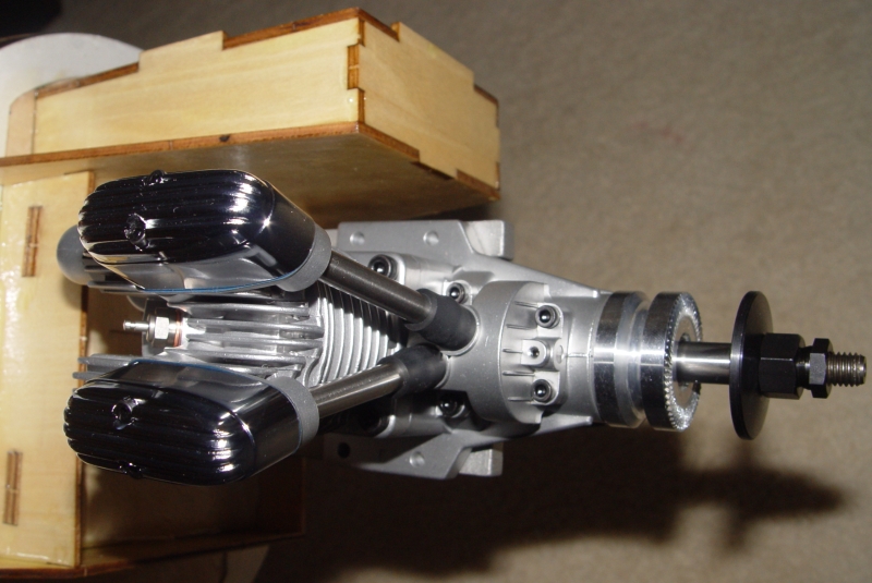

I received my Saito 1.80 the other day and it fits in the supplied motor mount without modification. It will not however fit within the cowl mounted sideways. I want to mount it inverted so I don't have to cut the cowl on the side but what is the best way to do all the measurements required to get it spot on dead center mounted inverted?

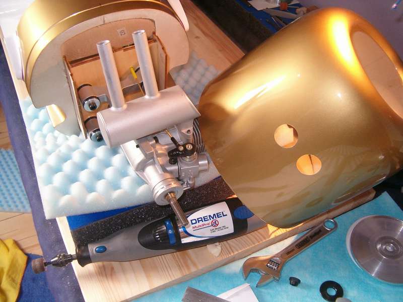

....just about finished, just cut the cowl for the muffler.. servos right behind the firewall, everything as far forward as possible....balanced as per book .....AUW ... circa 9 lb 12 oz . did'nt think it could be done

Here is my solution to mounting a Saito 1.80 inverted using the kit supplied mount. I had to cut away the floor of the battery box because the mount would not fit up high enough to get the engine centered. After relieving the underside of ther battery box and verifying that the mount would fit, I used the scrap servo tray ply to cover the holes created in the battery box. Everything was epoxied and a thin layer of epoxy/alcohol fuel proofing applied. Also, the blind nuts still fit on the back side of the firewall, they were right up against the battery box though.

Frag..Big Saito..
...how far is the prop driver from the firewall....its 30 mm from the firewall to the tops of the cap head screws on the mount yeah ?... then 138 mm from front to back on the big Saito...do you have a side view photo square on..?

According to your values the front of the prop driver will extend 15.4 mm out of the cowl..so it won't be right up against it. I'm willing to accept that and since we have that nice big shiney spinner I'm hoping it will mask the gap from view a bit. I'll snap a pic of it from the side after I trim the cowl for the engine head clearance.

Frag..
...Lovely spinner it is too...
..anyways ..spaced out the spinner on this Bear to reflect what you may see..[:-]...dont look too bad..
I'm 99% done on this chap...still under 10 Lbs...Yesssss..
..anyways ..spaced out the spinner on this Bear to reflect what you may see..[:-]...dont look too bad..I'm 99% done on this chap...still under 10 Lbs...Yesssss..
