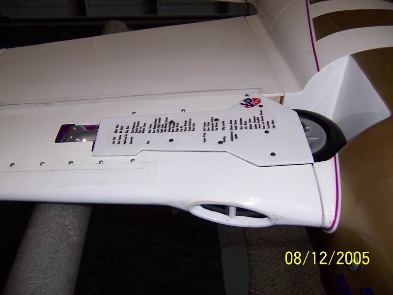

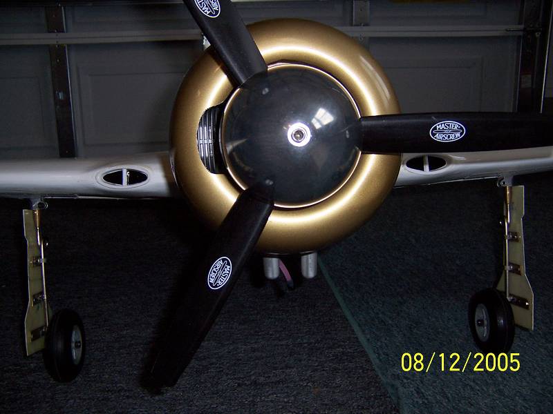

Hi Johnny, I would say definately get one, lotta work, but well worth it. I decided to super size the tires again, this time with 3.5 in. They just barely squeaked into the wells. I should have done this from the start like someone else recomended.
My new prop came in today as well, very anxious for tomorrow morning. Here is a couple of pics of the gear wells, note the BVM Polyply that is used to stiffen the gear doors. It is approx .20 thousanths and quadroupled the stiffness of the flimsy ABS plastic gear door. I then siver soldered a couple of wheel collars onto some brass brackets and now I can adjust the doors for a flush fit. The large wing panel that covers all of the landing gear mount mods and is screwed and taped to the wing is also a .10 thousanths piece of polyply that has been painted white. Front pic shows the ugly cutout to allow for more cooling. later......
