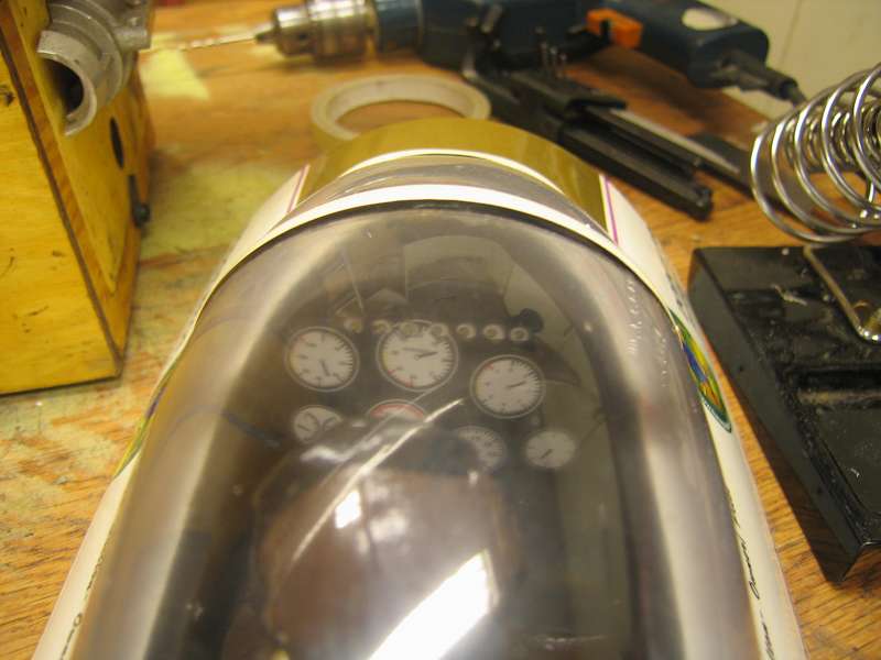

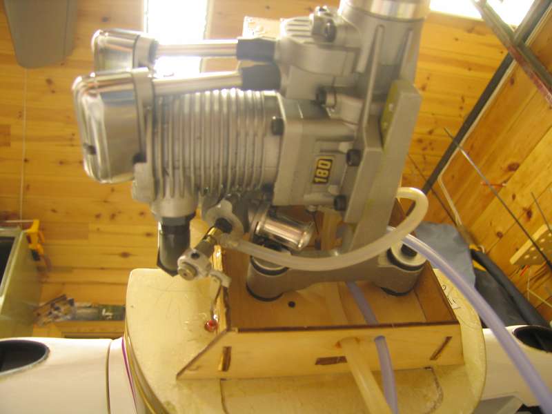

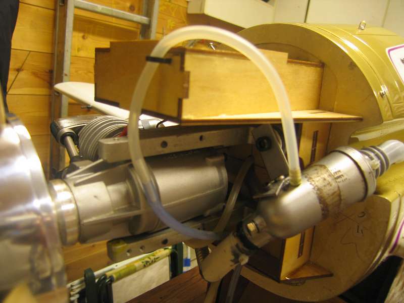

I have been using some afternones now for finetuning the engine-setup regarding the glowdriver and engine (squishband clearense).
I now have a safe idle of 1800 rpm with a 16/8 threeblade prop.
One of the pics showing the gauges in the dashboard ( dont know if that is the right word) that has lights in. My batteri-indicator is glued to the backside of the dashboard so the led,s are acting as lights for the pilot.
Some pichures show how the house for the exhaust is wraped around the engine to make sure the smoke will escape out of the plane on the same place as the original Bear.

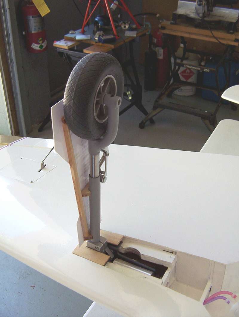

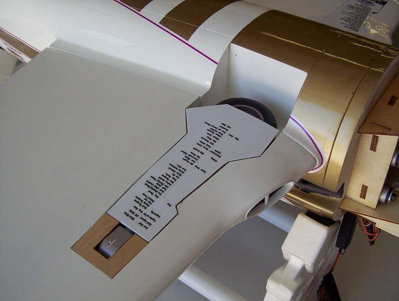

We have almost completed our Rare Bear. For the retracts, we used Robart 550 mains with Robart 661 offset struts. I have enclosed three photos of the installation.
