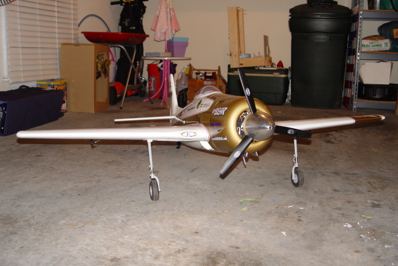

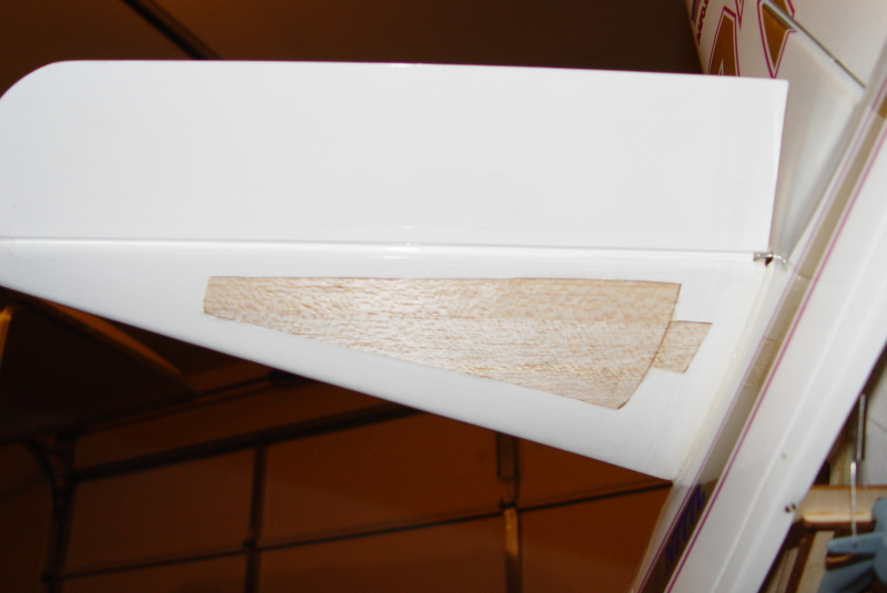

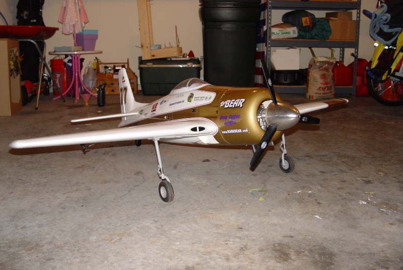

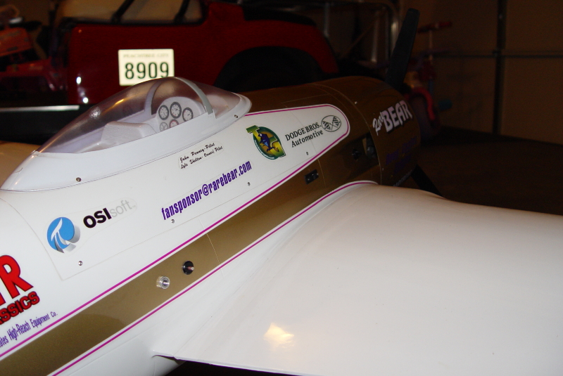

Here's some pics of my nearly complete RB..I found a place for all that stuff
The uncovered stab is now coated with Gorilla Glue inside...the other stab was done with epoxy to make sure everything holds together in there....kind of an experiment I guess to see if one side holds any better than the other..
The cowl was only cut to allow the heads of the engine to poke through. Is that going to be enough cooling for the Saito 1.80??
I still need to find a good way to attach the wheel bay doors to the struts in a nice and sturdy way so that they stay on in flight! Any ideas with that would be appreciated.

Depending on your gear size, Robart makes gear door brackets for all different size struts. Example at bottom of page: http://robart.com/RoboStruts/440_Series.aspx

Thanks for the link, but I think that method of attachment is for hinged doors. I'll come up with something I'm sure.
