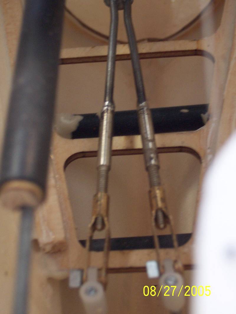

Again, I would suggest that you do more to the stab than just ensuring the factory glue joints are glued properly. It also needs to be "beefed" up signifigantly.
Last week I was at the field and my buddy and I got into some impromptu racing, my RB against his Lil Toni. We were both between 110 and 114 during straight and level radar passes. Then my buddy starts diving and rips off a 120 and then a 130 mph pass! Well not to be outdone I fire up the RB, takeoff and start with my diving passes, I clicked off a 116, then a 121 and my final attempt from about 500 feet straight down with mr. OS 160 wide open, I would guess at approx 125 mph, resulted in elev flutter followed by some pretty fantastic up and down oscillations. I immed pulled the power back, dropped the gear and limped my way back to the runway. I had to hold almost full backstick and full up trim to maintain level flight. I actually made a greaser on the landing. Post flight inspection revealed no damage to the plane except my elev pushrod looked like a pretzel and my JR 4131 servo was stripped.
The lesson
1. Dont dive your RB from 500 feet wide open.
2. Dont make pushrods using threaded rod. The rod is very weak, use piano wire instead with silver soldered threaded rod ends. I also replaced the 4131 with a metal geared JR 8411.
Anyway I am just returning from the field with four more flights on the RB. Still flies great......just keep the speed below 120mph and you will be fine.
That way you aren't using a piece of wire or threaded rod. Do you have to use a piece of wire because of room considerations?
Just wondering,
Don

I would suggest that you use carbon fiber pushrods with short lengths of 4-40(3/32) piano wire at each end. On my previous pushrod that flexed and bent, the arrowshaft did not flex or bend, only the 4-40 threaded rod at each end of the shaft did. If you make your whole pushrod out of this material it will flex. If you try to run the 4-40 wire through a pushrod tube you will have to install many support braces which will be difficult to do with the fuse already complete. The arrowshafts can be purchased at your local archery shop. I paid 20 bucks and got three of them and glued dowels into each end. You could also take Hattend's advice and buy some pushrods through B&B or central hobbies. Trust me, arrowshafts are the strongest and by far the easiest to install. Also if you want to fix the tail properly you need to lengthen the arrowshafts anyway.......so you might as well buy your pushrods since you will be at the archery shop anyways.

Thanks for the tip. however I have had great luck with the 4-40 pushrods like I want to install. and there is alot of room that I can install the bracing needed for them in the fuse.....I do have a couple questions tho....on the inner frame work in the fuse there is 2 holes 1 per side of frame work....that looks like the wing tube should go into...and it is all the way up where the wheel wells are. is this right? or did i F something up here? I am also thinking about adding brace for the wing tube on each side of the fuse where the tub slides into the fuse...has anyone thought of this or is this to much?
also on each wing where the tube goes in the wing is it needed to do anymore frame work inside the wing ? other then frame up where the gear is? And since I am using a YS 140 I am also thinking about making the wings non plug in's.....one con I see to this is where the wing tube goes in the fuse it is right over the servos....guess I could move the Elv. and rudder servos more back of the fuse out of the way of the wing tube. and stick the air tank and recv. way up in the front as far forward as I can get em.....BTW I am adding a second Elv. servo to it.
