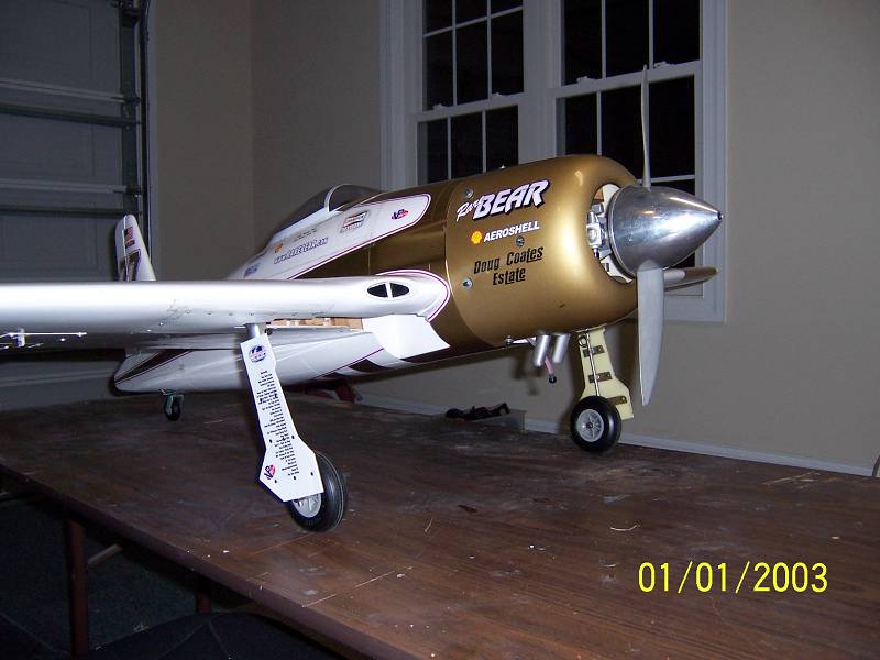

Here are a few pics of the new and improved Bear after the midair. I have about 15 flights on it since the rebuild. New fuse and tail feathers, everything else is from the original RB. Two bladed prop does not have the same presence as the 3 bladed one, but the 2 bladed one is certainly alot faster.
ID:	352013   Click image for larger version
ID:	352014   Click image for larger version
ID:	352015   Click image for larger version

Old 11-11-2005 | 06:55 AM
  #1128
Ad Clark III's Avatar
My Feedback: (8)
Joined: Sep 2003
Posts: 254
Received 3 Likes on 2 Posts
Default RE: ThunderTiger Rare Bear
AndreasE,
Sorry about your loss. Kinda looks like none of the tail mods were done. Anyway, the red lines outline perfectly how the arrowshafts in the tail need to be. The green arrow points to where I installed a 1 inch thick rib on each side and also dont forget to gorilla glue it after that. I also didnt open up either one of my stabs, it isnt necessary.

Cat5752,
I actually didnt open up either one of them.
Yesterday I was at the field with RB #2 making approx a 130mph pass when I heard a sharp crack and my Horiz stab began to flutter violently. The airplane pitched up and I didnt have any elev control, I chopped the throttle and it went deadstick straight in from about 100 feet. The airplane did not lose any parts while fluttering, both horiz stabs stayed attatched.
Closer inspection revealed that both arrowshafts in the stab(where they pass through the fuse) had snapped! I took one of the stabs and cut it open on the bandsaw so you can have a look at my mods.
1. arrowshafts have been lengthened
2. gorilla glue in all panels
3. Rib at the stab root is made out of plywood and maple(approx 1 inch wide)outlined in blue marker.
Who would of thought the weak link in the stab would be the arrowshafts? Anyway, I had a good time with my RB and if you keep the speed in the 120mph and below range its a great airplane with the mods. BTW..I was running an APC two bladed 15x11 prop on a OS 160 at 9400 rpm. So..I guess I am outa the RB business for now. Later

Thats what I think as well. Those were carbon fiber arrowshafts. I couldnt break that stab with both hands on the ground if I tried. I guess there some pretty unbelievable forces acting on that stab in flight. I wasnt radaring it the time of failure but based on previous flights that day it was doing about 130 in straight and level flight when the stab let go. Its got me scratching my head. I guess if I ever build another one I will have to make the spars out of titanium.
I concede, the RB has given me a good ol fashion woodshed beating.
