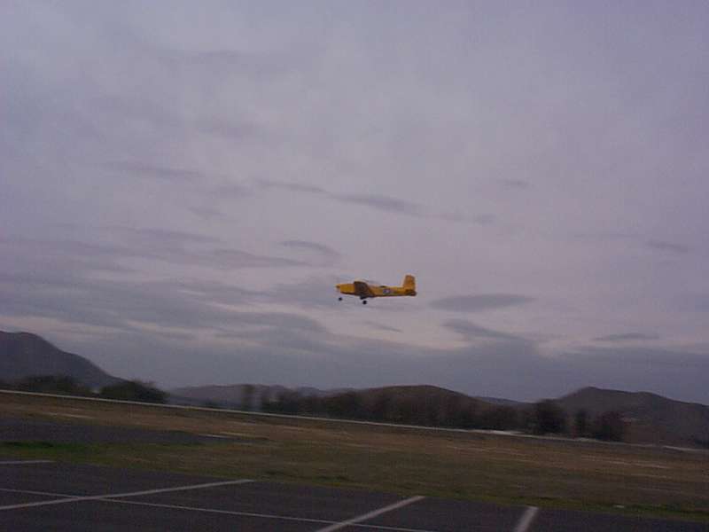

24 flights of hard yanking and banking on mine and still going strong.....................................
I went over the plane before i assembled and re-inforced any all-ready glued joints with epoxy for added strength.
Also after reading your post went and double checked mine before flying today and have no signs of problems with the tail area.
Hope you find out what happened. It sure is a nice flying plane. Gets nothing but great coments at the field.
