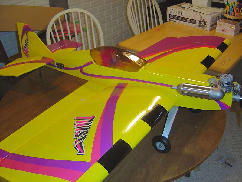

OK It's done! OS 46 FX with Tower Pipe balance 5 1/4", 4" Ultracote Yellow and Black Check under the wing.
ID:	247273   Click image for larger version

That looks sweet RCBOZO! Personally, I'm ok w\ my .46ax, it could use a tuned pipe for extra power but I like the way the twist flies w\ a 46.

At 5 1/4" you're gonna be able to do some flat spinnin for sure! Be careful on landings though. Make sure you don't run it too low of fuel either until you get real used to it. Be safe, not sorry. That's too pretty a plane to crash soon....besides, Barbie doesn't need any injuries!

Hey Ghee I can move my battery up about 1 1/2" up further to the firewall. Do you think that would make much difference with balance / stability?
Old 03-22-2005 | 09:08 AM
  #1494
ghee-grose's Avatar
Joined: Apr 2004
Posts: 1,229
From: Athens, AL
Default RE: Hangar 9 Twist 3D
Here's the deal....
If you measured your CG with an empty tank and it's at 5 1/4", then you should be fine. Fill your tank and it will be probably 4 1/2" or so. As the fuels gets lower the CG creeps back. As long as you are comfortable with it there it's OK. You will need to land with a little power in it, but not much. With idle, it will balloon up on you when you flare it in and you might stall it.
Now if you measure your CG with a full tank at 5 1/4" then you should really make some weight changes. As your fuel gets lower your CG will probably go to nearly 6" which would be INSANE!!!![:@][X(]
