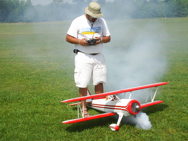

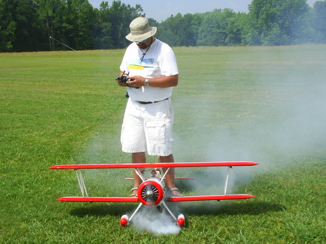

Sorry to here about your wing. I would also asks the "Elders" in my club about what to do. Some of them are MORE than willing to give advice.

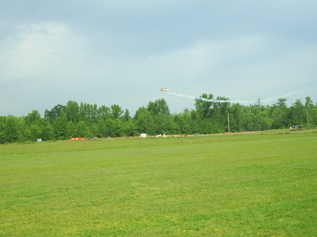

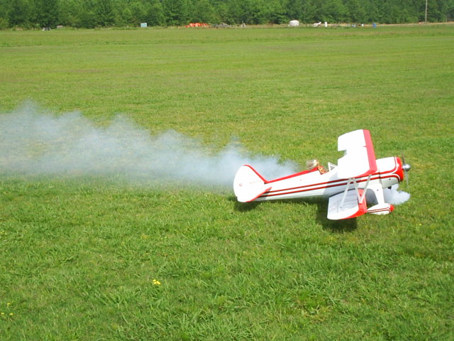

Enclosed are some pics of my Stearman with a TME smoke pump. This is an inexpensive way to get attention. The smoke makes this plane even more fun.

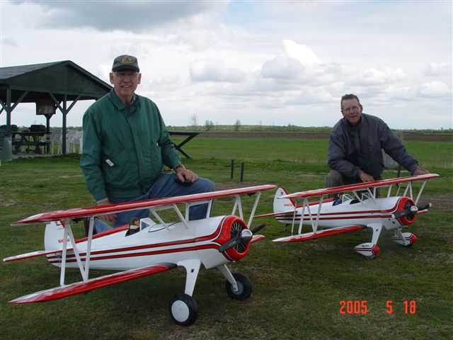

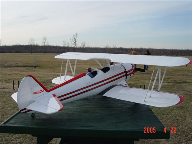

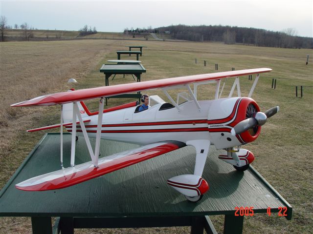

Yes, mine after 150 flights, the wheel broke in two. So now I have the Lite Wheels. I am attaching the two Stearmans in our club. The one on the left is a friend of mine he has a Saito 150 and it flies well, also he went to the wheels with the caps, and closed the front cockpit and covered it. It looks really neat. Mine is the one with the hwheel pants.
I am even flying IMAC with it. I have a FPE 40cc gas, and I tell you it is great.

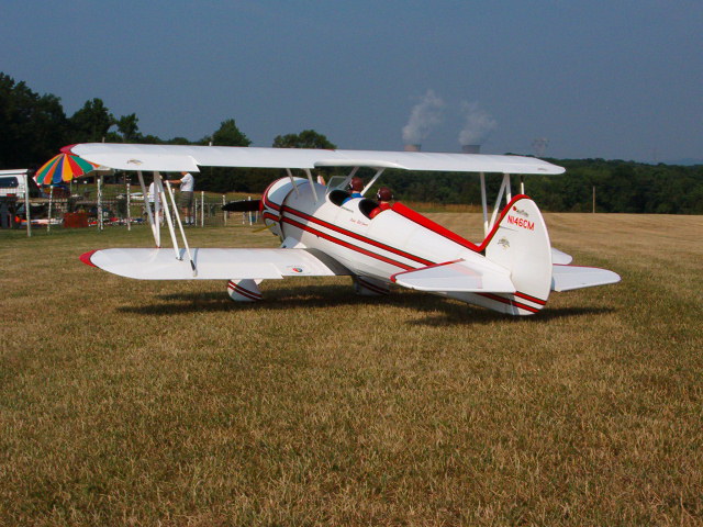

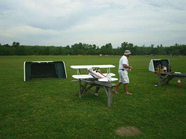

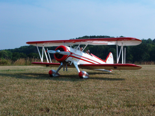

I haven't been in here a while but mine is done and has about a dozen flights on it. I got a Belia 18X6 prop from Aircraft Internal and it's bolted to the RCIgnitions G26. The prop really sets off the plane but I will tell you this it slows it down a bit compared to a Mejzlik 18X6. I also have a Slimline smoke muffler with the TME smoke systems as this plane just screams for smoke.
I originally had quite a bit of adverse yaw but once I got the mechanical link straightened out between the ailerons it made a huge difference.
BTW, with this setup it's somewhat heavy at 15.5 pounds ready to fly with fuel (12oz) and smoke (12oz) but OH what a looker [X(]
The most common question I get is "when ya gonna fly it" when I take it to the field. Then out come the camera's
