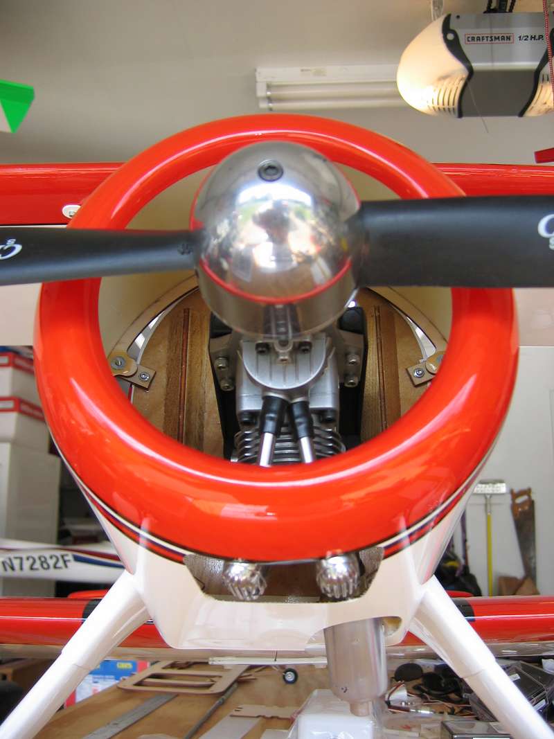

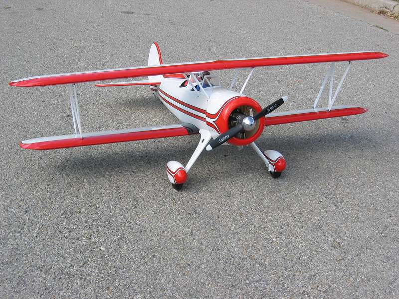

Here's the Stearman with a Saito 180 installed.. The balance is pretty close without any ballast weight up front..I'm going with the bottom wing servo's /w/connecting rods that are with the kit..
Cannonball200 of OKC..
See my Gallery for more pics..

Did you check the wing incidence?. If so how close to parallel were the wings?. When is the test flight. She sure is purdy.
Old 04-29-2004 | 05:53 PM
  #61
cannonball200's Avatar
My Feedback: (36)
Joined: Aug 2002
Posts: 334
Received 3 Likes on 2 Posts
From: Oklahoma City, OK
Default RE: GP Super Stearman
I have not checked the incidence yet.. I just bolted it up per instructions and it appears to be close to flyable.. I have a laser incidence tool and I will check it out.. I don't have a fly date set yet.. soon though..
