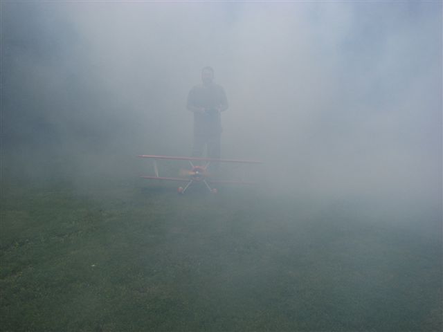

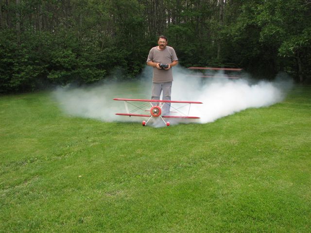

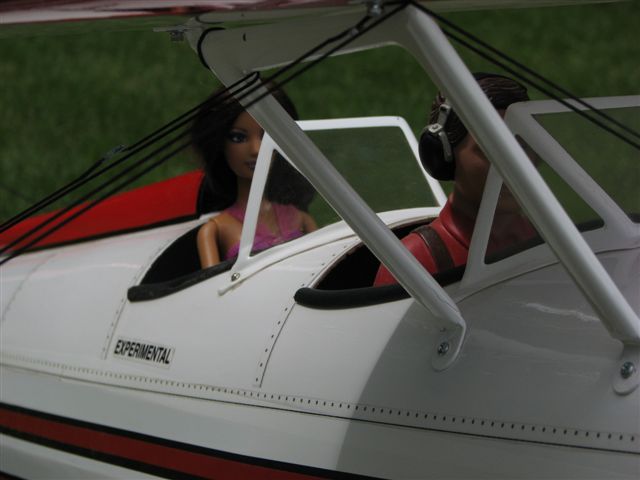

Hello all. I still haven't flown the SS, but I am close. Taxied around the yard some and got the motor purring nice. Tried the smoke system out, COOL

Beautiful Les! What engine and smoke system?

Thanks, I used an RCGF 45 with a Sullivan Skywriter pump and Supperdry oil. See post # 1491 for more pic's.
