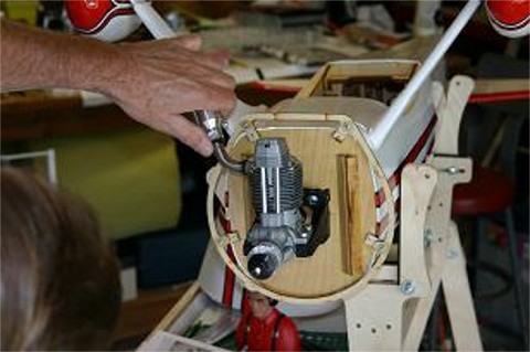

For all you guys out there that want to under-power this plane, I flew mine with a 120 Magnum 4-stroke and it flew pretty good scale, wide open, until the rocker arms got a little out of adjustment on the last flight. Go ahead and do it though, you too can look forward to this! Please take video for the blood thirsty in the crowd!!

Thanks, no they drop fast when you get off the power. Lots of drag. The fuse was unharmed and I am presently putting the plane back together with new cowl, landing gear, wings, and N-struts.

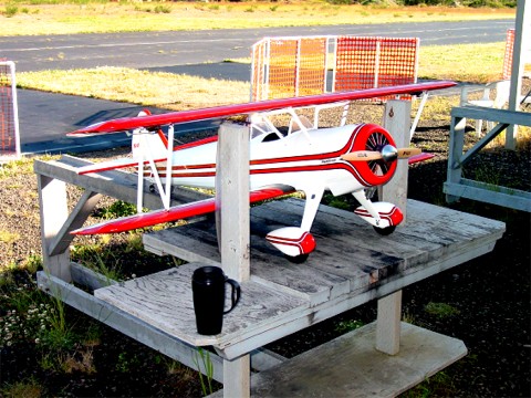

I want to tell you about my Super Stearman. Finished it this season in July. I love this plane! Fly's like a dream, just like a bipe should. Never fails to draw a lot of compliments at the field, and it makes me look like I actually know what I'm doing with the sticks.
Mine has a FPE 2.4 for power. That's a 41cc gas engine. No, INMHO, it is not overpowered. Consider this, stock engine on original full scale was 220 HP. Later versions had more, not sure how much more. But the Super Stearman full scale had 450 HP. Thats double and then some. Soooo, if you want to fly Super Stearman scale aerobatics, you need double the recommended power. After all GP's military version has same engine recommendation as the Super version.
I get very good vertical lines, not unlimited vertical mind you. Nice big loops, hammerhead turns look GREAT. Tail slides, stall turns,
cuban eights, split S...etc. All done with power and authority. If you manage the throttle on the down lines, everything stays in one piece. The airframe so far has been handling the extra power just fine. I have about 20 flights on it so far. I don't get to go the field as often as I would like.
I used Hitec 645 MG servos all around, except throttle, 6v battery pack on servos delivers over 100 oz in torque. Top ailerons are slaved to the bottom ones, plenty of power in those servos to do both wings.
I am a big believer in useing optical isolator on the servos when flying with gas engines, never have even a hint of a glitch with them. Also allows me to use two battery packs, one for receiver and one for servos quick and easy intallation with no tricky wiring to worry about.
I replaced the supplied foam wheels with Sullivan Sky Lite wheels. Only time I get a bounce is when I land to hard. This plane lands like a *****cat. Most of the time I can bring it in nice and slow, with just a little power on the 20x10 prop and set her down with a gentle kiss. Yes, it is a grass field. This plane makes me look much better than I really am.
When I assembled this baby, I managed to squeeze a 14oz tank under the stock one for smoke oil. Haven't installed the smoke pump yet, but have bought a sullivan skywriter pump. May need to get a smoke muffler also, will try it with the wrap around pitts style I have now first. This plane just screams for smoke.
Oh by the way, the engine fits nicely inside the cowl. only the exhaust and spark plug hang out the bottom of the cowl. Small hole in right side for the choke linkage is all. I get 20 minute flights on the stock tank supplied, how many oz. is that anyway? Still have a nice reserve on landing. The plane balanced in recommended range with no added weight also.
Many grateful thanks to MGA, alias Bob, for the posts earlier in this thread, and the many e-mails, which helped me greatly in finishing this bird.

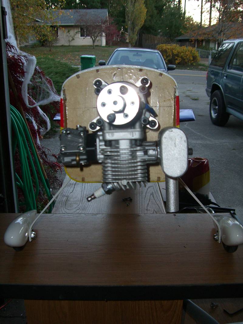

Got everything to rebuild the Stearman and am thinking of going with a BCMA 26cc gasser. How does yours fly on the Zenoah? We've got a 26 in a showtime and it puts out 13 pounds of thrust and isn't even broken in yet.
