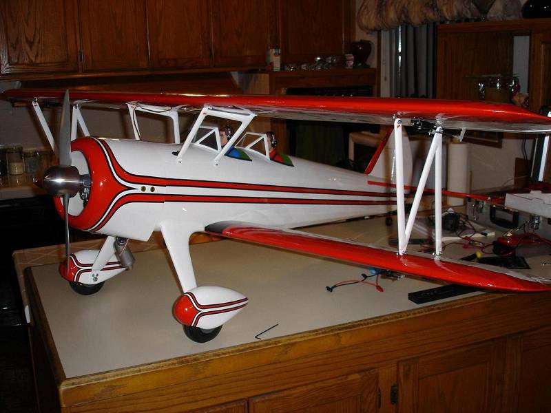

Here's a simple way to set the CG on this plane (or any bi plane).
I drilled a .046 hole completely thru the top wing on the centerline 5 1/2 inches back from the leading edge. Cut a piece of stock 8" x 1" x 1/4" and drill a .046 hole in the center. Take a piece of .046 wire about 6" long and bend a loop on one end. Insert the wire thru the top of the wing, attach the wood and attach a wheel collar to keep it from pulling out. Set the model on the ground, hook a piece of strong string thru the loop on the wire and lift. Add weight as needed. (Pic Attached)
You could also use this to balance laterally by just rotating the wood on the underside of the wing 90 degrees.
Ed
Ed

I used a piece of wood like that but I just picked up the plane with my fingers on the wood.It worked fine.I still have to fine tune the C.G.I was at 5in with 12oz of lead in the box.I took 4oz out and will recheck it after I get my engine back.Your plane looks great.Best of luck on your maiden.Keep us posted.
P.S. Mine weighs 16lb 2 oz at this point.A bit heavy.

Mine balanced right on with no weight ... my brother did his PT17 same engine and smoke as mine and his balanced right on with no weight. If you use 5 1/2" instead of 5" for your CG you might be able to take out the remaining weight that you have in it. Is there some reason you used 5" instead of 5 1/2" ?

I think you'll get a more accurate read on the CG if you suspend the plane on a string instead of trying to hold it with your fingers. Mine was just very very slightly tail heavy which is fine for me.
