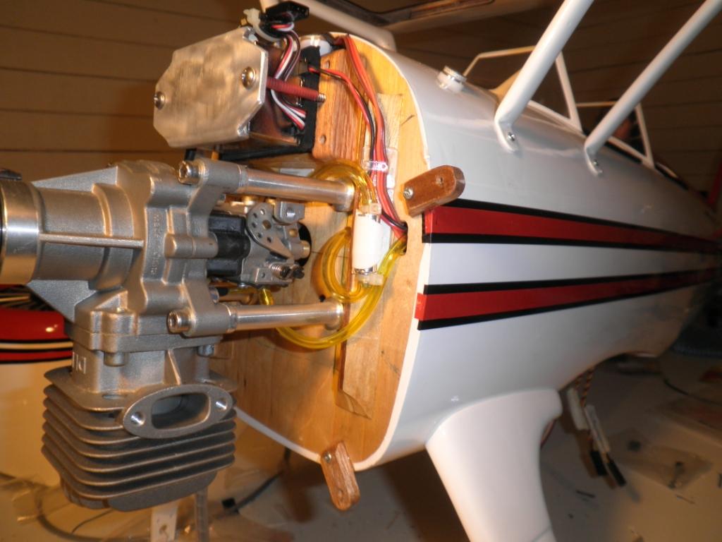

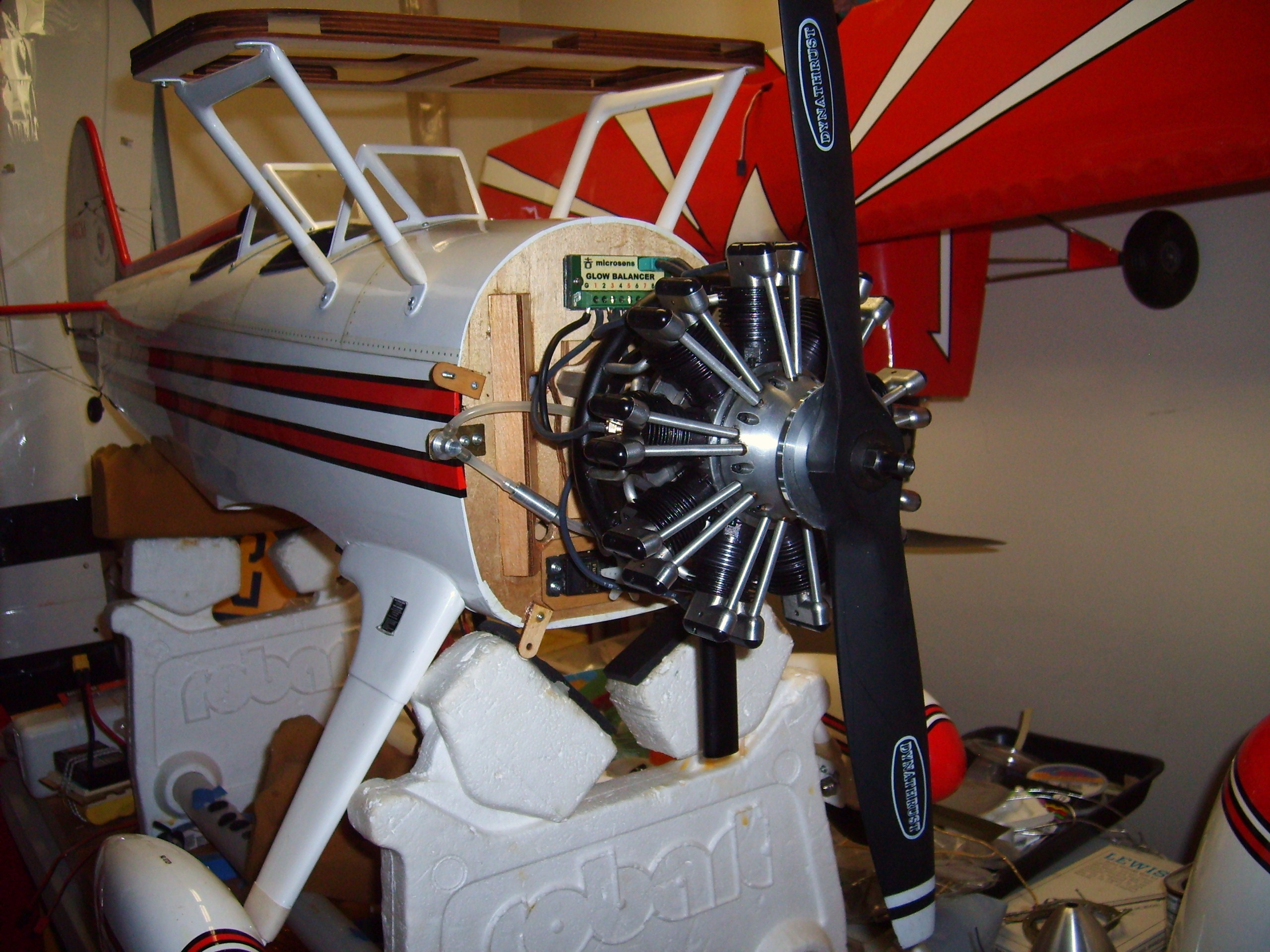

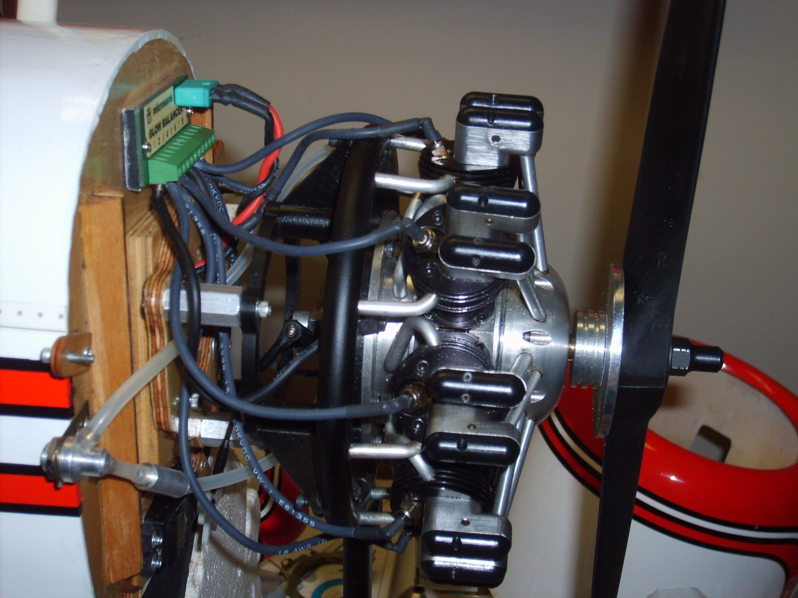

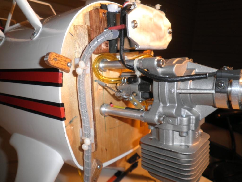

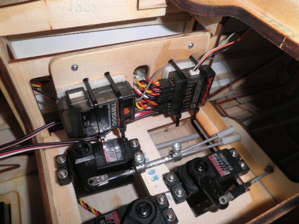

Me too Steve. I've been side tracked a bit the last few weeks trying to destroy a Hobby King Pitts foamy. For the price I'm getting a ton of fun out of it. I fly it out of my front yard of an afternoon after work. Its way too convenient!
Here's some pics of progress onmy Stearman. I havn't got too much more to do before I run it I reckon. I did initially use 2 x 5 cell eneloop packs for the reciever but they jittered the servo's (Hitec HS-645MG)until the voltage came down a fair way so I have since fitted 4.8v packs & have no problem. Check out the choke lever - on the dash where it should be! I've forsaken the passenger to give me some room for switchgear & charge jacks etc.

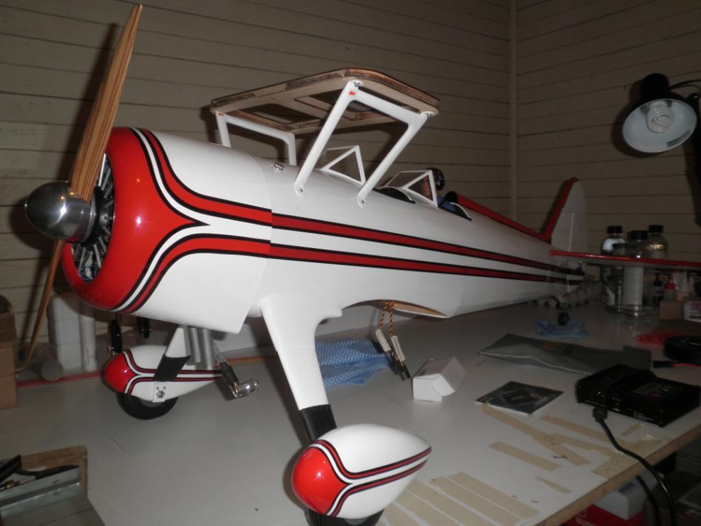

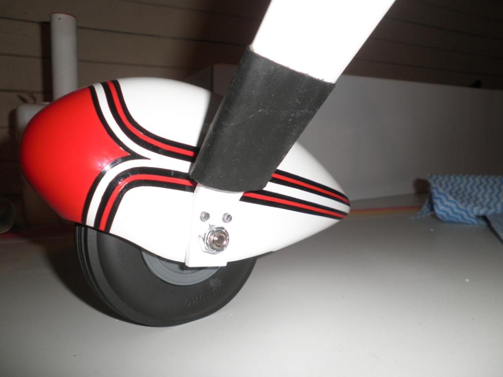

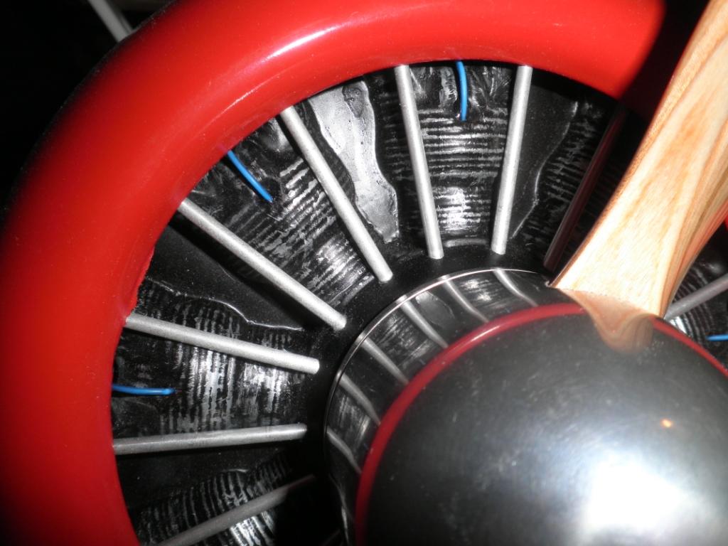

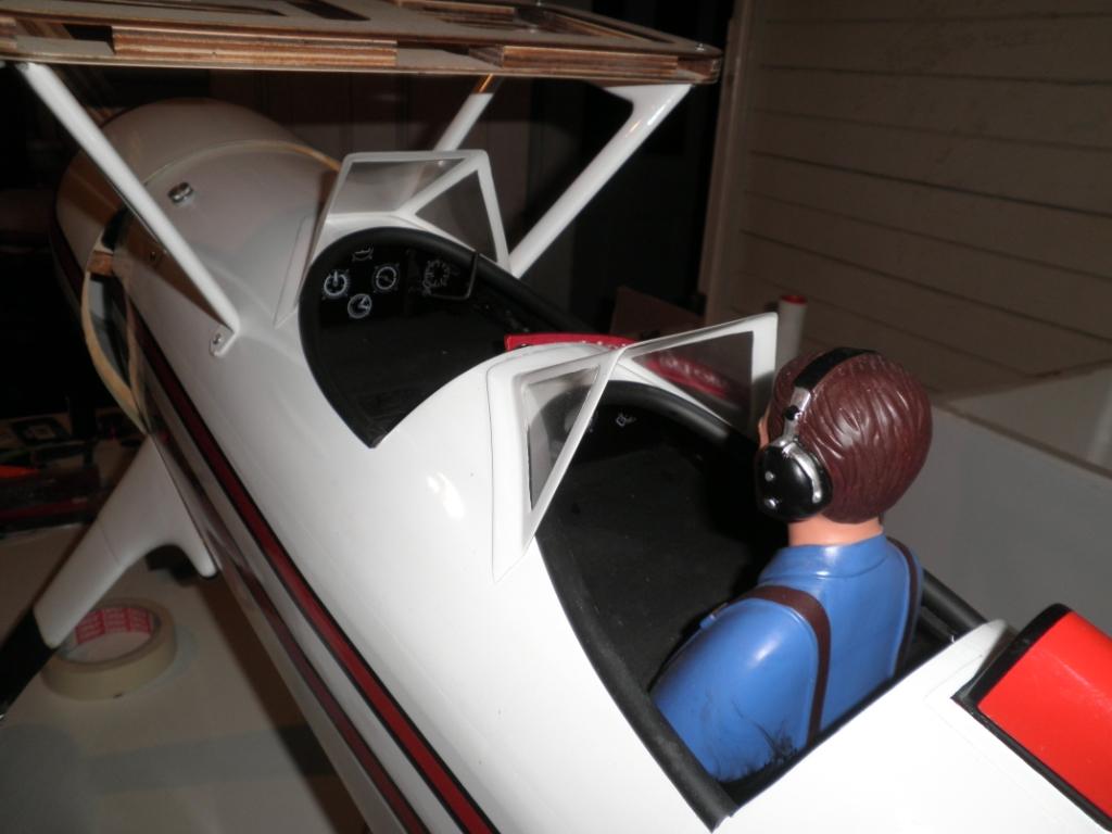

Here's a couple more taken tonight. I used a car paint touch up pen to highlight the cylinder fins & a blue wire to mimic silicone plug leads. Mightn't be true to scale but I reckon it looks ok.
I used some large electrical heat shrink on the lower landing gear 'cause I read here that the timber fairing can split off them. It might slow that process down I hope. I used a covering iron on it. I went with aftermarket inflatable tyres recommended on here too.
Mick</p>

Looks nice Mick. Thanks for showing the pictures of how you mounted the radio gear. I'm at that point now and it's always good to see how other people do things. What prop are you using it looks cool?
