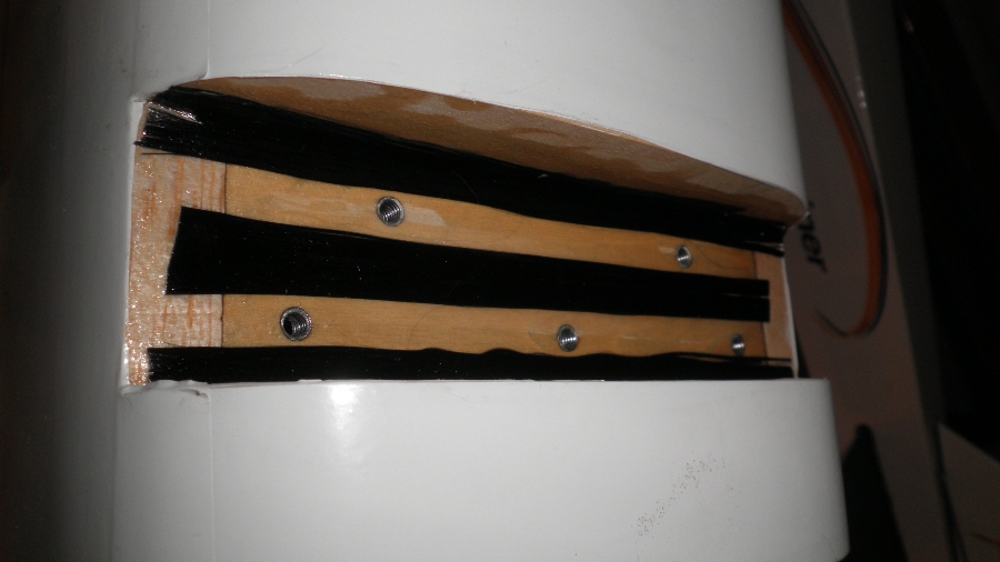

#1783
I can't see the pictures on the post, but what size of hinge points do you use? I've only had a couple of ca hinges fail, but I mostly fly smaller planes too like 40 size.
#1785
haha thanks Jim I may try these hinge pocket things out so I can remove the tail surfaces for mx and etc. I made a modification to my kit built 60 size extra where I ran a piece of music wire through the hinges that I could remove the aileron by just pulling the wire out. I havent modified the other aileron to mirror that one until i get a few more flights on it to see how I like it. I like the idea of being able to remove the surfaces easily though.
#1787
Yeah I like to be able to pull them off to help clean them and when I recover the planes. I usually end up recovering my planes when the monokote gets rough looking. I like to have nice looking models I guess plus I tend to want to recover my arfs pretty quick so mine are different than everybody elses at the field too
I have only done one removable surface so far and like it and plan to do it on more of my models when I build them.

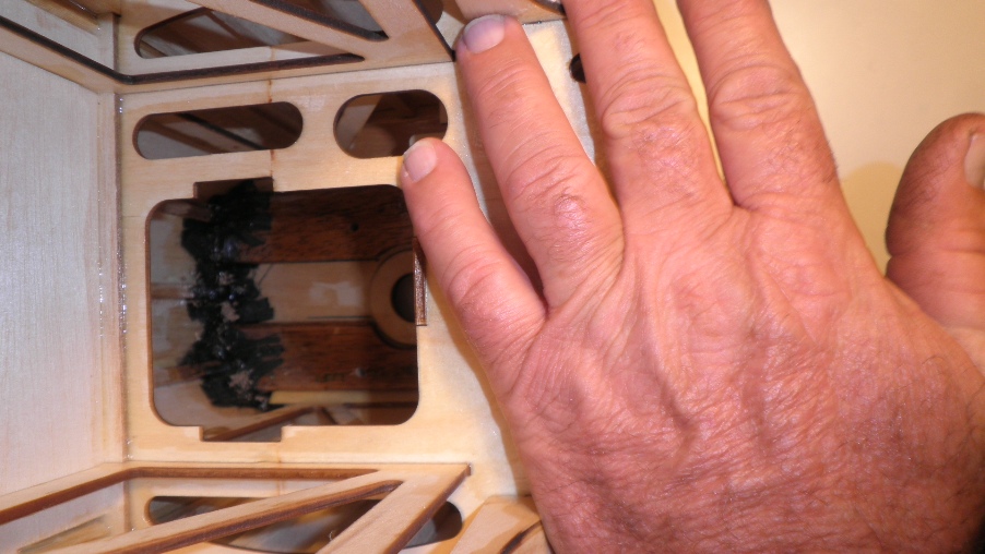

#1789

G'day Folks,
I finished a rather difficult stage of my Stearman tonight. I'd read of a few methods on here on how to reinforce a firewall & racked my brain about how ya can do any of 'em, what with the tight space & lack of visibility. I've got a fairly big hand (see pics) & tentatively tried to put it through the frame that holds the fuel tank. No way I thought. If I could get it in there I probably wouldn't get it out without breaking something. I'd already decided the plan would include two vertical pieces of hardwood on the inside firewall so I started cutting them to shape & hoped some ideas about how to fit them would germinate in the meantime. I think I was sanding some globs of glue off the stock firewall reinforcement using a long thin piece of ply as a sanding block when I realised my whole hand had gone inside! Oh no! But to my relief I found, if I twisted my hand & mouth in exactly the right way I could not only get it out, but put it back in with relative ease. Next problem was not being able to see anything if my hand was in there. I cut the handle of a 1/2" craft paintbrush in half & screwed it back together at 90' so I had a brush with a bend in it. I put a small rectangular cosmetic mirror against the firewall & standing the fuse on it's nose, I practiced painting epoxy in reverse perspective with this brush. My hand was outside the space & I could see what was going on. It wasn't pretty to watch by any means but I convinced myself I could do it for real. I painted epoxy on the difficult bits first, then unscrewed the brush handle to give me a straight short handled brush to do the bits I could see without the mirror. So I got the two peices glued in ok & while they were still curing I made a thinned batch of epoxy & wetted a dozen or so strips of carbon fibre tape on the upper firewall joint. This was the only place I could manouver the brush with enough dexterity to do a half decent job. After all this touch cured I made a couple of batches of thinned 5 minute epoxy & tipped them in stages around the rest of the firewall joint, holding the fuse at a 45' nose down attitude & rolling it axially until the resin cured in a nice fillet. I also put a fillet along the inside landing gear mounting plate & applied a few strips to the outside of the gear mount. Now I think I can get back to the instruction book again & start mounting the tail feathers.I've posted a few pics. I wanted to make sure the firewall was strong because i'm using a DLE 30.
Mick

#1790
My Feedback: (19)
I ran into the same problem, and I remember thinking the same things as you.
I ended up drilling a 1/2" hole between the two dowel rod holes, so I could see from the outside while I had my hand inside. I also removed the long shelf with the holes in it, and built a light framework to it for the batteries on top, and the receiver underneath (or vice-versa, can't remember exactly). Once I had all of them secured to it, I put it back in and glued it down again. It helped to keep the weight forward for the balance. I installed the Syssa 30CC on mine, which I think is pretty close in weight to the DLE 30. The problem I had with preparing the firewall for my Syssa was that my mount points were far enough apart that I ended up having fight the tri-stocks out by the sides, where the outside of your added bracing butts up against it. I didn't have to fight with the plywood the tri-stock was glued to. The tri-stock was enough trouble by itself! Finally got it. THAT was a job. I'd definitely do something more like what you've done here if I was building another S-Stearman. Looking at your photos here, I see it's MUCH easier to bring the firewall up higher on the tri-stock than to carve the tri-stock down to the firewall. I used some tri-stock epoxied in on the outside edges, but the carbon fiber looks quick and easy. I'm building an RC Guys Super Decathlon right now, and looking at some rather tight corners that I want to reinforce. Maybe the Carbon Fiber is the way to go. Thanks for the idea!
Looks like you're doing a nice job, Mick.
Keep those photos coming!
~ Jim ~[8D]
~ Jim ~[8D]

Just finished the same type of modifications to the Super Stearman, I removed the balsa block ahead of the wing saddle and behind the firewall. These are only lightly glued in from the factory so they are easy to remove. That allows room for a 1/4 ply doubler to be epoxied behind the firewall. I beveled the sides so it would fit tight between the tri stock on the back side of the firewall. By opening up the bottom of the fuse, I could also add some additional tri stock to the formers to strengthen them as well. Finally I found that the formers need to be relieved to ease the access to the Syssa stand off bolts. Likewise I removed the stock fuel tank mount but added a block and blind nut to the back end so the tank can be removed. I learned these tricks after having the front end of the fuselage apart to make repairs, and when I put the Syssa on the fuselage the first time.
#1794
My Feedback: (19)
Yes, I just finished rebuilding three ports I cut into the nose of the fuse so I could reinstall and retighten my standoff screws for mine too. After I finished, I found out that Todd has a Triangle metal firewall brace for the back side of the firewall. Ordered one right away, since I'm building a plane that will have a Syssa in it.
I absolutely LOVE the Super Stearman - unless I have my hand inside the nose! Then, not so much. @#$%^&*$%^
I don't look forward to changing out the batteries in a few years. I know, I know, I'm a whiner.
Lol
I'd still like to get some feedback on my carbon-fiber / three-tube-stack idea for bracing the inside firewall corners. It sounds almost too easy to me.
~ Jim ~

#1795
Joined: Jun 2012
Posts: 22
From: Kinchela, AUSTRALIA
Jim H - Man that would have made things easy! I wish I had the experience to cut stuff out like that but this is only my second model (yeah dumb I know).
Jim S - Dunno how you'd go getting a 90' angle using round tubes. 3 would give you 60' on each corner. Trouble is the epoxy would not actually penetrate the fibres of already cured tubes so ya really only got an epoxied joint with some stiff filler in it. I dunno whether you'd be improving the tensional strength of the joint much over an ordinary epoxy fillet. Just my two cents (which by the way is 2.0868

#1796
My Feedback: (19)
2.0868?[X(]
I'll bet you actually went and looked that up! Goodonya.
The idea with the tubes was to stack them against a 90-degree corner and tack them. It might take 4, or 5. Then again, I can just use tri-stock. But I think the epoxy would penetrate roughed-up carbon fiber tubes as well as it would penetrate the pieces of hardwood tri-stock. And of course, I'd fill the tubes with epoxy as well. {{{Shudder}}} - I was just thinking about the epoxy mess I'd make doing that. Yikes. Okay. Tri-stock it will be. lol
