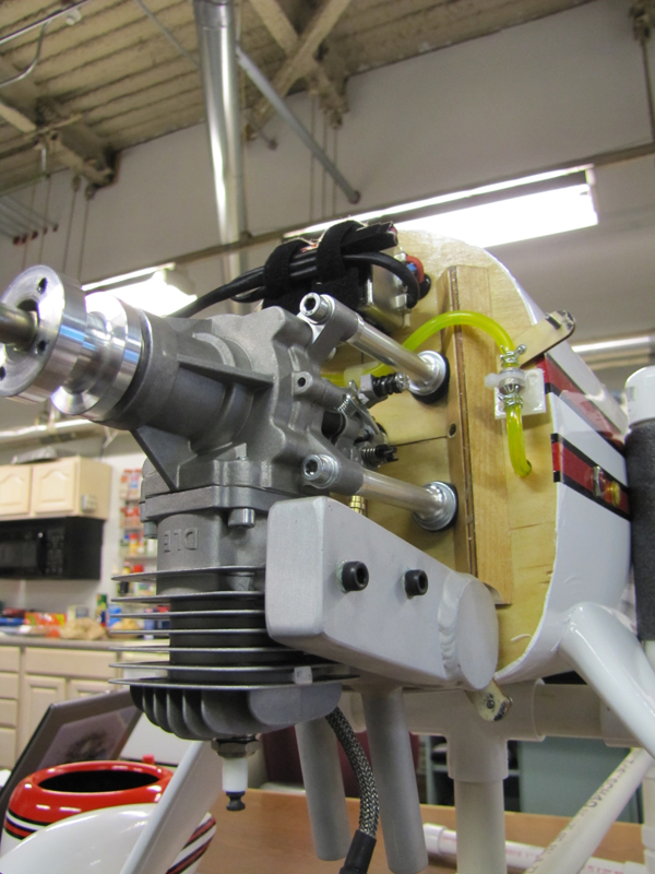

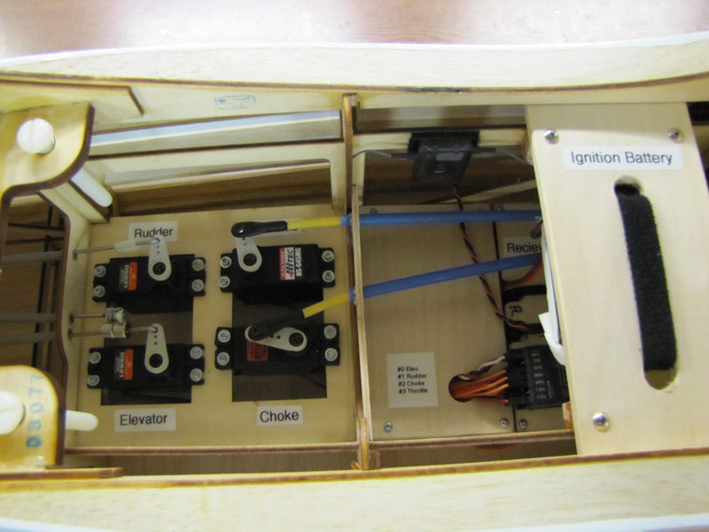

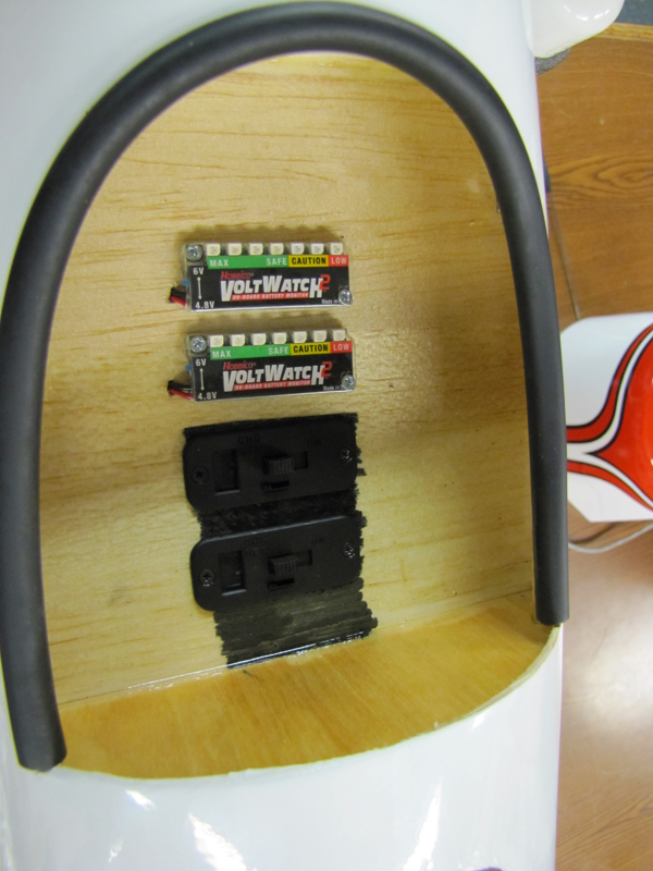

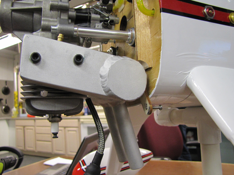

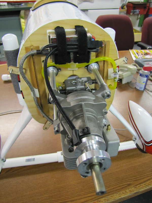

As promised here are a bunch of pictures for you guys. I still have a few little loose ends to tie up but it's 99% ready to go. I'm running an 18X8 for break-in but will likely switch this once it's ready to go. I need to finish up the Williams Brothers dummy radial as well as finish the cockpits. Any questions ask away.

Just trying to be helpful - from the pictures it looks like you may still have the orginal spark plug from DLE installed there have been many posts that indicate that the delivered plug is a source of many problems and to replace is with a genuine NGK CM6. I am really interested in your flight reports as I have the plane and the same engine waiting to get started. I am trying to decide between my DLE 30 or the Zenoah G26ei. Please keep us posted.

Bobby,
The plane flies fine, don't worry. Just don't try to glide it in. Keep enough power on that it slowly descends and cut power after your wheels touch down. It has a lot of drag but flies great as long as you keep some air blowing over the control surfaces.
Mine is aout 5 years old.

Bobby,
The DLE 30 likes to swing a BIG prop. I have mine on a T-Craft and use a 20x6 Master Airscrew wood. Good performance and that big prop looks great.
Enjoy!

ORIGINAL: Howard
Bobby,
Howard
Howard I appreciate the heads up. I haven't had any issues with the stock plug but will take your advice and pick up 2 extras. Thanks.

ORIGINAL: Lifer
Bobby,
Enjoy!
Life,
I have the 18X8 on it right now. How do you think the 20X6 would do with the SS? The T-Craft wouldn't happen to be the new H9 version would it? That plane is VERY high on my list and would love to run another DLE 30 in it but refuse to cut the cowl to have it fit. A little trimming on the bottom wouldn't bother me but not the sides.
Thanks for the help!

Bobby, That is about the finest installation (of everything) I have ever seen on the Stearman. Very nice and neat!

Also, just a heads up, put one of the wings on the plane the next time you run the engine. All of that vibration is weakening the tail. The wing will help take some of the vibration.
Nice running little motor!

ORIGINAL: lear31A
Thanks bud! Did just as you said and the tail shaking was next to nothing! Yeah it's amazing how much power these things make. I have about 1/2 gallon through it and just MINOR needle tweaking. I am very happy the way it pulls with the 18X8 on it.

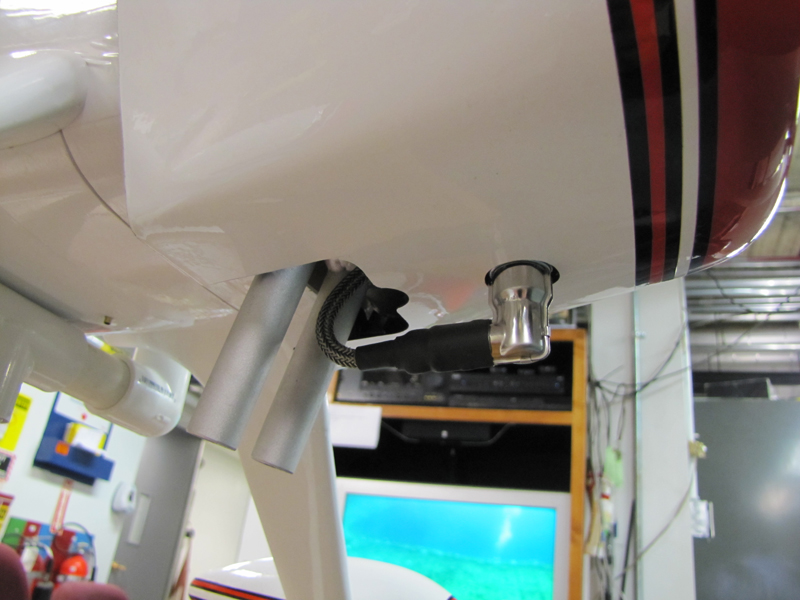

Bobby
Is that the JTec Muffler in the pic's ?

ORIGINAL: CAT POwer
Bobby
Yes it is. And worth every penny I paid for it. I tried 5 different mufflers and none fit within the cowl until I picked up the JTEC. I drilled and tapped it for the smoke nozzle from a Bisson and threw it in our media blasting booth at work as it had a few scratched in the smooth finish. Nobody see's it inside the cowl but they bothered me Lol. I LOVE the way this thing sounds at idle. Nice deep burble. AT WOT it is certainly not quite but has an awesome sound to it. Only other thing I plan on doing is angle cutting the tips to match the fuselage.
