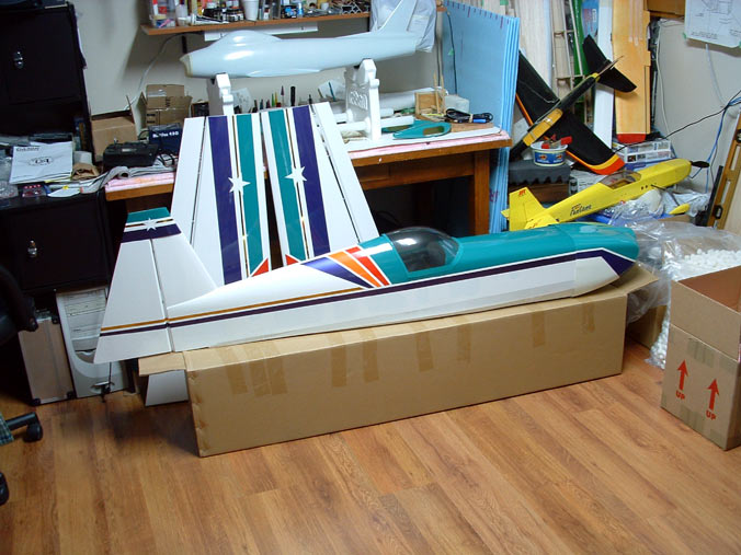

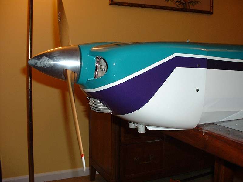

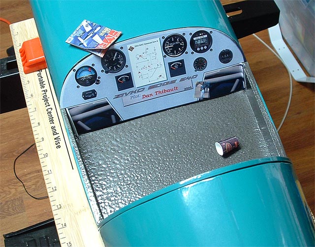

I finally started working on my plane. Thanks to suggestions from Maudib and Desertpig I set the front of my BME 50 to 7 3/8 in front of the firewall.
Here's a pic of the engine and the cowl.

Perfect! That will go a LONG way in helpign you balance it.

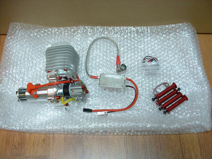

Got mine out of the box and here are the weigh-in results. Digital scale.
Fuse - 46.7 oz
L. Stab - 2.7 oz.......R. Stab - 2.6 oz
L. Elev - 2.5 oz........R. Elelv - 2.5 oz
L. Wing - 24.1 oz.....R.Wing - 25.1 oz
L. Spat - 1.3 oz........R.Spat - 1.2 oz
Fin - 2.2 oz..............Rudder - 4 oz
Hatch - 6.45 oz........Cowl - 9.1 oz
Canopy - 2.3 oz.......Firewall - 6.8 oz
Wing Tube - 8 oz.......Stab Tune - 1.6 oz
Landing Gear - 9 oz...Tailwheel Assy - 1.6 oz
Axles - 1.2 oz............Main wheels - 1.3 oz
Tail wheel - 1.2 oz.....Hardware - 1.8 oz
Total = 165.2 oz = 10 lbs 5.2 oz
I plan on upgrading the tubes, and L/G to CF. New engine mounts will be ordered too to get it as far forward as I can.

Here are a couple pics of plane and power plant:

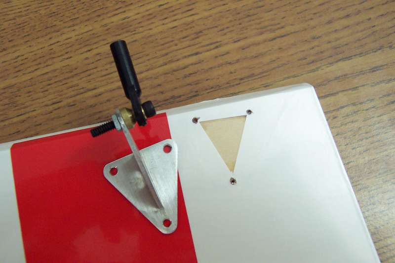

I picked up a couple of the Chip Hyde control horns. They look fine Using Maudib's suggestion to bolt through the rudder. I'm a little hesitant to use them for the elevator using just the 2-56 wood screws. If you mount them, the front two screws don't look like they will bit into the ply plate. Anyone use them for the elevators?

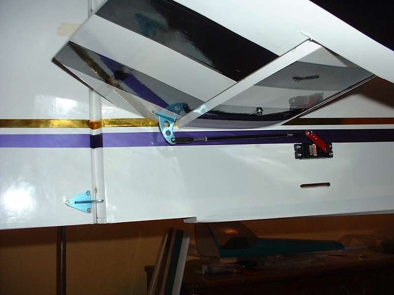

As I mentioned I used Chips suggestion of installing the horns on my Double Vision elevators... I have HAMMERED the elevators HARD for fast speed walls and elevators that should have snapped them plumb off...
They've not even hinted of loosening.
You could longer screws on the Edge because the surface is so thick... wick some CA down into the hole to hardeh the area...
OR I suppose a person could trace the base of the horn on some CF or 1/16 hard ply (paint it) and put it on top of the surface, bolting through it completely...
I trust them as is... but you need to be comfortable and not go by my experience.... I've not heard anyone complain of a failure though...
Here is a pic of an install of the horn on a CAP-X...

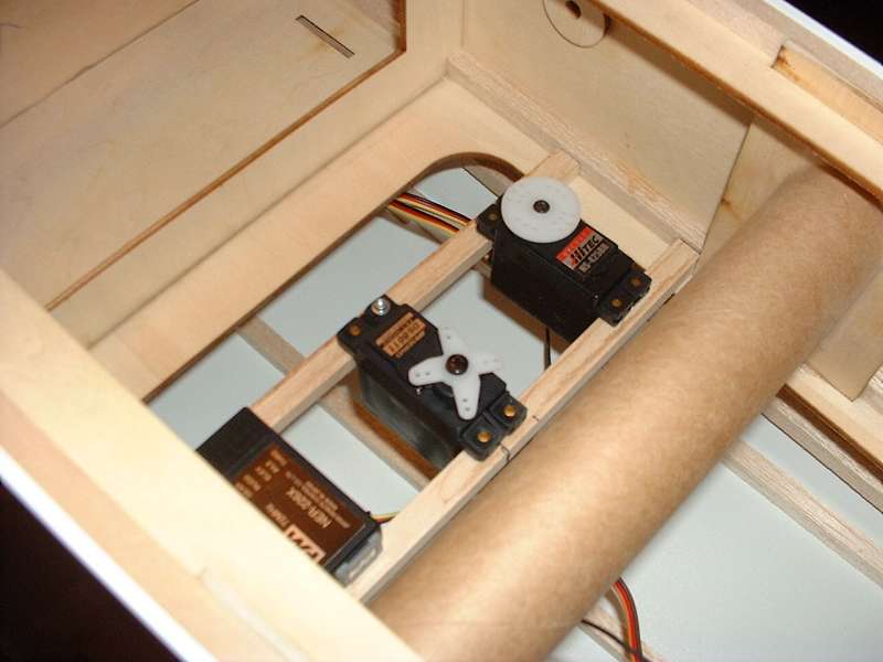

I have a question on the throttle servo...would it be safe to move it closer to the engine? I'm using a BME 50 with CH Ignition. I've read that with CH Ignition, it would be better to have better separation between the radio components and the ignition. It seems with DA, you can mount some of your components closer.

As far as locating the equipment.. mine is all jammed into the nose on the firewall. The ignition, Li-Ion battery and regulator are all touching, the RX battery pack is 4" away from the Ign "bundle" and the throttle servo is mounted on the firewall 1" from the carb. The RX (PCMR770 JR) is less than 6" from all the rest of the stuff.
I went to a smaller (18oz) tank, elevated the tank and moved the Pull-Pull setup under it, so now that pull pull is as far forward as it can get and the tank is still nearly on CG.
I have perfect range and no issues in flight. My CG is 5.00 inches and my weight is 16 pounds 5 oz WET.

For all you DA50 users out there, want to post up a pic of your cowl cutout setup for the head and muffler? I want an idea of how much I am going to have to carve away.
Progress - I carved off the backplate of the canopy area so I can have better access to the area under the turtledeck. Now I can reach in there and tidy up the cables and stuff. Firewall is ready to epoxy in, and brace, and block, and pin, etc. Used a laser level on a tripod to shoot the centreline. Very accurate. Ordered new standoffs, as I want this bad boy to be as far forward as possible. My new standoffs are 3 5/8" long, to get the 7" to the front of the cowl plus the 1/8" gap for spinner.

Ummmm... to get MORE throw you need SHORTER horns and longer servos arms.
Still, you don't want to get too short on your horns or you risk flutter due to improper geometry.
The CHP Horn is 21 mm (a little over 13/16") from the base of the horn to the center of the ball bearing... I wouldn't want to go any lower than that...
In the pic it also looks like the servo isn't fully deflected...
ORIGINAL: desertpig
I was looking at the CH horns... they don't look like enough for 3D throws... they are nice though. I used the Rocket city horns and mine are nearly 1.5 tall to get the right displacement (45%).. I don't see the hyde horns getting anywhere close to that. The pics above show about 30% max..
