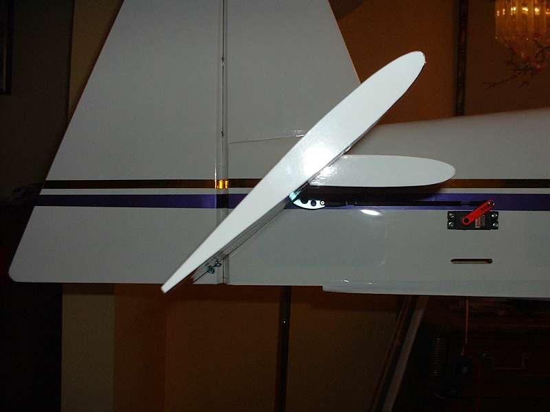

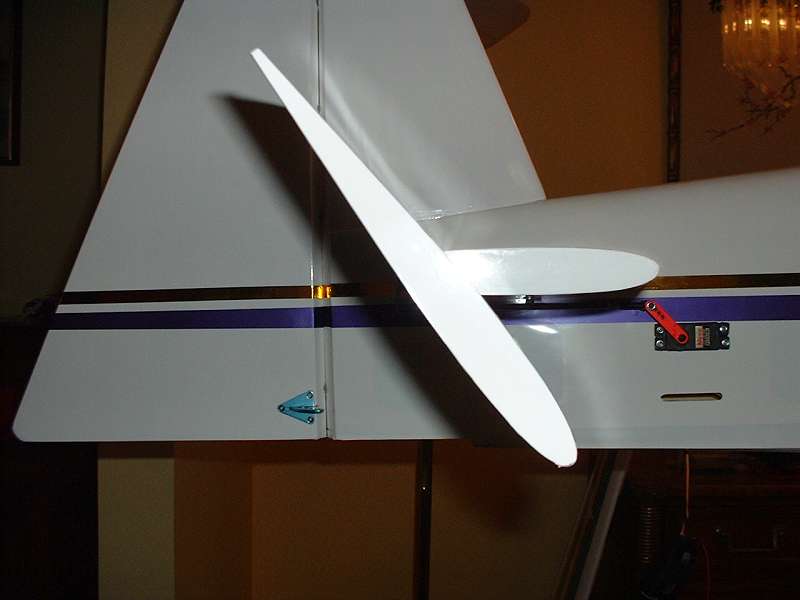

Good pics! I am glad to see the CH horns worked out... I was little worried...
Maudib - No doubt about needing shorter arms for longer throws.. for whatever reason the rocket city horns definitely need to be taller to achieve the 45* displacement... It would be easy for me to convert to the CH horns and I still might. That should be worth another ounce in the tail... !

#456
ORIGINAL: Maudib
That's much better... looks about 45 degrees to me...
ed42d-RCU - what are the lengths on the servo horns and who makes them?
Spar
