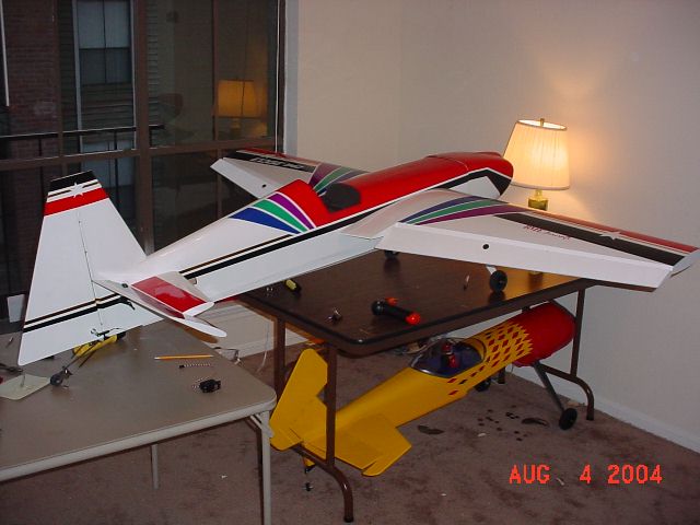

my edge right now

Go Dago Go!

I bought my rudder servo "HS-945" and the engine mount today. I have most of the servos temp mounted, but not completly, getting closer!!!!!

Too cool man... keep her going...
I'm sure you will, but just double check each "temp" mounted servo... sometimes we can get excited and ahead of ourselves and forget we only put 2 screws in the servos or no horn screw, forgot locktite on the gear bolts or wheel collar set screws, etc...
These are the little gremlins that come and cut your first day short or worse...
I am SOOOOO buried with work right now that I just can't get to mine for a while... so have at it and let's get some video huh guys?

Im gonna have my plane looked over at the field by the guys. Make sure its all there. Im gonan replace the servo mounting screws with hex heads. so on. Now the horn screws will be a must to check. I lost a 1/4 t-craft after the horn fell off. The plane made a turn to the left, never came back.
