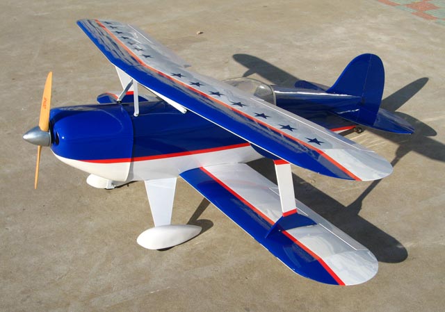

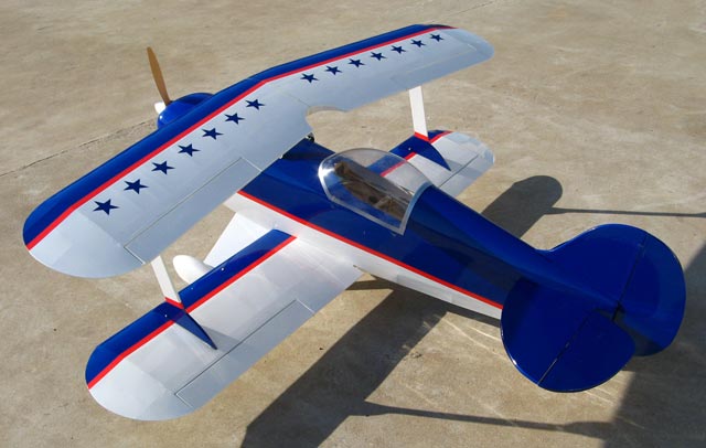

Does anyone have one of these? 50cc class Pitts biplane with 71" wingspan. Similar to the CERMARK Pitts in blue but in a bigger scale. They are being offered on Ebay but the seller will not give out any info or references of individuals that have or have flown one. Nice looking plane but........death comes in many disguises!

$199.99 plus $59.00 shipping. Too cheap to be a superior quality ARF but I have not put together an ARF yet that was to my liking. Would be a good starting point...maybe. I am fortunate enough to have started in the hobby when building from scratch or a kit was the norm. Very helpful when buying a piece of crap ARF!!! I have built a lot of ARF "kits" too!!! LMAO! I'm looking at a WILDHARE Sukhoi SU-26 but it is pricey and you have to buy the hardware package separately and that does not include the spinner or the $70.00 shipping. I built a GP 1/3rd Pitts that wasn't too bad. A Goldberg 77" YAK 54 that was /is holding up nicely. Most seem to have weak firewalls although I must say that both these ARFs are sufficient in the undercarriage area. Hardware on both was acceptable but I hate buying an ARF with that junk Chinese hardware. The spinner included with the GP 1/3rd Pitts was junk. Never use a cast aluminum spinner. Take it out and throw it in the trash. Had a Dave Patrick Ultimate that was absolutely great and flew the same. Cermark Pitts is also a great ARF and super flyer with a Saito 150/180. The Cermark Pitts required a little attention with the aileron hinges but no biggie. I have yet to buy an ARF that I used the supplied engine mount. I always end up replacing the supplied wheels with H9 wheels. I really like the H9 wheels. I also think most ARF's are supplied with one size too small wheel axles. One last thing....where do these ARF manufacturers come up with such cheap tailwheel assemblies? Speedy
