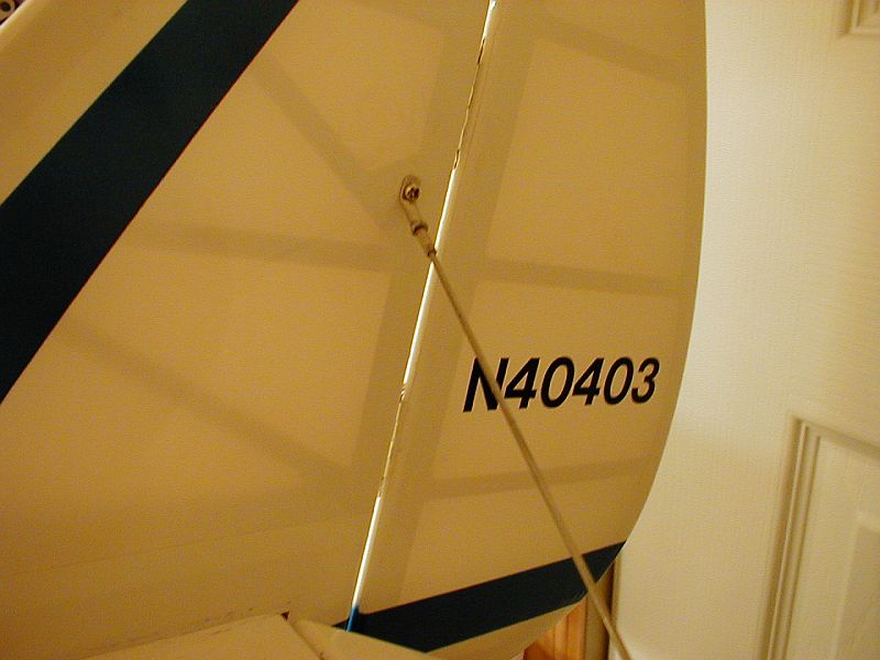

Hi Fossil,
Sorry this thread got hostile but I hope it's back on track now. You say it's the yellow one? Thought at first you may have the ARC version but maybe someone stripped the covering. It's been a while since I've gone through this entire thread but I do believe there are some using the 120 FS or similar, I know there are some Saitos being used. The Ryobi is a little stronger than a G26 (26cc on the G26 I think) and will fly it with power to spare. The weight may be an issue, you're Ryobi is what....maybe 60 oz? the G26 is 53oz. I have the O.S. 160 FT in mine at 39 oz. The tail wire bracing is an easy fix. I used music wire and some tubing from the LHS or you can buy what the manual shows at the LHS. Same for the control horns...easy fix. If you need decals get some graphics cut to your liking. If you decide to sell you will have a bunch of guys jumping at the chance to have it.
These are only my opinions as I'm no expert by any means, you will probably get others.
Bud

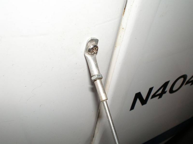

Thanks Bud the pics help for the wires, what are the end pieces that the screws go through made from? & did you just solder them to the wires? You wouldn't happen to have a close up of the ends would you? There were people talking about putting the 120s in but I don't remember anyone saying how it flew. The ryobi if I use it will have an electronic ignition so should be a little lighter.
Frank give me a couple of days to be sure I don't want to keep it and I'll post some pics of it and let you know how much I want. If I sell it I'll make an add here on RCU and give you first shot at it.

i think it is a clevise soldered or threaded the pin end is cut off then a small bolt goes thru one with a hole on each side, many engines will work the two you have are great but from the tread bud started, the engine that had the most talk was the os 1.6 twin 4c, sound and scale power, thanks frank

Fossil, the end pieces are aluminum tube from the K&S tubing rack at the LHS. Flatten one end and drill for screw. The wire is threaded one end 4-40 and the screw was just for effect as per pictures of the real one. Slid a short piece of alum tube over and up to screw and all is held in place with ca except where it is bolted. Do you have any pictures you can post here and is it the full wing cub or clipped? BTW anyone needing a new cowl I just found out Fiberglass master has one for the DPM cub for $38.00.
Bud

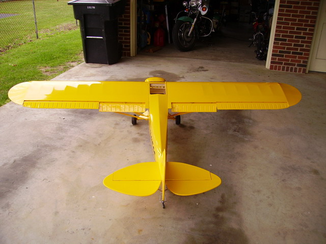

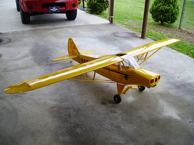

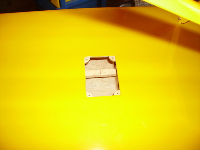

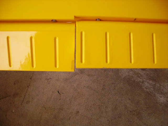

Well first I must have been on drugs when I picked the cub up because I swear there were no decals on this plane. Well when I went to the garage to get it out to take pics I think the decal fairy had came and put them on because in has the numbers & lightning bolt stripe on the fuse & cub emblem on the tail. Not sure if thats all there is suppose to be though. Here are the pics of it, its in excellant shape. I could only find two small imperfections on the whole plane, its on the right flap which are in pics 8 & 9. Pic 4 show the parts that I got with the cub, there is some wire for the tail braces but no tabs to mount it with. The pull pull for the rudder is installed as is the pushrod for the elevator, but other than what is in the parts pic some of the pushrods for the flaps & ailerons are missing as is one of the control horns (I'm sure I have some though). Pic 11 shows there is one cover for the flap servo bay missing (should be easy to make). Pic 10 shows a remote glow plug that is installed. The cowl is untouched and the front windshield has not been installed yet, the other windows have been installed. The landing gear is perfect and works, and the wing tube, bolts, and wing support braces are installed and are complete except the four bolts to mount the struts to the fuse. It won't take but a little bit and it can be flying, I think I want to sell it until I get it out and this plane is awesome, so I'm still unsure if I want to sell it. Its the weekend time to go fly so here are the pics I took today. If I can't get them all in this post I make another with the rest.
fossil[img][/img][img][/img]
