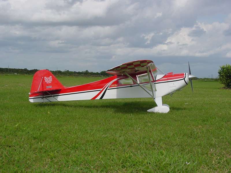

I have been using the Saito 182T for 6 months in a Hanger 9 Taylor Craft. Started with an on board glow but after it stopped working I removed It. I set up the two carbs as per the instructions and I have not had to adjust the mixtures since I took the engine off the test stand.
I only use Cool Power 30% Heli. fuel ( as recommended by the Saito Web site) and I have never had a problem - no dead sticks, GREAT power,
and I get 18 to 20 min. flights on a 24oz tank.
Hope to get my new Cub tomorrow - I will buy a second Saito 182T.[img][/img]

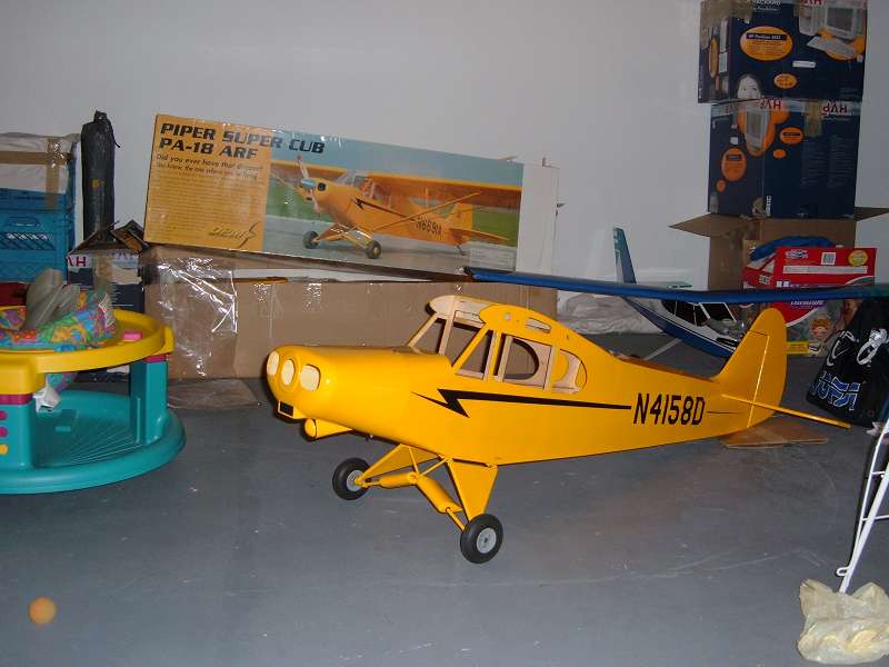

Well my dad made mention that there was no pics of his so here they are! (builder jim's Cub)
These are from when he first received it, to it's near completion!

Jon, in your picture looking down on your installation...what's that unit next to your battery? Is it part of the on board glow and if so was that part of the extra $45.00 package or did it come with the $35.00 price for the unit?

Posts: 271
From: westerville, OH
Default RE: Dave Patrick super cub
Bud, next to the battery pack is jr`s 700 reciever, in front of the battery pack is the edr control box which has been mounted to the right side and forward just partly under the dash, the edr battery pack is now to the left side just under the dash, not shown in photo`s. no camera to retake, did this arrangment for balance! Wow, the bud perfect floats, really make your cub look good! nice job!
