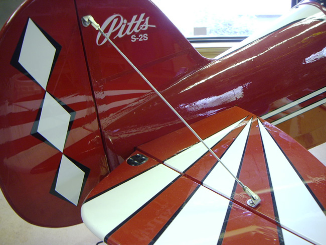

Here's a couple shots of the tail wires. 2-56 music wire, soldered on both ends. They're silver soldered. With a torch and high temperature solder. Regular soldering probably would have been okay, but since I went to all this trouble...

Dave did you solder them while they were in-place? Is there any way to adjust them? I was thinking of doing the same thing except have one of the clevis' threaded. I agree about the flying wires, I don't know why people are so hung up on them having to be functional. If any body wants functional flying wires, they will need to change the screws for bolts and use 2-56 or 4-40 wires for them to be strong enough. I've seen a couple of these over powered, one with a fuji 64 and the other a 3W-75, the wings have not yet come apart.

Navy, The rod is threaded on one end. I precut the wire for the clevis's. Soldered on the non-threaded end (off the model) and then adjusted the threaded end so all 4 rods were tight on the brackets. Removed 'em, and soldered the threads solid. There's no adjustment necessary if they're already tight on the brackets. I guess I soldered the threaded end so there wouldn't be that stupid little nut at the end of the clevis to cinch it solid. As long as the brackets don't move (swivel), the wires stay tight. That's an easy preflight item to check. I even masked off the clevis's and sprayed the rods with aluminum Lusterkote.

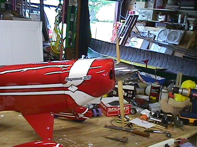

Dave G, You say that the flying wires are junk in the kit. I have used them and they look pretty good to me. And while we are on the subject of 'functional-V-non functional, even though many have successfully flown without them, why not add the added support they offer just in case. Now I have argued this point with a few others and they think it makes no difference. One day someones Pitts is going to be headed for the ground fast and low and they are going to have to dump the elevator to save it. It could make the difference between snapping the wings or not. Many of you say that the wires have nothing to do with keeping the wings on but rest assured, they have everything to do with keeping them from breaking! Support! Right Navy? At least until you exceed the capasity they provide.

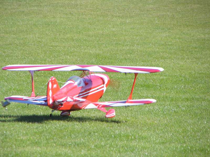

Got a couple of flights in this morning, and for the 1st time got some in-flight shots with the smoke system running. Sorry the images are grainy. But the good news (other than a non eventful deadstick was the new Rexlace flying wires held up just fine for these flights. I was a little concerned the plastic would stretch, but it didn't at all.
These shots were from my wife's Nikon and a telephoto lens. I got a primer course on using it since she wouldn't come and be my photographer. Hopefully, a video is still in the works. For now, these'll do!

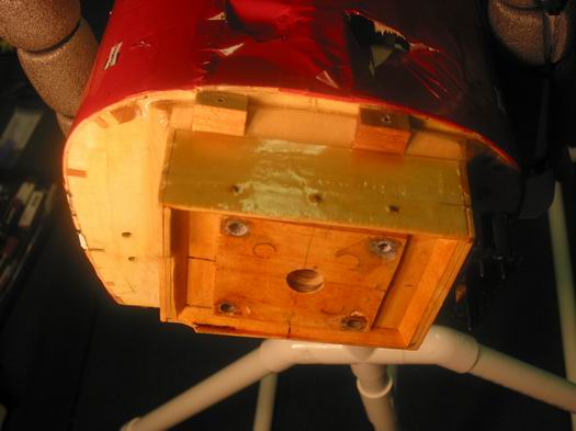

NavyE6FE - you and I have exchanged post in the past. I remember those early post about the firewall coming lose. This was a real problem with the early production runs, especially with gas engines. I found the balsa on mine had gaps you could see a light through right out of the box. I added tristock inside the fuse to the firewall and inside and outside of the mounting box as well. I then pinned the firewall and then added fiberglass cloth with finish epoxy for resin. You may recall that I lost Pitts-1 in a horrific crash which also cost me the Fuji-50. The firewall held though. Maybe the engine might have survived had I not made the firewall so strong, but I didn't want the engine coming lose from vibration.
I did the same on Pitts-II and all is holding tight and snug.
Pictures below show the firewall with the added tristock I did on both Pitts-1 and Pitts-II. Pitts-I went in, but the firewall held. Replaced the engine with a DA-50 on Pitts-II.

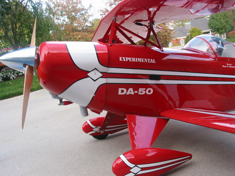

rfw, mine is the updated version, not sure what version the other one at the field is. From the looks of it, they use some type of hot glue, not sure though. They definitely don't build them like I would with epoxy and reinforcement in critical areas. Haven't seen much of the CE II having this problem.
What muffler do you have on the DA? A friend in the club has a DA50, but has problems keeping the bolts tight and I think on his the bolt heads are recessed in the muffler.

NavyE6FE -I originally thought the stock muffler would work, thus the notch in the firewall, but then learned the barrel made contact with the cowling, which I didn't like after I cut the cowling as well. I then ordered a Slimline Pitts muffler from DA for about 136.00. I also ordered a new cowling, arrgh! No problems with the socket head screws coming lose and the muffler fits nicely in the cowling without cutting. You will notice a fuel valve in one of the photos. I have since replaced this with a fuel dot after the fuel valve developed an air leak. Many had warned me about this, but I had never had any problems with them until I tried one on a Gas engine. I suspect that vibration wears out the seal causing the leak. I had a DS as a result of this which is when I learned how challenging a DS can be on this bird at 17+ lbs.
Both Pitt-I and Pitts-II are the updated models, but I still reinforced the firewall in using a gas engine. I have found that regardless of which gas engine you use, vibration really causes things to loosen up. The screws holding the Cabbane and interplane struts need to be checked frequently to be safe.

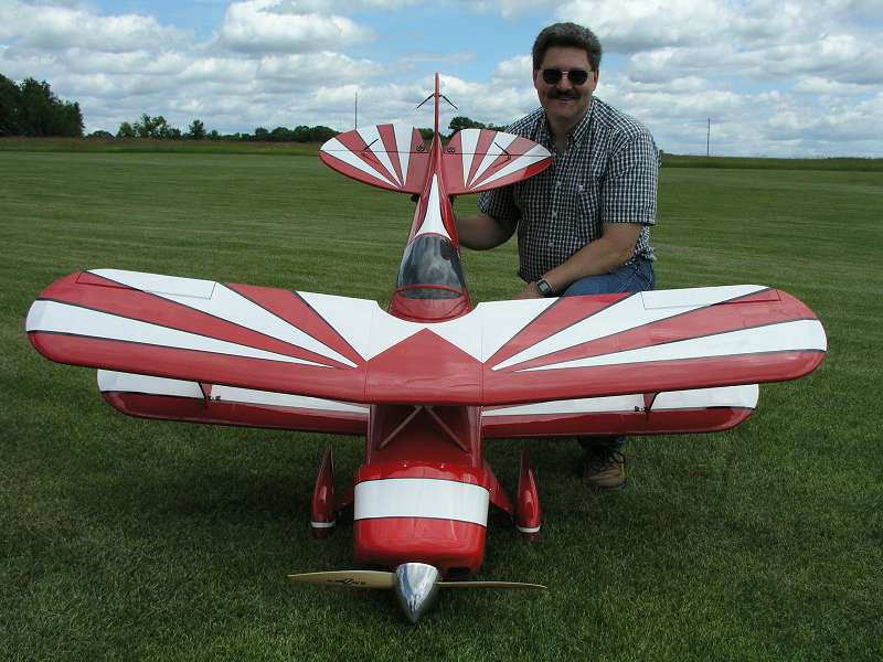

Goldwing, nice looking pitts. Looks like mine! hehe! Tell your friend that is flying it to flair it on landing and it will put an end to the bouncy bouncy. It has not bad habbits or wing dropping. bird.
Here are a few pix of nine. It has an OS 320 with a 24X10-6.
