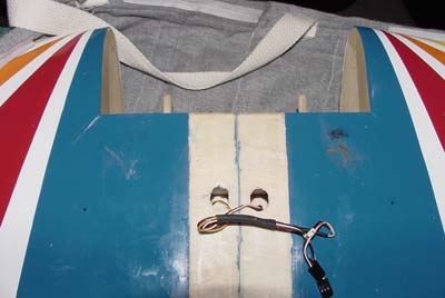

One month ago I lost a GP Giles 202 to a wing failure. The right wing panel snapped off and totaled the airplane. Today when I was flying my second GP 202 the wing had developed cracks at the same location the first plane shed it's wing. I have emailed GP about this problem and await their response. In the meantime I encourage pilots with this airplane to inspect the bottom of the wing for cracks and if you find them to email the problem to [email protected]
I had two wings fail as well although both only cracked the sheeting just behind and outboard of the plywood wing dowel plate. The first failed doing a snap at about half throttle. The second time I have no idea when it actually cracked as I had flown a full gallon in one afternoon and noticed the crack when I was disassembling for the day. I don't think it has happened very often since many people have many flights without incedent. Just our bad luck or our stlye of flying. I changed all the throws on mine to make it more patternlike versus 3D so that it lasts longer. I still enjoy flying it without the 3D capabilities.

I had the same thing happen to mine twice. Four flights into its life the wing cracked on both sides top and bottom at the LE. Called GP and they had me chop the wing up and send it back.
I got a new wing and 10-12 flights later same thing but also getting cracks in the fuse at wing mounting area.
Called again and they had me chop up the entire plane and return it. The plane flew fine with either wing just had to make thrust angle adjustments. When speaking to them on the phone they never questioned how I'd flown it and was always courteous.

I never took any pics of mine. In the photo you posted it appears there is a small wrinkle in the covering at the corner where the dowel plate meets the rest of the leading edge. Just behind that area on the bottom of the wing is where both of mine cracked the sheeting. If that is a wrinkle on your wing I'd be checking it for flexure as well. it shouldn't be flexing there enough to generate that wrinkle.

That small wrinkle is torn and the balsa under it is cracked. I put some CA on it (20th flight) to keep it from spreading and it hasn't gone any farther. If you look at the fit where the wing and fuselage meet, that area is soft. I was thinking of glassing the wing out to the fuselage but didn't know if that was the right thing to do. I guess I should ask Ann Marie.

Please don't be offended. This is precisely why we are discussing this. I could just ignore it, and say that I didn't see it (you would be surprised at how many pilots I know take that approach). Better to talk about it and understand the problem - so if you are flying with cracked wings please let me know LOL.
The cracks appear to be surface cracks and while alarming, from the outside it appears to be just superficial. The only way to test is to destructively test it, or open the wing. I'm sure someone has the answer on this board.

On my first giles I too thought that the cracks were just superficial, however I did eventually loose a wing at the point where the crack was. My first giles I flew well over a year every weekend, the second I have about 15 flights on the airplane and now have cracks. I love the airplane but confidence is definitly shaken.

Are all you guys with wing failures and cracks using gas engines? Are you using a soft mount for the engine? If you are using a gas engine without a soft mount that could be most of your problem. The fibration from the engine just may be to much for this plane. After all the recomended engine is a OS 1.60. Just my thought.

Nope no gas, OS 160 solid mount on mine.

Are the fuse cracks on the exterior of the plane ?
In that location there is a joint of the exterior sheeting
I can actually feel the joint under the monokote.
from the way the fuse is constructed it does not appear that
the exterior sheeting add too much to the structure of the fuse
maybe more for the cosmetic curve.
It seems that the inner ply structure is the main fuse.

My second plane was on glow and I check the wing and it has cracks as well. The seem to be cause by the wide saddle. It has not cause any issues after 80 flights on one and 67 flights on the other.
