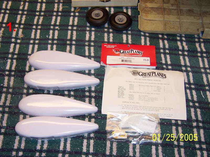

Speaking of wheelpants, here are the long overdue pics of the pants. These are the new set that I just picked up today. Here is a brief build report on them. I have 7 pics so I will go by the numbers:
1. Just ripped them out of the packaging. They are Great Planes Med size pants.

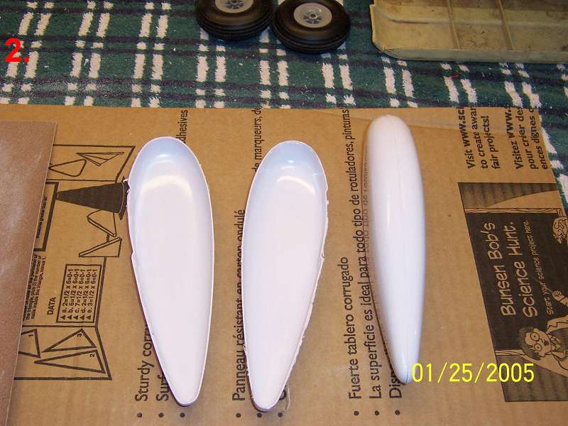

2. The pant on the left is untouched from the packaging. The pant on the right has already had the seam edges sanded flat and matched to one another. Once they were matched as close as possible they were CA'ed together.

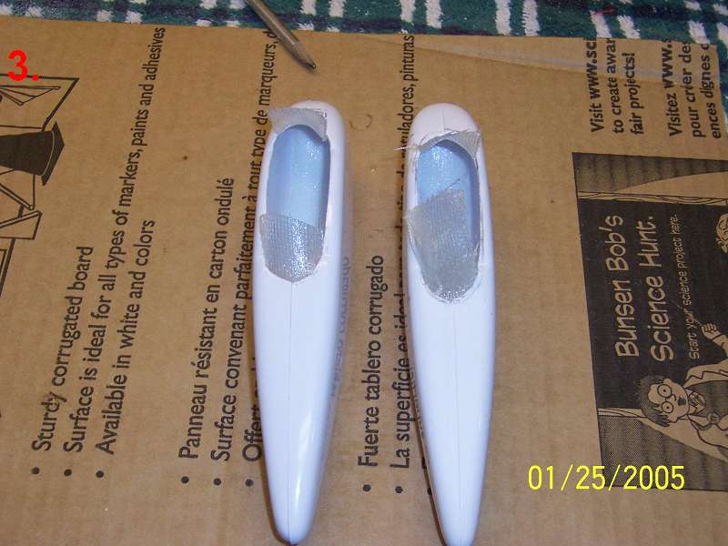

3. Used 1" med. guage 'glass and sealed the seam from the inside with them. Prior to 'glassing them, I sanded the seam on the outside as smooth as possible. Any low spots were filled in with putty for plastic models. Once the putty dried I sanded it down smooth. I repeated this process until all the low spots were completely gone and no seam could be felt. Very time consuming, but the end result speaks for itself.

]). On the three flights that I have had so far, I had no problems with taxiing, takeoffs, or landings. I too fly off a grass field and it is by no means the smoothest. That is why I was very hesitant to put the stock pants on this beautiful plane. My field shredded 2 set of 'glass pants on my H9 Aresti 40 in less than 10 flights. Now granted that plane needs to land hotter than most, but I am usually a smooth lander with no bounce. Hopefully these pants will hold up.Speaking of wheelpants, here are the long overdue pics of the pants. These are the new set that I just picked up today. Here is a brief build report on them. I have 7 pics so I will go by the numbers:

*The rest of the pics are on the next post....

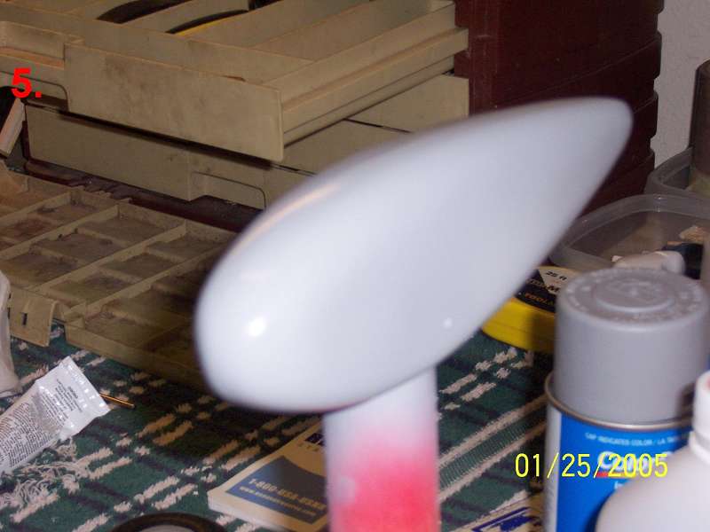

5. Sprayed first coat of base color. I actually used 2 different colors before I clear coated it. The first coat is Krylon Fusion paint from WalMart. It is designed for applications with plastic. I applied 2 light coats of this.
6 & 7. The final color is Model Masters - Guard Red. I sprayed to even coats. Then I followed it up with WalMart brand clear coat.
The only thing left is to mount them. I already have the holes drilled out. I will be mounting them tomorrow when I get off work and will post some pics of the completed setup. Since these are my very first pants that I had to assemble and paint, I am extremely pleased by the end results. I showed my mother and she said that if she had not seen my working on them, she would have thought that they were factory pieces. That comment put a huge smile on my face.
One more note. The reason for the 2 colors. I had used the Model Masters on the first set of pants that I screwed up. I was unsure of its ability to withstand fuel so I picked up the Krylon today. Although the Krylon would have been a base/clear coat in one, I was unhappy with the color. It was a bit too dark. Therefore I went over the Krylon with the Model Masters. I think the 2 paints combined gave me a near perfect match. You guys have to see them in person, the pics just don't do them justice. When I placed them next to the plane, I was pleasantly surprised at how well they matched.
Until tomorrow....

Nathan, thanks for the compliment.
To fiberglass them, I cut my 1" 'glass tape to the length I needed. One piece goes from the front of the wheel opening up against the front curve and up the top all the way to the back. The other piece goes from the back of the wheel opening, down the bottom seam to the back. I thinned some 15 minute epoxy, layed the four pieces on a piece of wax paper, and then poured the epoxy over a long and short piece for the first pant and then did the other pieces for the second pant. After I poured the epoxy over the 'glass strips, I put on a pair of vinyl gloves and rubbed the epoxy in good. Then I carefully layed them inside and used a scrap piece of control rod, with a 1/2" 90 degree bend on one end, and used it to smooth the 'glass against the seam.
To mount them, I epoxied plywood plates on the inside of each side of the pant, centered over the axel holes I drilled on each side. I am using GP 2" long, 5-32 wheel axels cut down to the width of the pants. Tomorrow I will be cutting out a slot just big enough to fit the hex part of the wheel axels, that's what one of the plywood plates are for - to hold the hex part of the axle. The other end of the axel will go through the plywood on the other side and will be flush with the outside of the wheelpant. Then I will be installing 2-56 blind nuts in the plywood on the axle side. I have 2 holes already drilled in my langing gear for two 2-56 hex bolts that will go into the blind nuts to prevent the pants from rotating. It sounds a little complicated, but I will take pics of it and you will see what I am trying to explain. It is pretty easy to do and really locks the pants on. Also by having the axle go all the way through both sides of the wheelpant, it helps keep the pants locked on and makes them more sturdy. I will be using wheel collars to hold the wheels on the axle.
Hope you can understand what I am trying to say. I think you will understand it once you see the pics.

Luke and Ray,
Thanks for the compliments. It makes it worth the effort when others appreciate your hard work.
I am going to try to get the pants mounted tonight. It all depends on how my kids behave. If I am able to mount them, of course you know that I will post pics.
Other the 2 long white stripes, are there any other decals that go on the pants too? I can't see any others that go on them.
Later.
Later.
