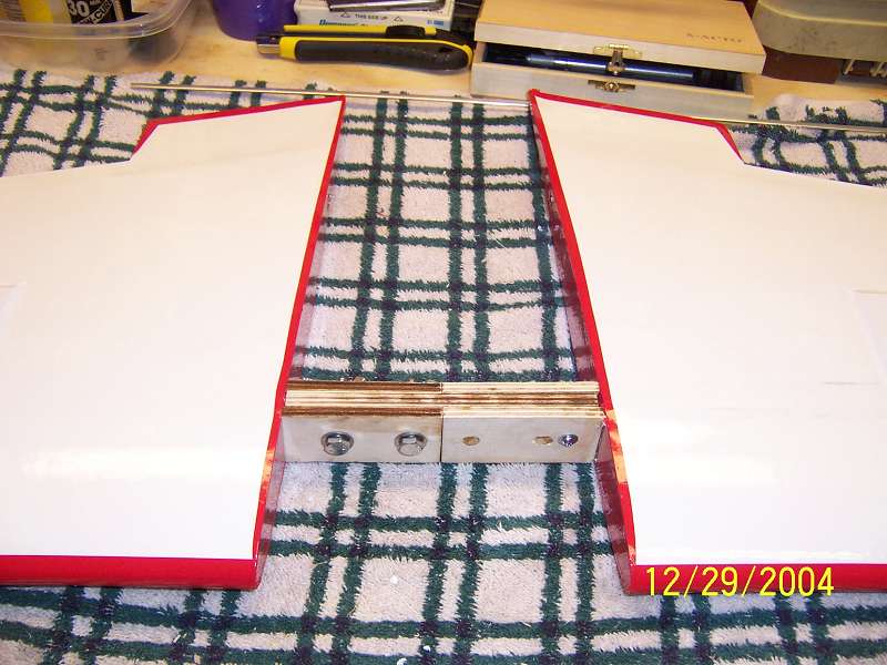

Well Guys,
My VF Edge FINALLY arrived after more than 6 weeks. I anxiously opened the BIG box and started inspecting the plane. Man are these planes put together well. The covering is flawless, not one wrinkle anywhere. Most of the hardware appears to be excellant quality. But as usual I will be replacing some of it. I have a Sig tail wheel assembly (the leaf spring type) that will replace the factory unit. I will be using Dubro Heavy Duty adjustable control horns. I also bought a Slimline Excel Fueler for refueling. I am have a Dubro Heavy Duty pull pull setup that I may install. I have to look at the factory setup first. I am also tossing those tiny foam main wheels and I will be using some H9 Prolites 2.75" that I had laying around.
On a slightly down side, a corner on the belly pan was broken off and there is a small hole in one of the elevator halves. I shot Chuck, at VF, an e-mail and a couple pics of the parts. Hopefully they can get me out some new ones by next week so that I can go flying by next weekend.
Here are some pics of the Edge as it came out of the box. I will update this thread as I build the Edge over the next week or so. I like to take my time and I try to ensure that everything is 100% before I put any of my planes up. Besides I still have to finsh breaking in that monster Saito 120 GK.

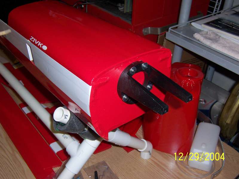

Rcfury, I installed the engine mount inverted. I am using a big ***** Saito 120 and it would look ridiculous with 1/3 of the motor sticking out the side. Instead of using two of the existing screw holes and redrilling the other two, I wanted my motor to sit perfectly level. I ended up using only one of the existing screw holes and popped out the other three blind nuts and redrilled them. I really took my time here. I used two levels, one on the engine mount and the other on the fuselage where the belly pan goes (the plane was inverted on my stand to make it more stable). It took a little bit longer, but the end result speaks for itself. I also added two washers under the engine mount on the top left and bottm left to add the recommended 2 degrees of right thrust.
After further inspection, I am going to go ahead and stick with the factory pushrods for the rudder. If I am unhappy with the performance of the rudder after I fly it, then I will convert it to pull pull.
aaron, I agree the fuselage is virtually a work of art. I almost feel guilty cutting and drilling into it [sm=spinnyeyes.gif]. Actually, other than some of the plastic pieces (mainly the cheesy wheel pants [:-]), the entire plane is absolutely gorgeous.
Here are a few more pics. Until tomorrow, happy flying.

I also drilled the mounting holes in the engine mount for the Saito 120. But I don't have any screws (DOH !!). That's ok. I have to return something to the LHS anyway, so I guess I'll be picking up a few extra things as well as the screws.
I'll post more pics tomorrow (errrrr later today). Good luck with the build and if you have any questions please ask. Thanks.

The motor is installed and all the fuel lines are ran. I bought and assembled a Dubro 16 oz. tank. The extra 2 ounces is necessary for the thirsty Saito 120. There is one very important aspect I forgot on the motor. I neglected to put on the muffler before I mounted the engine (DOH !!) . Now I have to take the Saito off in order to put the muffler on. I tried several times to get it on, but was unsuccessful.
The remote glow driver and fuel filler are also installed. As you can see in the pics, I made my own mounts and epoxied the mounts to the firewall. I really like the remote glow driver I picked up. I can't remember the name brand, but it is actually made for helicopters. The part that connects to the glow plug looks very similar to the boot on spark plug wires. At first I wasn't getting any fire from the remote. I looked at again and realized that it had only one wire. I had to install a ground wire from the remote plug to the engine (no problem).

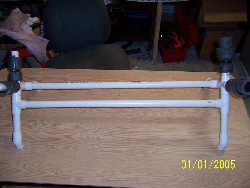

I like your PVC plane stand, and I'm going to put one together (looking for things to do until plane comes). I want to build the stand so it fits the Edge 540 just right for working on it. How far apart should the leg assemblies be? How high should it be so the the plane will sit on it sideways and inverted with the vertical and horizontal fins installed.

I can't remember the measurements of my stand, but I will get them to you this evening. The stand works great. Due to it's configuration, I can work on the plane in any orientation needed (i.e. either side, inverted, or right side up). I can also change the top and bottom tubes for larger planes if needed.

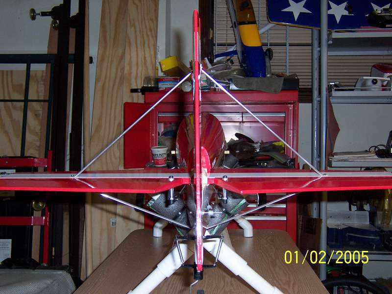

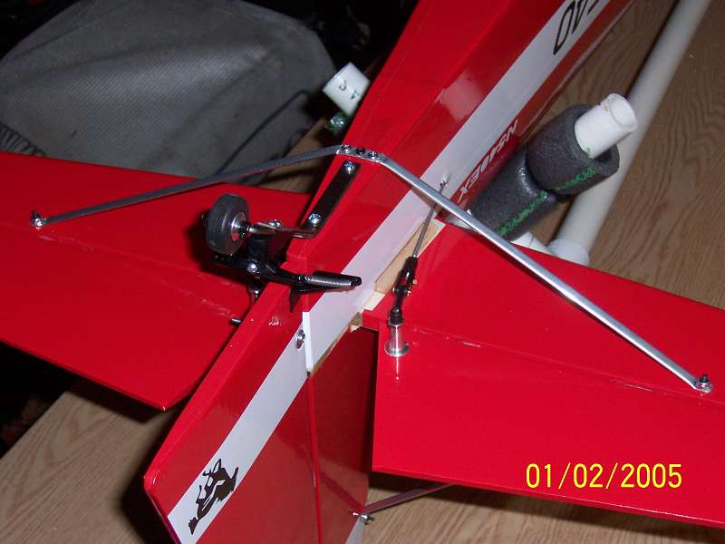

Gary, have you made plans for adding tail wires? I would highly recommend them both top and bottom, especially with the extra horses of the 120 pulling it around. I attached pics of my setup. Yours is looking good so far. Like what you did with the wing bottom. And, remote glow is a sweet touch. I am still working on my homemade onboard glow driver setup.
rcjon, I also second the Saito 100 over the OS61 for this model. The 120 makes it a rocket, the 100 will be a sweet match for it, but the OS61 will be a weak powerplant for a model with this weight. This Edge finishes around 8.5-9lbs.

I will be installing the tail braces sometime this weekend. I like using the airfoil-shaped hollow aluminum tubing. Thay are very light weight, yet strong enough to handle the stresses we subject our planes to. I put some on my H9 Aresti after the left h-stab decided to depart from the fuselage during it's 3rd flight. Luckily the right side stayed intact and was able to maintain control and land safely. The only damage was the wheel pants that cracked after the fast landing.
I will try to complete the bottom of the right wing this evening. I plan on doing the h-stab and elevators too, but John at VF said not to apply iron on film over the red. I am awaiting an e-mail from him an the reasons. I may just cut the red off and cover it .

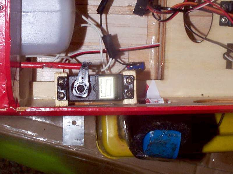

Where did you mount your throttle servo? Can you post a couple of pics of your throttle servo? I would like it to stay in the servo tray to help out with the balance.

>>I can't remember the measurements of my stand, but I will get them to you this evening. The stand works great. Due to it's configuration, I can work on the plane in any orientation needed (i.e. either side, inverted, or right side up). I can also change the top and bottom tubes for larger planes if needed.<<
Thanks. Have you looked for any rubber caps for the feet? PVC pipe is the ultimate construction material. If it had been available to the Egyptians, I think the pyramids would have looked quite differently.

Gary, here are the pics of my throttle servo placement and mounting setup. It consists of 2 blocks of 3/8" balsa mounted to the side wall and the servo mounted to the blocks. I came up with the same distance from the firewall to backplate as you have, 5.75".

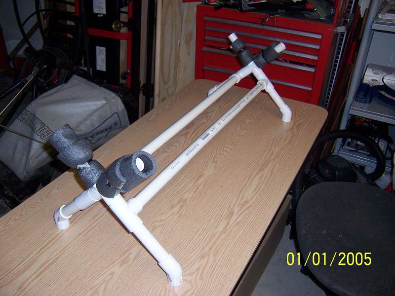

Jon, here are the measurements for my PVC stand. Of course you should change any of the dimensions to suit your needs. I used 3/4" PVC pipe for the entire stand. I like it's light weight and sturdiness. The 2 middle tubes are 30". The legs are 4.5". The cradle pieces are also 4.5", but you can make than any size you need to accomdate larger aircraft. I also used 4 - 45 degree elbows for the feet, 4 - T-fittings that connect the legs to the middle support tubes, 4 - x-shaped fittings that connect the lower portion to the cradle. Here are a couple of pics of the stand alone. Hope this helps.
Luke, thanks for the servo placement idea. That was one area that I was scratching my head wondering where to put it. Hopefully I will be able to get to the plane some. We are having a New Year's Day dinner later on and I know I won't be able to do anything to it then.
Until the next update....

Gary,
Thanks for the pics and measurements of the Gary Patented PVC Plane Stand. I just finished my prototype. Looks a lot like yours <g> except I added short vertical pipes on the bottom and found some rubber caps (1") that fit perfectly on the 3/4"ID PVC. I'm editing the newsletter for our club this year and I think I'll put this stand in as a tip and trick.

Alright guys,
Here's another update.
I installed the throttle, elevator, and rudder servos and the linkages for them as well. I opted to use Dubro Heavy Duty adjustable control horns insted of the factory horns for the elevator. The rudder uses the factory control horn as I didn't have another one of the Dubro units.
Because of the size of the Saito 120, the carburator control horn is extremely close to the firewall. To solve this, I used the factory control rod but used the z-bend end in the carburator arm. There is only about 3/8" clearance between the firewall and the control arm for the carburator and this necessitated the use of the z-bend on the carburator arm. The throttle servo was mounted just behind the front former and just below (or above, depending on if the plane is upright or inverted) the wing. The Saito 120's carburator arm position dictated the placement of the throttle servo. I would have much rather used the stock location, but the control rod would not be at the proper angle.
The tail braces are also completed. As stated in an earlier post, I used hollow airfoil-shaped aluminum tubing. I like the light weight, strength, and the looks that they provide. Check out the pics.
I will hopefully be able to finish the cowl tomorrow. The belly pan is all trimmed out and ready for installation. I will also be trimming the canopy tomorrow as well.
I am going to attempt to finish the checkerboard covering on the other wing/aileron and the h-stab/elevators by tomorrow evening.
Until next time, happy flying.
