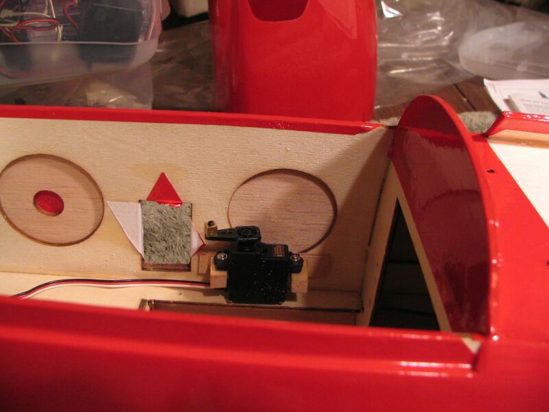

I went back to the fore mounted throttle servo. I just didn't like routing the control rod around the wing joiners.
Although the pic shows only 2 lines from the tank, I'll be going with a three line system and a fuel dot for filling. I'm thinking I will run the fill line toward the back and put the fuel dot in the side of the fuse instead of tring to work it through the cowl.

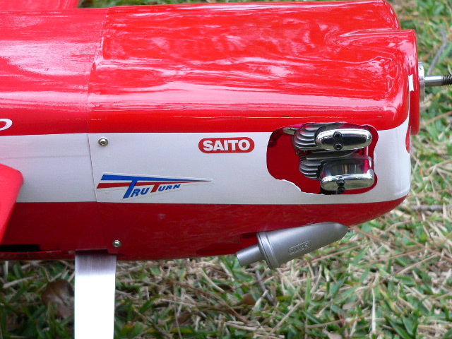

Brad-A, I used a Saito 100 and the stock muffler. I had to cut away a fairly big hole, but it does not look too bad. Not sure what your muffler/engine setup entails, but I assume you cannot cut the cowl to fit. It I had to do it over, I probably would have purchased a Brisson muffler for the Saito, because it would have required less cutting of the cowl I believe. I may get another cowl from VF and try it sometime in the future. Not much help, but that is what I am doing. Ron[8D]

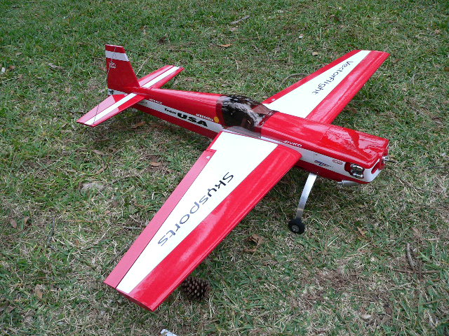

I am pretty much done with my Edge and I must say it is a nice looking plane. By leaving the carb in the original position on the Saito 100 I did not have to route my throttle linkage around the wing joiners. Using Gold n Rods I just passed it easily underneath. Nice fit for me anyway and no binding at all. All I have left to do is break in the engine. I have not installed any wheel pants yet, but I have a pair of H9 pants coming. I will install those when I get them and after I get used to flying the Edge. The landing gear struts or whatever you want to call them polished up nice by using some wet dry sandpaper. I will post pics soon of the finished bird and of my first flights. I can't wait. Ron

D*mn Ron, that looks good!

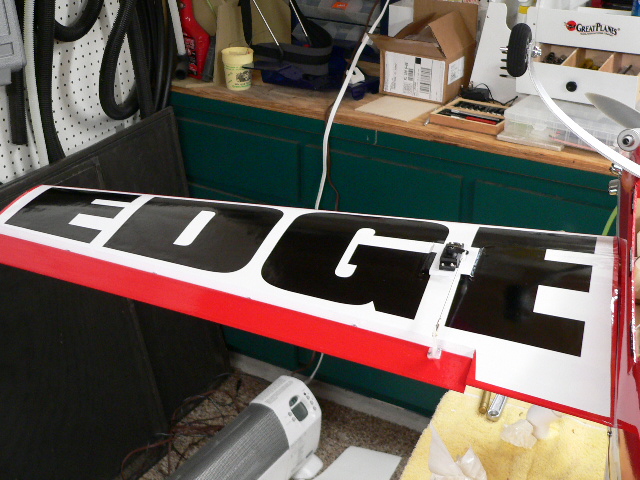

Did you cut out the E D G E lettering?
My problem with the throttle linkage wasn't getting it from the carb under the joiner, it was getting it from under the joiner to the servo (servo in tray). I didn't like the way it pulled down on the servo arm. I'm sure it will work fine, though.
You got away with way less cowl trimming than I did. Good job. Do you leave the muffler loose until the cowl is attached?
BTW, what's that green stuff on the ground that your plane is sitting on?

Hey, thanks. I cannot take much credit for the good looks. The plane does most of it. This cowl material is so flexible I can leave the muffler tight and still get the cowl on and off. I won't say it is not a bit of a trick to do it, but it can be done. If the muffler is loose it goes on real easy.
I had a local sign making shop cut the lettering and I applied it. These sign shops can do just about anything nowadays. Putting the lettering on is easy. I just wet the wings down with soapy water so the lettering can be moved around until I like the position and then I just use a lettering squeegy (spelling?) to get the water out from under the letters, let it dry for a few hours, and peel off the covering. I really like the looks. Can't take credit for the idea though. Got that earlier in this thread.
Sorry about the grass being green. One of the benefits of living in Florida. Gets very hot in the summer though.
Can't wait to see your finished bird. Ron[8D]

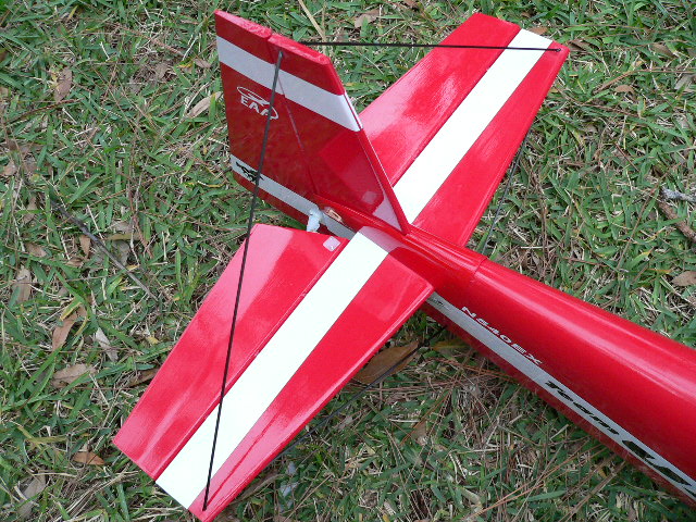

Ron, nice job on the lettering. I also like the carbon tubes for the tail braces.

RBGunner: So you did decide to go with the big letters on the underside of the wing also? I really like the way it looks. Did you see how i did my lettering. Granted the sign shop cut the letters out for me but, i put them on myself. Now that was a pain!!!

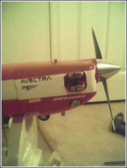

I like how you did your muffler. If you get a change could you post a close up picture of the muffler attached to the engine without the cowl. I would love to see how you set everything up. Thanks. Ron[8D]
Also could you see what i did to the cowl with the screen. It looks pretty cool.. I put a piece of papertowl behind it so you could see it. I bought some screen door patch from the LHS (local hardware store)
and painted it black to stand out a little. The screen itself is slightly bigger then the normal window screen so there is no restriction of air at all..Heres a picture of the exhaust. E-mail me if interested....
