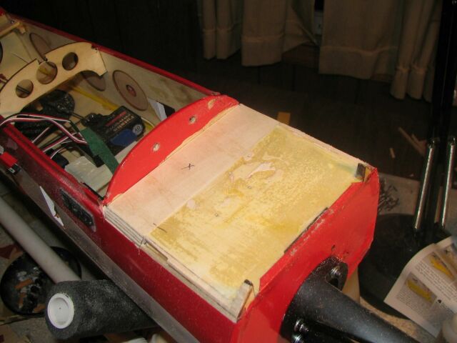

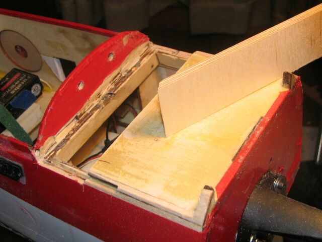

Here's more pictures on a landing gear rip-out repair. I sent damge pics to John at VF and he recommended replacing the portion of 1/4" ply that was damaged and overlaying it with another piece of 1/4" ply.
Rep00.jpg is after crash damage.
Rep01.jpg is after cutting out a section of 1/4" ply along with new piece of 1/4" ply ready to be installed. Note that the original "wings" of the balsa sheeting were removed.
Rep02.jpg shows the new piece of 1/4" ply plate epoxied in place.
Rep03.jpg shows the new overlay piece of 1/4" ply in place with the 1/4x20 tap. Being a belt and suspenders kind of guy, I added five 1/2" #2 screws. Epoxy was also liberally applied inside the fuse. Note that the plywood pieces were cut and sanded to roughly match the fuselage contour in place of the balsa sheeting "wings".
All that remains is puttying up some gaps on the edges and fuelproofing.

Great job Jon !! I think you and I should be able to survive a few hard landings now . Our LG platforms have both been improved in everyway now. And yes,,, I think mine is strong enough to hold up while the four nylon screws will sheer off.
Plus if you really want to soften the landings try the big fat wheels that John from(VF) suggested to me.

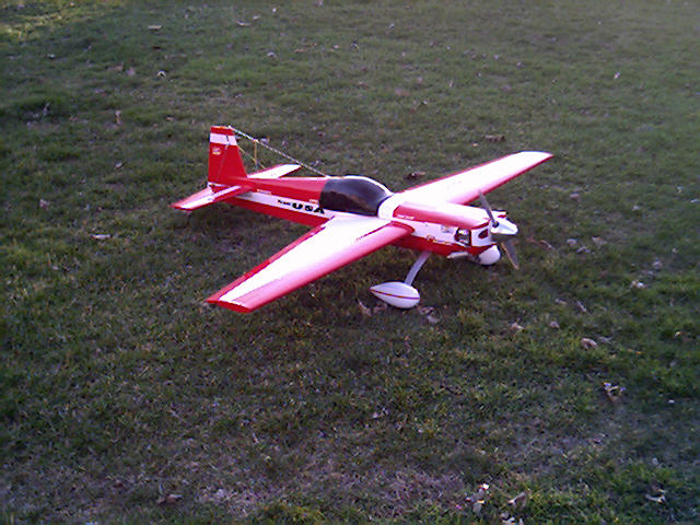

Fury,,, if your ever out this way,,, our field is located at a Lake/Recreation park. You could camp,,, fly all day. Fish in the lake . Play a round of 18 hole golf. Then launch your float plane from the shallows across from the flying field.
The invite is open to all.
YEs,,, the photo is touched up a bit. I had this World Models J3 Cub .25-.32 I built last summer and had no buddies there to photograph it for me. So I went out to the field and took the shot from the pits and PhotoShop'd the Cubby in.
But I thought it was a nice shot of the field and lake.

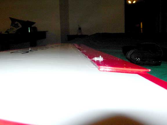

OK like i promised... Here is some pictures of the wing, as you can see the aileron is sitting a little bit ubove the TE of the wing. Flyable or it would require a good amount of aileron trim to fix.

I'll post a pic of the long yet shallow hinges that in my opinion work best on our 540s. Thier stronger by far doing them this way.
These pics were taken only minutes after I attached the ailerons. The glue residue you see in the pics went away after a few hours.
I used quite a bit and I guess it discolored the area until it cured and dried completely.
It's gotta be straight and true to obtain pure flight. Otherwise you'll always know in the back of your mind that it's off.
It may fly with trim. But I know you want it right. Use a new blade on your hobby knife bro. Remove the entire aileron and carefully slice around the CA'd hinge. Cut some new ca hinges about 2 1/2 inches long and 1 inch wide. This way your using new slots along with the old. The trailing edge only has 1/2 of wood anyway. Running hinges any deeper is not only useless,,, but your then getting CA into the foam wing. CA + Foam = Bad .
I flew mine all day today. Went and visted another club's field. Many of the guys came over and asked what I was flying and commented on how good it looked in a knife-edge and how it seemed to track so well. The lettering on the bottom wing halves are readable at far distances too. This surprised me. I thought I'd have a tough time telling top from bottom. But I haven't been unsure once yet. The "LOS EDGE" really sticks out. And the landings just keep making me look better everytime.
