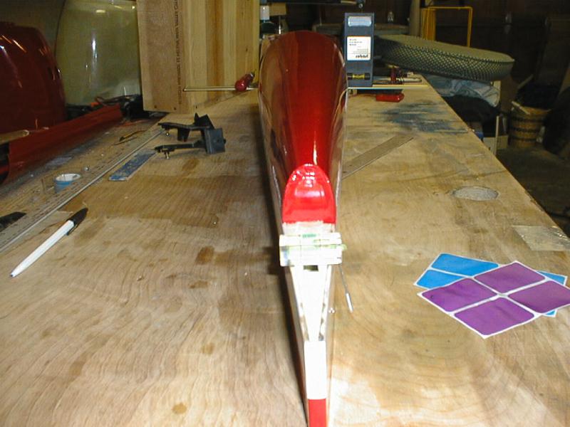

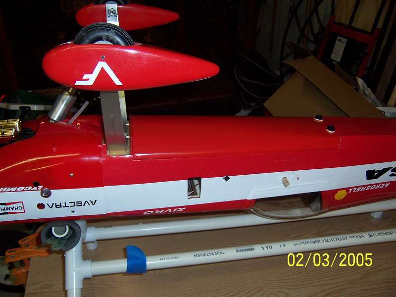

B.Matt: What side is lower? When viewed from the back my left side is lower. Maybe ours came out of the same jig?

Bank Yank from the back left side is lower, same as yours. Vector flight told me to shim it. At the tips of the stab there is a 7/8 difference between the two sides. Shimming something like that wich already a known week area doesn't seems right. Im am becoming disapointed with this plane first the gap between the wings and fuselage and now this.

I think someone had to much to drink the night before comming to work maybe
I would not give up just yet but i sure would not shim it either. You paid for a straight fuse as i did. Everyone else has a straight fuse why should we be any different and have to cobble ours together.
I would want a new fuse or send the whole thing back for a FULL refund.
After e-mailing chuck a few times they are sending me a new fuse and i have to send the old one back for inspection so they can try to determin the problim.
Did you include pics with your emails to them? it would help a bunch if you do.
So far for me VF has been upstanding and as long as the new fuse is right i would buy again cuz you really can't beat the quality. IMHO

I didn't include pics, I saw your's mines about the same. With the level it' also 1/4 of a bubble off.

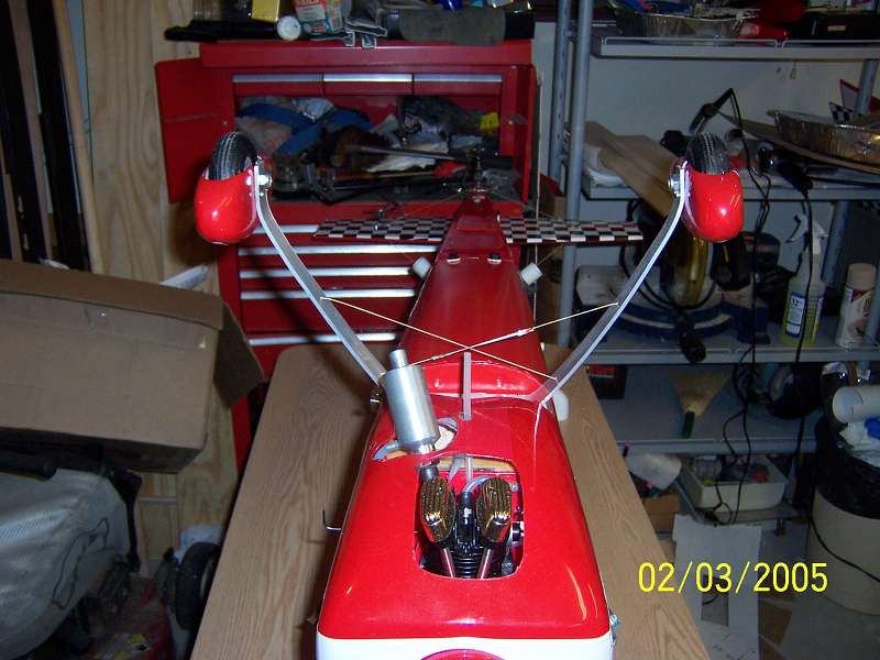

Mine was close to 3/4 bubble off with the wing joiner holes and cockpit level and there is a VERY visible slant on the very end of the fuse. Here are the best pics i can figure out how to take that show everthing.

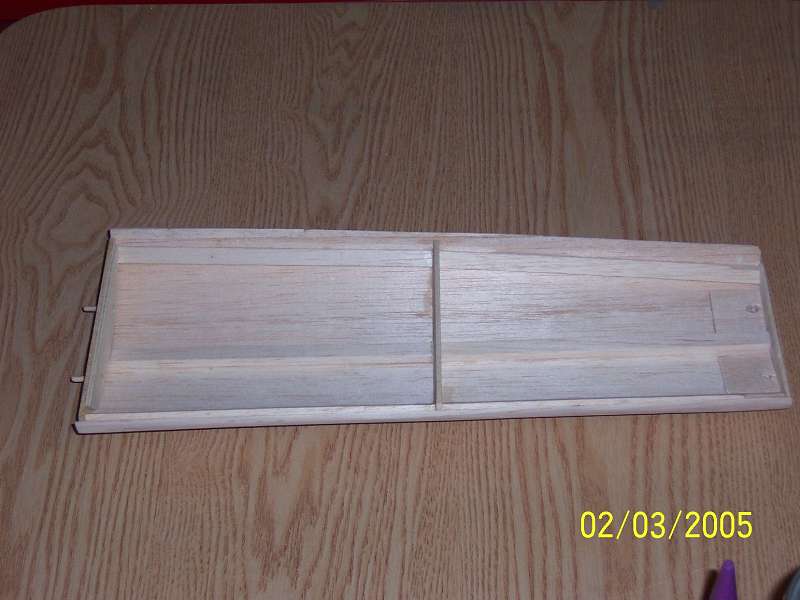

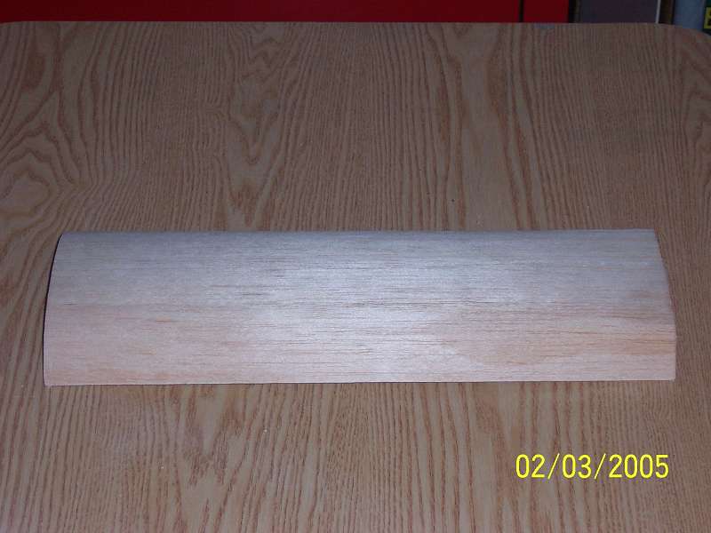

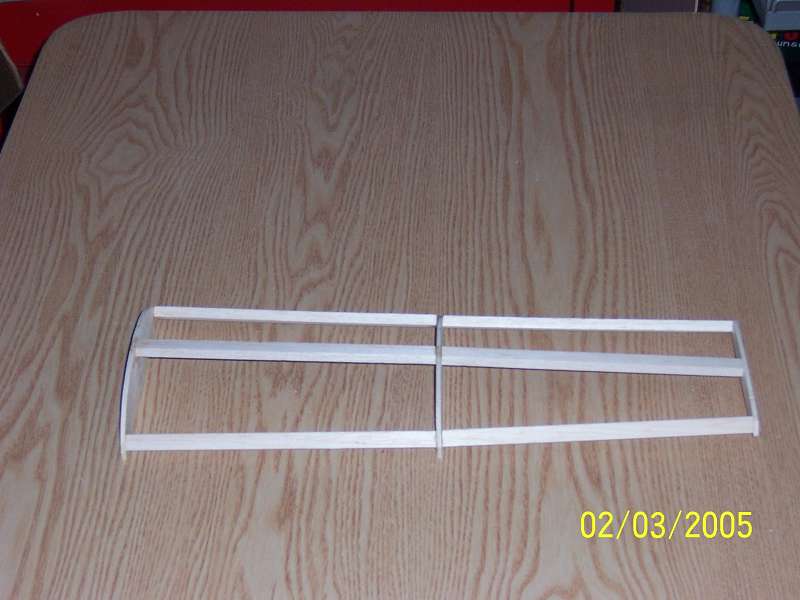

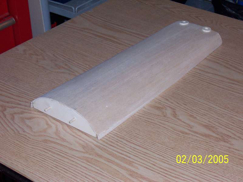

Here's an update on the belly pan:
1: Finished making the cross braces. I cut out the brace that was in the middle of the belly pan area. In this pic, I have the front half of the frame glued together.
2. Back half of the frame glued to the front half.
3. I used 3/32 balsa sheeting and sprayed it with a 1/3 ammonia to 2/3 water solution to soften it up. I then tacked the sheeting in place in a few areas with medium CA. Then I used more CA and some clamps to glue the rest of the sheeting to the frame. This pic was before I trimmed the sheeting down.
To mount my new pan, I installed 2 small dowel (1/8" I think) in the front cross brace. I doubled up on the light ply on the front brace so the dowels would have a bit more gluing area. I then cut a piece of 1/8" ply and epoxied it in place in the rearmost part of the bellypan area. I then drilled through the belly pan and the plywood plate for 1/4x20 nylon bolts. Then I tapped the plywood plate and added a plywood spacer over the holes in the belly pan so the nylon bolts won't dig into the balsa.
I am about 75% done. Right now I am waiting for the belly pan to dry out. I sprayed it down with more ammonia/water so the edges would fit snug against the fuselage side. Once it is dry, all I have to do is do a good final sanding and then cover it. I will post a few more pics later.

Calflyer, I used Ultracote Checkerboard on the bottome of my wings and my h-stab. Goto page 2 or 3 and you see what I did. Per Chuck at VF, you should actually use a Med to Med-High temp for the iron. The quicker that you get the iron on film to adhere, the better it is for the vinyl covering under it. Just be sure not to touch the vinyl with the bare iron.

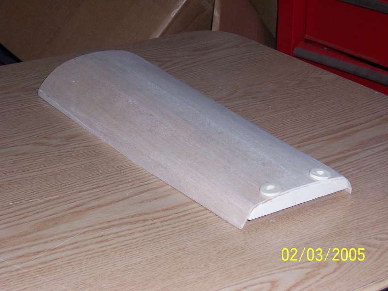

Well guys,
Here is the belly pan. It came out great. It took a little longer than I expected because I had to wait for the balsa to dry out after I sprayed it down.
Now I can have the belly pan installed in like 30 seconds. I also feel that it is much more sturdy than the factory one.
The pics are of the finished belly pan prior to covering.

Old 02-04-2005 | 01:41 AM
  #668
ez2bgman's Avatar
Joined: Apr 2004
Posts: 331
From: Harvey, LA
Default RE: Vectorflight Edge 540 build

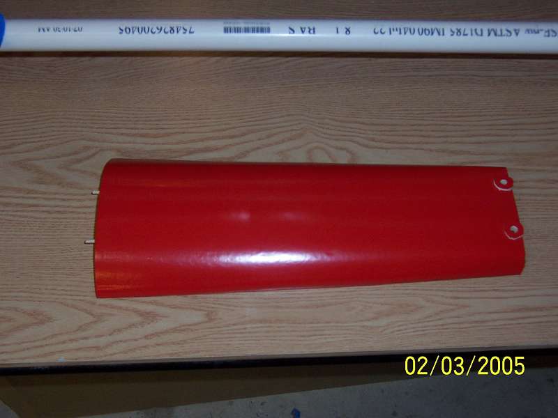

Here are the last of the pics. This is the completely finished belly pan. As you can see, there is absolutely no gap anywhere. I am extremely pleased with the results.
Talk to you guys later....
