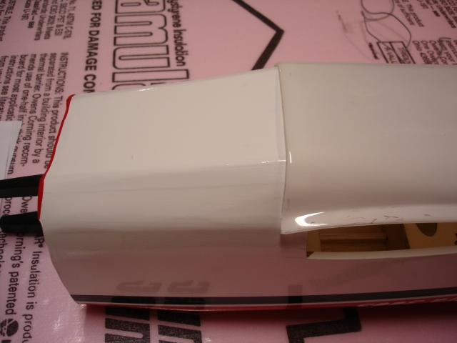

Ok, here's the next question......Getting ready to attach the stablizer and fin assembly and I noticed VF's instructions say to install "triangular crossection fillets" above and below the horizontal stablizer. I haven't found any supplied, so I assume I need to look thru my supply of balsa, or should they have been supplied?
Also, will the plastic tail fairing (once cut out) extend below the bottom of the stablizer to cover the fillet put there? If not, won't there be some raw wood showing that needs to be covered? I've seen some articles where a fairing has been entirely of balsa to replace the plastic, sanded smooth and then covered.....sounds like some work, but would be very sturdy....
Pics are worth a thousand words....I'll break out my digital and start taking some.....

Bshin,,, I just used some medium balsa tri-stick cut to size for the top and bottom . I removed the covering where the sticks were to be placed of course and epoxied. (30-min slow cure) I sanded just enough for smoothness. Use the extra covering material "supplied" to match the color and filled any bare spots with red "Monokote brand" fuel proof paint. I just kept dry fitting and trimming the tail fairing till it fit good.
After the fairing had cured "30-min epoxy" I used more of the supplied repair trim to make it look better. I have added more trim since these pics and covered all the seams around the fairing for looks and security.

We're going to try two different things. I'm going to have my buddy trim the plastic fairing VF supplied and I'm going to constuct one entirely of balsa (I saw it done on a different thread). Takes a little time, but it sounds like it will be rock solid, and doesn't add much weight.

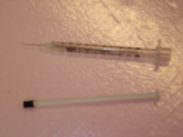

On another note, thought I'd pass on what I do to CA hinges. I buy "allergy syringes" from our local drug store (be ready to explain what you're doing, cause they'll question you....and if they already know you, they know you're crazy anyway...), and pull the plunger out and put thin CA in it. I then inject the CA into the aileron/elevator/rudder hinge side first. Once those are secure, drill a small hole (1/16th or 3/32nd) at the centerline of the hinge slot on the wing/stab/fin for the needle to go into (this helps in getting a tight fit since you don't have to flex the joint so far in order to get the needle into it). You have to shoot a little out between each application in order to keep the needle hole from clogging up (I just keep a paper towel off to the side to soak it up). If you're very careful, and don't inject too much, you get a really tight fit with no mess. You can usually re-fill the needle if you push the plunger in and out when the CA is used up and make sure air is flowing thru it. I still wind up using about three needles per plane, one each for the ailerons, rudder and elevators.
