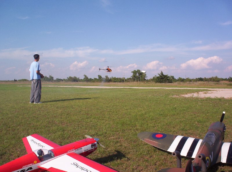

Someone beat me to a video!!! ha ha.. Kurt is that you flying the rotor? That spit sure looks pretty, what kit is that?

Not me on the heli. I can fly them on G3 or Reflex,, but not in the real world.
But "Joe" the guy flying the copter in the pic did the lowest inverted high speed pass I've seen in a long time tonight. He was flying a .40size Arresti.
My old Spit is a CMP.,or GSP as some know it.
But "Joe" the guy flying the copter in the pic did the lowest inverted high speed pass I've seen in a long time tonight. He was flying a .40size Arresti.My old Spit is a CMP.,or GSP as some know it.
