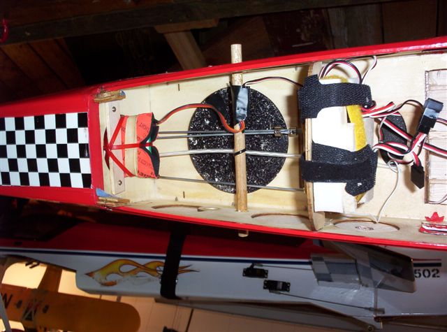

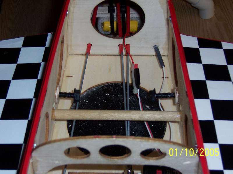

I didn't have to go that far back to get my CG. Those are pics from some other EdgeHeads here on the thread. I'm sure they will see their build and report back.
Mine is held in place by three zip ties. I glued and screwed a small hardwood stick across the rear fuse inlet to use as a secure hold.
The pic is before I did the maiden flight and made the changes like the nylon LG, etc. But the battery remains the same today.

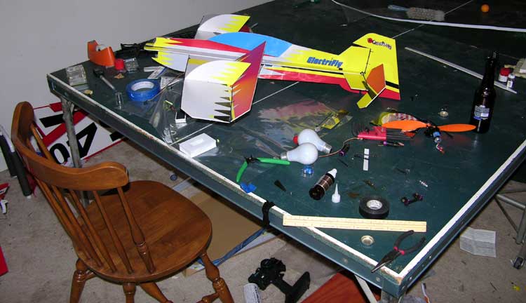

That wasn't mine. I got so many pics of this build by myself and all you guys I hardly know which one to post sometimes. lol
Here's a brand new pic of mine. hehe ,, Wood chips help it knife-edge better.[&:]
While I was out in the hanger I took a pic of my new wing and that nylon bolt I mentioned earlier.
Oh,, and how is that for a messy hanger ?
Show me where all of you hanger your VectorFlight. [:-]

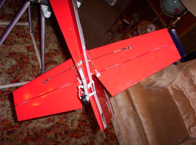

I used a Klett TA-2.
Larry,,, the garage has plenty of ventilation but yes,, it does get a bit too hot to work in there during the Summer months. I work inside when the weather is too cold or hot. I also keep my expensive electrics and 1/2A planes inside during the winter. Have had a few thin wings warp on small planes after warming back up. Larger planes can take the heat and cold better.
Here's a pic of the Klett tailwheel on mine. Look back through this thread and you can see what we all did to beef up our landing gear block areas. Trust us .

Well, the steel tailwheel assembly is kinda heavy. CF or the Kleet would be better IMO.
Another good one is the Sig Mayham's stock tailwheel.

make your own spring tale wheel assembly,i did mine and used what was supplied with the kit.just went to hardware store and got a small stiff spring and soldered it onto the tale wheel i have pictures posted here somewhere.
rcfury.......is that a pingpong table?...............lol.or should i say was it...............

Yup I commandeered the pingpong table. I thought I would put it to good use since all it did was sit there and collect dust. Yeah i know its funny but, hey it works.
