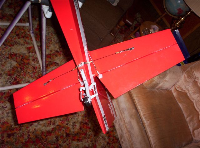

Sturtz:
I purchased the dubro landing gear and I wanted to know what paint did you used for your landing gear? I have the same setup for the landing gear that you have. I purchased the dubro landing gear, the 3'' low bounce dubro wheels and I used 1/4" wing bolts.
Is there any thing special you have to do when you put on the tail wires? This will be the first time I install tail wires.
I have a few things left to do on this plane - fuel tank, canopy, belly pan and misc. items.

I used this..... [link=http://www2.towerhobbies.com/cgi-bin/wti0001p?&I=LXEAN2&P=7]TopFlite Fuel Proof Paint[/link]
Don't use a clearcoat unless it's proven to be nitro proof as well. Had to redo mine from exhaust residue eating into the clearcoat.
I used this .... [link=http://www2.towerhobbies.com/cgi-bin/wti0001p?&I=LXFV30&P=ML]Tail bracing[/link]
Just get them even and keep them tight. (Not too tight.) I opted for the Kevlar instead of the metallic wiring.

Cool, I already purchased that tail wire kit. I have the same tail gear that you have (Klett).
I am going to get some of that spray paint. Thanks for the info.

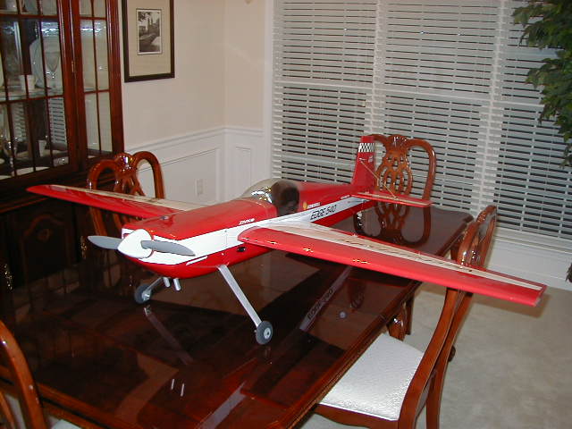

Well, rain and wind today blocked the maiden of my Edge (didn't have it ready yesterday, procrastinated on the flying wires)
Any way - always next weekend. Here are the pics (had to cut the hole for the high speed needle twice because the first time I mounted the engine it was too far back)
Engine: Evolution 1.00NX, Pitts muffler and 14x6 prop
Servos:
Ailerons - Futaba 3151 Digital x 2
Elevator - Futaba 3152 Digital x 2 (did a 2 servo setup on the elevator)
Rudder - Hitec 5475HB Digital
Throttle - Futaba 3151 Digital (not necessary but it came with my radio months ago)
Tank: 16oz

WOohoo !!! Man she's all shiny and looking good Shakes.
Yes,, that 3151 is kinda overkill for that task. (throttle) Your servo setup is exactly like mine. Even down to the Hitech on the rudder.
Only differance is I put a Fut-3004 on the throttle.
I bet your MORE than ready to try her out eh ? Best of luck on your maiden.
