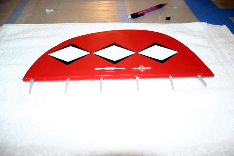

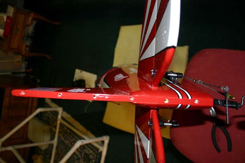

I had the same concerns when doing a repair job on my Pitts. Here are some pictures of how mine worked out. I also used extra hinge points to add strength. Holding fine. I used Gorilla Glue as well.
