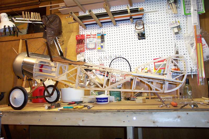

So how is it goin with your firewall mounted servo, any interferece??? I just mounted one and debating whether to move it after some of the threads I've read. My 1/4 BUSA Sopwith Pup has a Zenoah g-26 and I won't fire it up til spring....any advice would be greatly appreciated, thanx, ken
