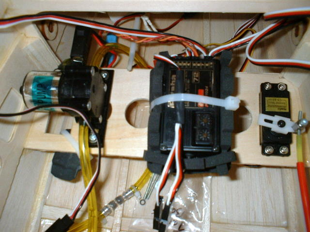

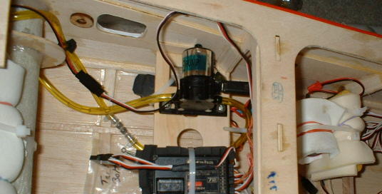

It's the Simple Smoke Pump, by I beleive TME. Is anyone fimiliar with this pump and if it is two inches above the receiver will it cause a crash when turned on ?

I have the TME simple smoke pump and it comes with an electronic switch unit that has a plug in for the reciever. My pump has capacitors installed on the motor and never caused any RFI in my airplanes. I did, however, make sure the pump was a few inches away from the reciever. Maybe three or four, and never had a problem even though I don't have PCM.
I HAVE TME PUMP ON MINE AND ITS ABOUT 2 INCHS AWAY FROM REC. NO PROBLEMS ON THE GROUND . I HAVENT TRYED IT IN FLIGHT YET. IM USING PCM.

I quess I'll wait for your guys to try out your smoke systems and see if they cause any problems. I know Dave had numerous uneventful flights on his Lazer before he installed his smoke system and crashed. Some how we believe it's related to the smoke system installation.

That could be rcguy1 but I've used mine dozens of times with no RFI problems and I've seen the TME system on dozens of other aircraft with no problems either. Not to say that something isn't wrong with his particular pump but TME has been around for a lot of years.

Default smoke on patty
heres a pic of my TME pump.

Default SMOKE ON PATTY
ANOTHER PIC..
