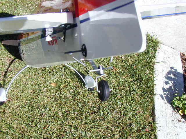

I got to fly my Patty yesterday. This plane is awesome! I do have a question for those Moki 2.1 users out there. WHat is your top-end coming out at? I have just over a gallon of 5% through the engine and I am only getting 7,000 out of it with a JZinger 20X8, K&b-1L plug, and a Perry regulating pump. Are you using large fuel line? What am I missing? will it get faster with more break-in time?
Thanks in advance.

If you can make the engine go rich at full throttle, the fuel tubing is OK.
If not, you will need to go into the tank and change the aluminum tube and the interior fuel line to something larger and drill out the clunk.
Also, the Bisson HIGH VOLUME pitts for the MOKI 2.10 adds a couple of hundred RPM.
And finally, Zingers tend to load down the engine more than other brands.

JRF:
I already have the Brisson muffler installed. When I first started breaking it in, I could not get it to richen any SLOWER than 6400. This leads me to suspect a restricted fuel flow, even with the Perry pump. I'm going to re-plumb the fuel system with a larger setup.
Thanks!

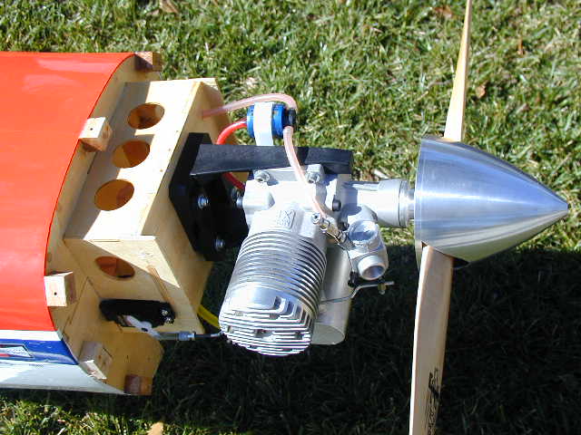

Jmulder:
check the reply #1491-1492 for my setup in this thread. I balanced 1/8" aft of posted CG at 15.8 lbs

Your photo shows the smaller 180/210 Bisson muffler. The high volume muffler has a larger can.
If you can't get it to richen up BELOW 6400, it sounds like your low speed adjustment is too lean. The low speed disk is very sensitive and it is sometimes a little difficult to get it right, but once it is, it will stay right for a long time.
If your low speed is too lean and you are compensating for it with the high speed needle, that could explain your problem.
I'd suggest you find an experienced MOKI tuner to help you set it up the first time.
