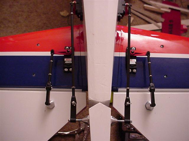

DeadStickerI am not sure of your theory of putting your hardwood dowels so far into the wing. They shoul be mounted as close to the hinge line as possible and then the control horn is trimmed back to be even with the hinge line.
By doing it the way that you did , the servo arm will have to move further than if the control horn was mounted on the edge.
You want to get the throw you need with as little movement from the servo arm as possible. For correct mechanical advantage the servo arm should be the same size or smaller than the hight of the control horn.
I hope this helps.

What you said makes perfect sense. I got it all done and I actually had to turn the epa's down because on 100% dual rates it was trying to overthrow. Now I have epa's @ 82% and high rates @ 97%. Maximum throw that the ele will allow. But what you are saying is right. I just didn't think about it before I started. Thanks for the info...maybe someone will use it. Here is a pic completed.....

DeadSticker,
If possible set up your servos and controls mechanically so that it takes the full 150% travel to reach your desired maximum throw. This will give you better mechanical advantage and longer servo life. This was repeated again and again in the DP Extra manual for setting up the gear, and to me it makes perfect sense.

The pushrods I made from 4-40 threaded rod and carbon fiber tube. Really easy (and cheap) to do. I just put the control horns on, measured the gap inbetween, cut thr rod, put it on with the #4 nuts, measued inbetween the nuts, cut the carbon fiber tube, put it all together, CA-ed the nuts and thats it! Total cost...$.68 a rod for the 4-40, and 5 bucks for the carbon tube. I was gonna JB Weld them in, but the 4-40 fits perfect in the tube. The control horns are the new dubro heavy duty. I have rocket city on my 33% patty and I must say that the dubro is more stout. I might even pull the rocket city off and put the dubro's on it too.

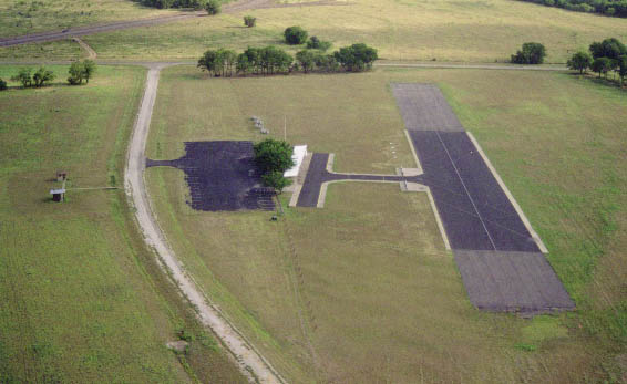

Peninsula modelers main flying site. NO GP extra flight today to much wind. 20 degrees
how to bring a 40% to the flying site.http://peninsulamodelers.com
