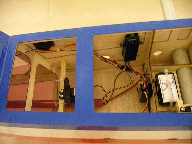

Got to spend more time with my ARF last night. I'm really pretty pleased with it so far.
I cut the covering for the wing tubes, canopy tray and servo mounts.
I test fit the H-stab and it fit perfectly, no gaps, tube in snug but not too tight to make it difficult. The wing tube was a different story, going to have to do some sanding I think. anlhough I am considering a CF tube. (anyone reccomend a good company?)
I'm not happy with the way the wing mounts, 2 hooks in each wing half that are held with springs in the fuse. I'd like some feedback on this as I'm thinking a small ply reinforcement on the inside of the fuse and using nylon bolts ala GP Patty style. If anyone has a Patty and can send pics I'd appreciate it. I was also thinking of making the tailfeathers removable instead of fixxed as well. As it is it has an alum tube and an alum alignment pin... shouldn't be too hard to tap the tube for cap head bolts.
I guess the only other issue I need to solve is what to hang on the nose of this bird. I see someone else planning on a Saito 1.80. I was looking at the OS 1.60 or the Supertigre. I'm not looking for 3D just IMAC basic and if I have the power to spare, smoke. So feel free to let me know your thoughts.

Motor selection, Saito 1.50 sounds good, but I was thinking AUW would be near 13 so was planning on a 1.60 2 stroke. I'm sure you'll be flying before me so let me know how that works I might go with a 1.50 as well being that 4 strokers are better smokers from what I've seen.
I'll have to check the manual again, I didn't realize it was an option to use the screwes instead of the springs, rather I thought they were both required, hence the idea to ditch the springs and hooks and place nylon bolts instead.
I did notice the oversized gap in the landing gear channel... and I'm having to ditch that gear for CF... to me, it just looks wrong, feels way too heavy for my liking.
The rear feathers fit perfectly like you said, and I like the setup a lot better than previous .40-.60 size birds where you have to slide the stab covered in epoxy through a slit and clean the mess later. The tube and alignment pins are spot on and I hope more companies adopt this. As I said earlier, I want them to be removable if it can be done without compromising flight safty or stability. I just think the size of this bird needs it. I have a Sequoia to haul it in but am considering a ne car next year thats a lot smaller and I dont want to have to buy a sealed roof rack, or a trailer.

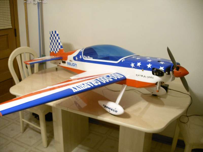

Today was my first maiden.
Well for the most part the wind was 15-25mph. It sucked. I couldn't really tell if the plane was flying well or not because I was getting pushed around so much. I decided to go with the pull pull in the fuselage and it still didn't want to land when I came down. It seemed tail heavy. I'm going to wait for the weather to cooperate with me so that I can try again. I was spinning a 16 x 4 W and I had 11,000 RPMS. Crazy!!! I have a 17 x 4 W I am going to put on to slow my YS-140 down.

I used the engine mount that came with the kit. All in all, the arf had a lot of things that I liked about it. The firewall had a fiber glass cloth already glued into it for reinforcement. I did also re-glued certain high-stress areas, just in case....But I liked the fact that they it came like that from the factory. It saved me a trip to the hobby shop.
But it also had some things I didn't. For example, there's no way I could get 45 degrees of throw with the plastic control arms that came with the kit... I checked it out about 30 degrees. So I bought the Dubro arms and now I am at 45-50 degrees on high rates...That will come in handy to hold a hover. The arf also comes with a generic gas tank...Go put a Dubro 24 oz in it. you will be glad you did.
The instructions also said to glue the stabilizers in place. Well, I didn't. I drilled a hole through the aluminum stab and fitted 2 4-40 bolts and used medium ca to hold them in place. I have the same set-up on my Composite arf, and it works fine. Next I decided to go with the pull pull inside of the fuselage instead of the tail and you know what I think it's still tail heavy....I have to wait until the weather gets better so that I can try to trim it out again.
As far as the DZ.....Wow!!! That thing is a monster. I have a DA-100 on my Composite, but call me Crazy, but I like the 140 more only because it doesn't suck 2 oz per minute like my gasser does.

That's a nice mount...I'm pretty sure that would would work.. Just remember that the firewall doesn't have right thrust built into it. You have to side mount the engine and add 2 4-40 size washer on on the firewall (top 2) for downthrust and atleast 2 washers in front (left) and (right) for right thrust.
