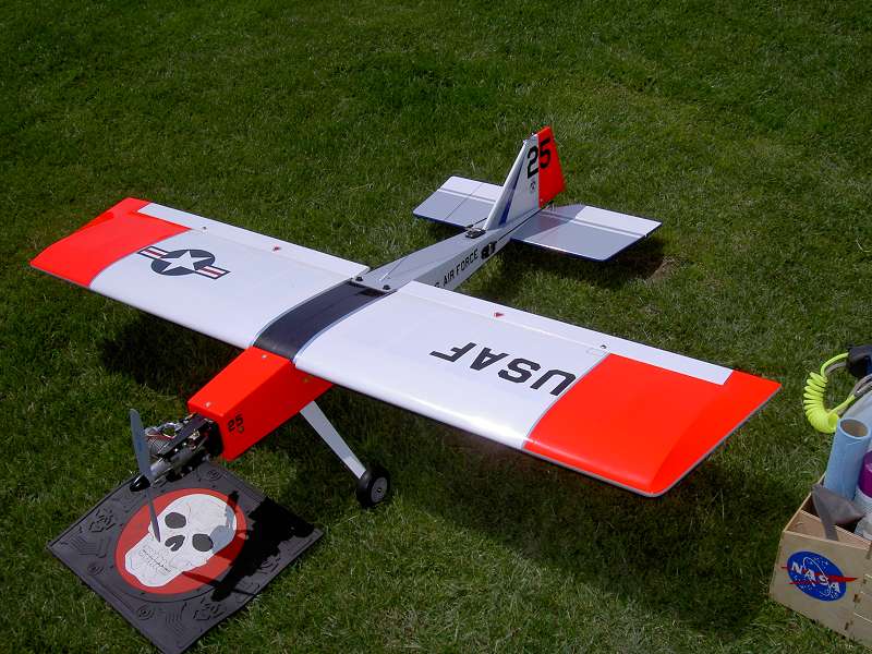

I've had my US60 for almost 6 months now and the only modification I made was a larger 15oz. tank. A Saito .82 hangs on the nose and no tail weight was required to balance. More than enough power for this plane. Had to move 2 blind nuts on firewall to make the smaller .82 fit, but that was no big deal.

I really like Storkeman's US with the .82 on it. I'll bet it flys just as good as my OS .91 plus he didn't have to move the servo's to the rear like I did. If I were buying a new one thats what I would do.

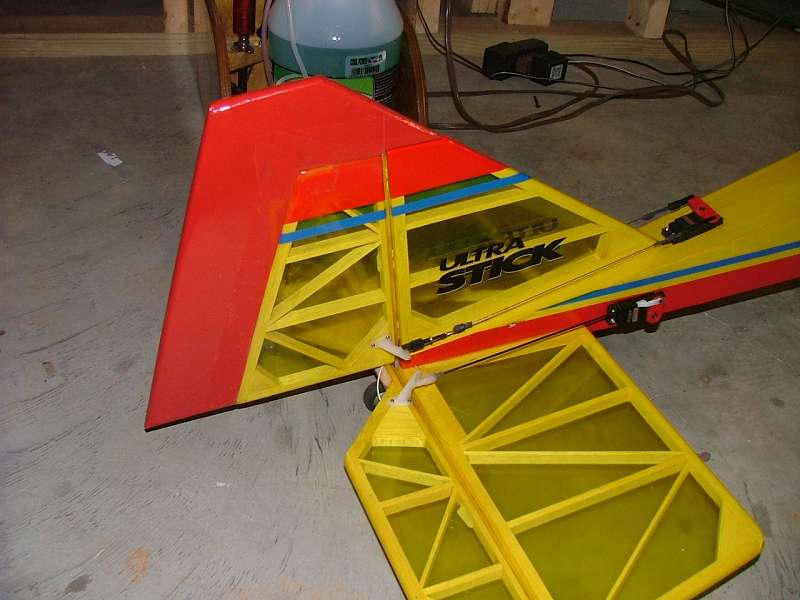

Here is a mod I am just trying. I took some old Ultra Stick 120 flaps and added to the rudder. I covered the new piece and just tapped it to the rudder with packing tape. If it helps I can glue it up and recover the new rudder. I saw Dave Robelen do his 120 the same way. I have flown it twice but the wind was really gusting hard so more testing is needed but it does help the KE and Hammerheads.

I just got my stick delivered today, and will start on it tomarrow. A mod similar to what you did to the rudder is often done on the Four Star .60. It has been discussed on the 4 star threads and is very effective to solve the knife edge coupling the standard 4 star 60 has. That plane knife edges fine once the mod is done. Needed a bigger servo than I had to get the power for it to do a knife edge loop though. I had a ST .90 in it. Anyone put one of those in the .60 ultrastick?

Well I have flown mine 5 or 6 flights with the larger rudder and it does help the KE but it is a crosswide dog now. It reminds me of a Stinson 108 with that big tail it weather vanes into the wind. I think I will take it off for now and build a little bigger rudder.
