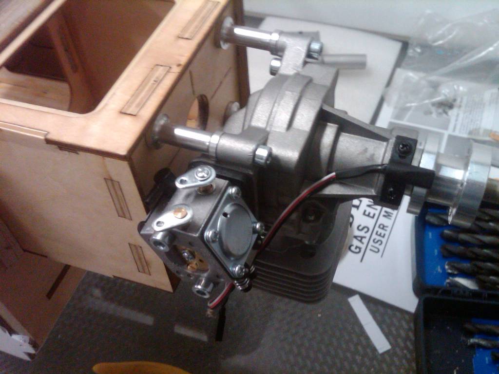

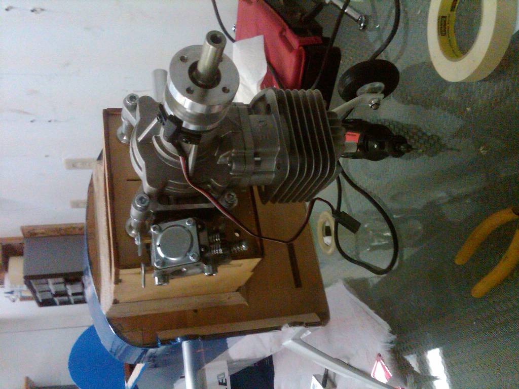

Can anyone post pictures of there set up using the DLE 30 and where everything is mounted please? I have went thru some threads and it sounds like I might have trouble balancing since I put servo's in stock locations in the tail?

I am going to add 3/4 dia hard wood stand offs to get the engine forward. Cut them to length. Buy longer bolts and use good sized washers on insde of fire-wall. To find center of cowl...take a flat peice of wood a little bigger that the footprint of the engine. Use a cardboard template to mark engine bolt holes in the flat piece of wood. Glue a 1/4 inch dowel on center. Place the cowel in place with the dowl on center of the hole for your prop shaft. Mark the holes using this device on the fire-wall. Now when you place engine on fire-wall it should be close to the right center alighnment. Now you can understand what I am try to say....not good at explaining on-line. Capt,n

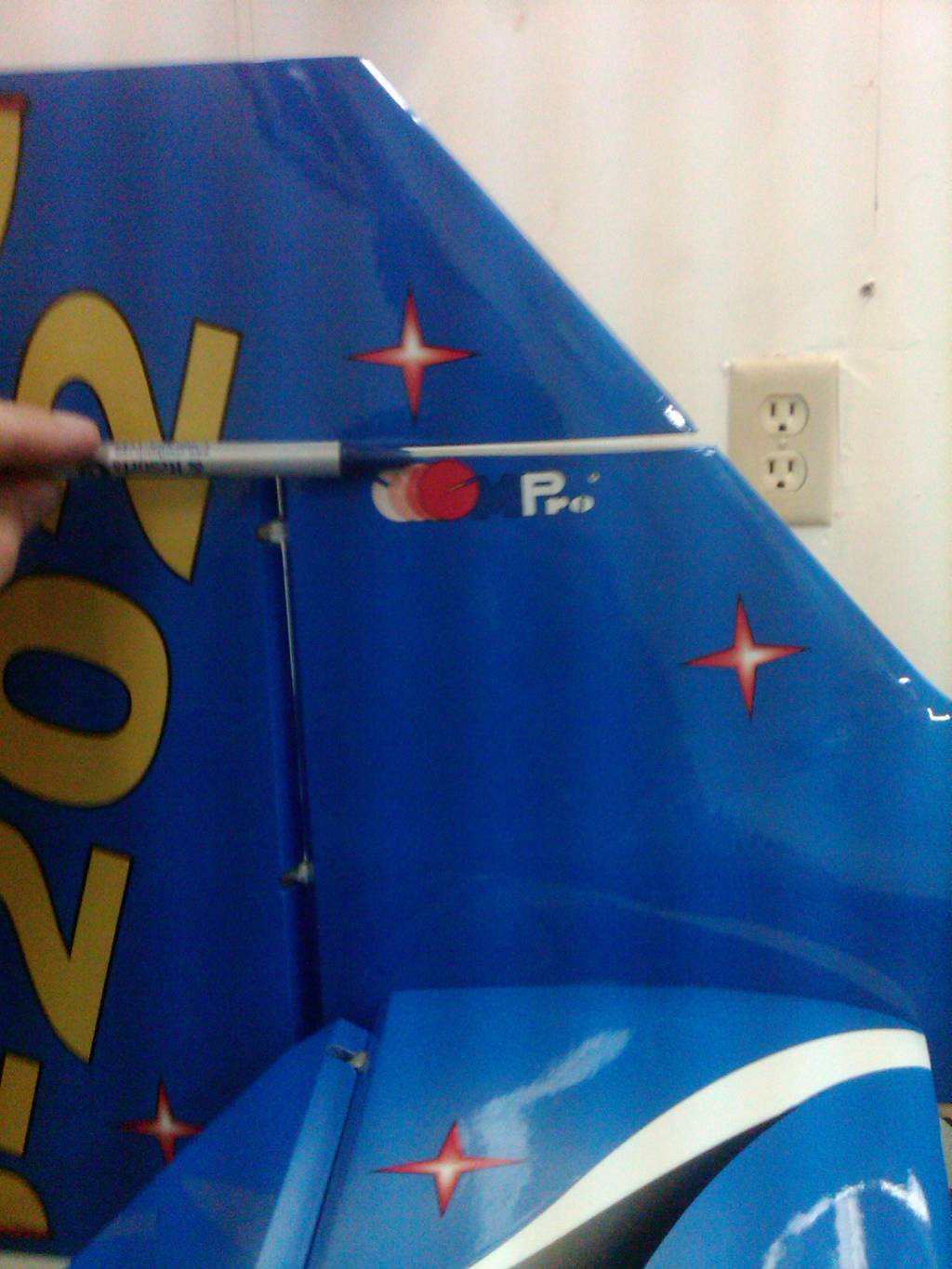

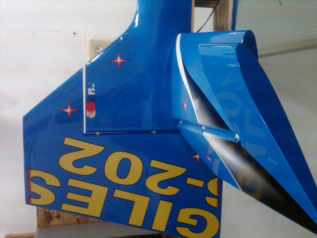

I have some pictures to post as promised if I can figure it out. I am worried about the space inbetween my rudder. If you look at the plane from the side and look at the top of the rudder, inbetween the top of the rudder and the airplane frame is a gap almost the size of a standard ball point pen. Is that going to cause problems or fluttering?

That sounds like an excessive gap to me. Might be flyable, but it sounds ugly. I would rehinge the rudder if you already glued it in. If you have not glued her in yet, just drill yourself some new holes to close the gap. If you have that large a gap, you have space to drill new holes on either the fin or rudder, and not intrude on the existing ones. My gap is only about 1/16", between the top of fin and the rudder. Jon

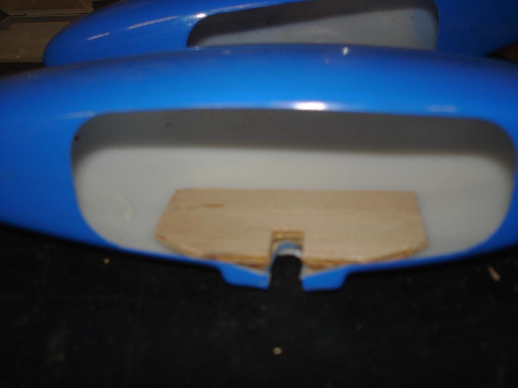

Hopefully these pics work

That pic shows the gap is not bad, maybe only 1/8". I thought you were talking about the entire width of the ballpoint pen. I would leave the rudder alone with that little gap. Jon

Phew! Thanks! I was worried. I'm trying to figure out now how to do my throttle linkage. As you can see in the pic the inside leaver is the throttle and the outside is the choke which is almost a 90 degree angle for the throttle cable coming thru the firewall. Any ideas on how to attach that?

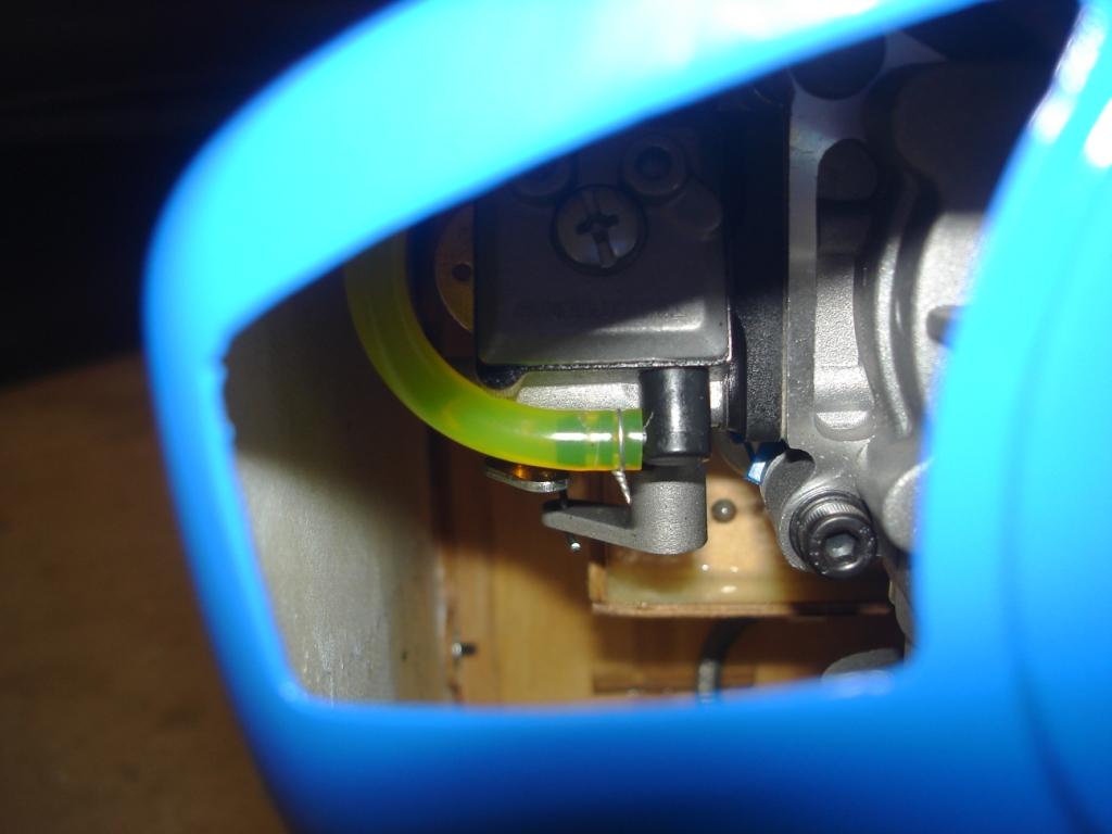

well i maiden my giles 202 with dle 30 in its stock form did not miss a beat the only adjustment i made
was the idle ran like clock work what great little donk
Hi buddy there is some things i would change to to get the C/G right one you will need to put all your battery's up front with dle 30
turn the carby up side down
put the motor from the fire wall to the back of the prop 145 mm
and fix the wheel pants not very strong my ones crack in the air on the maiden in the air
