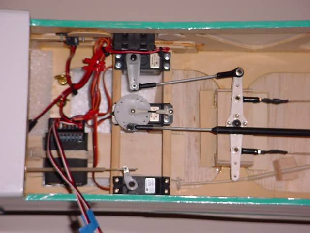

RCpilet;
If you're interested, I'll post a pic of my set-up, which uses one servo per function, with an offset rudder servo and central elevator servo.
I too use a bellcrank to get around the necessity of having both the elevator and rudder servos centrally mounted.
Agreed, the supplied elevator pushrod is zilch. Ditto for the supplied push-pull hardware too, IMO. I used the Dubro kit for rudder cables, and a Dave Brown f/g arrow shaft for the elevator rod.
The elevator pushrod is, however, exactly the right size for adding an extension to the hardwood elevator frames where they want you to mount the Sullivan horns. IMO, that area is WAY too small. I cut a chunk off of the supplied elevator pushrod, which is the same thickness as the elevator wood, cut open the UltraCoate, and epoxied it in place.
Steve

The Nelson rudder bellcrank is mounted on a home-made platform. The elevator pushrod runs right over the top; you have all sorts of room to do it like you want.
If you go with a single split elevator pushrod, it is extremely important that it be centered, or else yoi will get differential throw on the elevators and the plane will be nearly impossible to trim properly. I still can't believe Horizon tells you to offset the servo and pushrod...
Keep in mind that it is EXTREMELY important, when doing a closed-loop (push-pull, pull-pull, whatever) system, that the distance between attachment points at the servo is exactly the same as between the two rudder horn attachment points. IOW, the linkage should describe a parallelogram. Failure to do this will result in assymetrical response, cable slack, the common cold, dandruff, etc.
Have fun. This is a great model.
Steve

What a great idea Steve! Almost makes me want to take out what I have! Wish I had thought of that! It would have saved me some work on the bottom sode of the plane with the bellcrank that I put in the rear.
I'm going to keep the pic for later use, thanks!

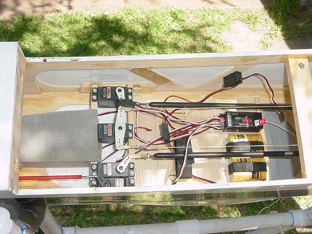

Steve I have a couple of questions. After seeing both your and my setups I think I want to try a combination of the two for my GeeBee (my rudder with your elevator). I am not sure why you needed to use the rudder setup you did. The second servo and linkage seems unnecessary unless you just like building neat looking things (thats a compliment, not a dig). Does the elevator rod running back to the bellcrank in the rear have to be near the center of the system or could it be offset to one side? also I hate to admit that I am having a hard time understanding what it is you guys are talking about with all the angle stuff on attachment and hinge points. of your push-pull setups.

You're talking two different things; a split elevator pushrod, where you have two independently-hinged elevator halves, each driven by one side of a split pushrod, is an entirely different animal from a push-pull or pull-pull rudder (or elevator) set-up.
Not sure what you mean by "extra servo". I have one servo driving the rudder bellcrank and one servo driving the elevator pushrod. The rudder servo is offset because when using a split elevator pushrod it MUST be centered in the fuselage; otherwise, as it moves it will move one elevator half more than the other. You can see the problem that would cause.
It is possible to remove the differential in an offset pushrod by bending one side, but that would take quite a bit of trial-and-error, and we know that the less bends in a wire pushrod, the better.
Anyway, the use of a bellcrank allows the rudder servo to be offset so the elevator servo can be centered, while keeping the bellcrank for the rudder centered as well. Ya just have to think in three dimensions...<BG>
Volfy, I don't doubt you for a minute. But I'm drawing on my experiences with helicopter linkages and solid pushrod/ball link set-ups. With those, you had BETTER have a perfect parallelogram, or binding will result. I guess the short distances involved do not allow the radii differential to erase itself. Interesting...
Steve

Steve, long story short. I did a lousy job of describing my questions. but you answered them anyway. I thought the elevator pushrod in your picture above was to a bellcrank, not a Y.
