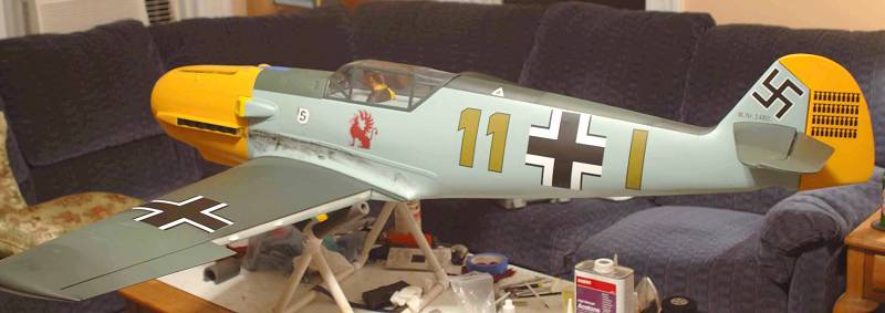

Jimmy Skids, sounds like the way my .90 Spit flies, more like 3D plane than a warbirb. I was flying it for the first time yesterday and when i was going vertical if I gave it more than a hair up on the elev. it would literally flip it over forward like a 3D and the tail would almost want to go straight down in the corners no matter how slow or what angel of approach i used. It's balanced at 125mm. I wonder if the CG of 90 - 100mm applies to this plane as well. Would be more practial and make more sense. MANUALS NEED TO BE REWRITTEN. They do absolutely nothing for the setup other than confuse you.
At just over 11 lbs with the RCV .91 and a 14x7 APC I am only getting 8000 rpm out of the motor and it seems very under powered, in comparison to the the vid from YT with the same plane/motor combo. Starting to wonder about that, even with a 20mph tail wind it was slow and sluggish at best.
Going to glass the wing and rear stab and paint it then get a gas motor and see how it does. Got some video of the maiden flights yesterday and will post them when I get done with them so you can see what i was talikng about.

Shane,
I had the same problem with my CMP Spitfire. I progressively added more nose weight (and shimmed out the enigine, too) until it flew well.
Finally result: Balances at 95 mm. I would recommend 90-100 mm for this plane. Alex from A-K Models is aware of this, and I think that he is informing his customers that this could be an issue.

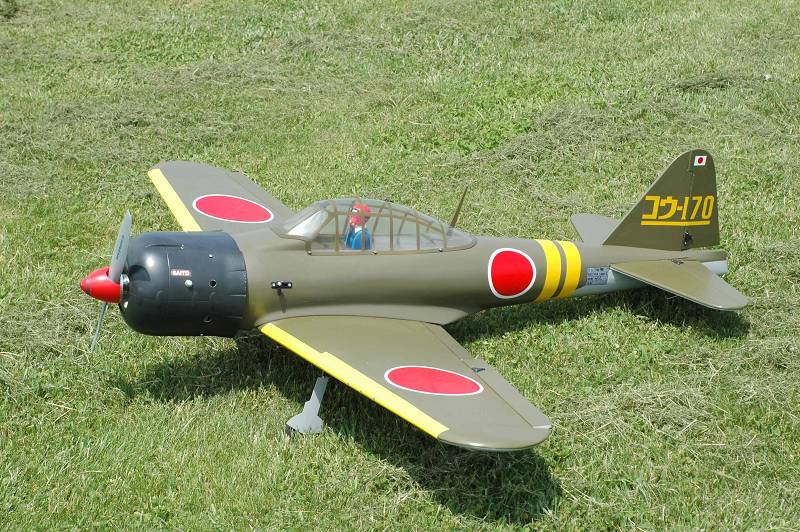

I have the CMP 120 Zero with a Saito 180 in the nose. I have over 50 flights on the plane.
Here are the issues I have but overall I love the plane:
Wing or tail incidence is off as I have to fly the plane with a lot of down elevator to maintain level flight. There is no way to adjust the wing in the fiberglass saddle.
I wish it came with flaps as it is so hard to get the langings really smooth... may be from the incidence.
The paint chips easy but is not a big deal as I have a match touch up for both colors.
The epoxy for the servo & Fuel tank trays is weak and needs to be redone.
You need ot add elevator and rudder controll rod supports mid way in the fuse to keep them from fluttering and breakage.
Overall it has no bad habbits and is just a great fun to fly bird. The saito 180 has unlimited vertical yet flights need to be kept at 5-7 minutes. GSP also keeps some of the parts in stock as I was able to get a new canopy.
