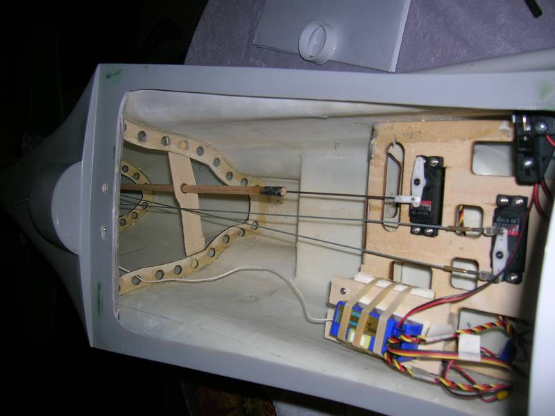

Hi,
I have a CMP Yak-54 140. Have not flown it very much so I can't comment on the long term quality of the covering etc.
With my kit I did not get any building instructions other than the plan and a separate sheet with CG information.
No big problem here if you have built a couple of ARFs.
However, the main problem during building was to get the CG right. The plan is way too tail heavy, it is
not possible to place servos according to plan, without placing huge amount of lead in front.
The design is very bad and I guess that CMP never actually tested the kit before shipping.
Solution: Re-design so that CG can be correct.
Here is a list of the things I have done to minimize the weight needed in front.
- I only have 1 elevator servo (instead of 2) and have moved i forward to just behind the undercarriage mounting. For this I use pull-pull.
- I have my batteries as far in front as possible under the cowl.
- I have my throttle servo in front of the firewall.
- The engine is moved forward 15mm (from what the plan specifies). I guess I could move the engine a bit more forward, but I don't know how it will affect the flying characteristics.
I have added 280g in front and my CG is about 140mm from LE.
Here is a thread on the Yak-54 140 and many posts is about the CG problem.
[link]http://www.rcuniverse.com/forum/m_2162263/mpage_1/key_/tm.htm[/link]
/Erland.
/Erland.
