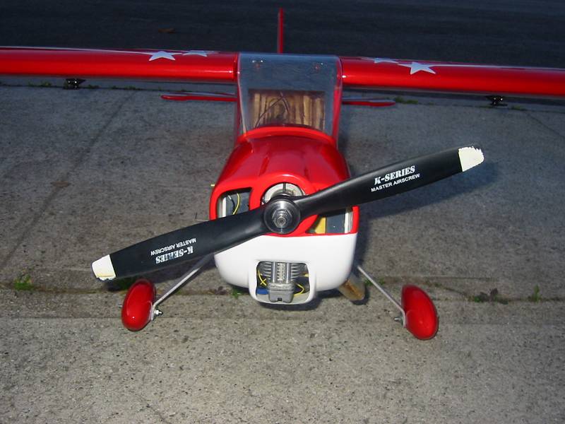

You need to look at your particular setup and figure your prop clearance accordingly. With the Ohio Tail gear being so stiff, but higher than the stock unit, flying off pavement with a 14 or 15 inch prop isn't much of a problem, unless you set down really hard on landing.
I tried a 13X6 and 13X8, but felt the engine was revving too high with such a small prop.
I compromised and settled for a MAS 14X6. The engine is revving to nearly 10grand on this prop. I am afraid that in the air it will go much higher, so I set a really broad power curve on my 9Z to prevent accidentally over revving.
Of course, the proof of the pudding will come, whenever the weather lets me test fly it and see how it goes. I did remove the wheel pants and installed a little larger, stronger main wheels and smaller tail wheel to enhance using the 14" prop. The brown truck brought me a new GB Obsession last Saturday. Nearly have it finished. Waiting on a 8611 servo to come for the rudder. Once that's in, it will be ready to test fly too. Weather man forecasting rain and wind again this weekend, so don't know when I'll get out my first flight reports. I have three new planes in the hangar waiting test flights.
Don't trust the stock wheels, both of mine failed the first time out. The plastic on one just shattered during take off attempt. May have had a piece of debris get kicked up into the whell pants, but they didn't show any indications of such.
Hope you are having better luck with yours than I have had with mine so far.

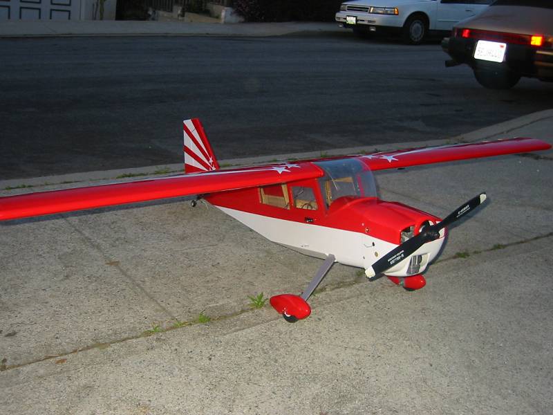

Well; It took 6oz to balance at 90mm behind the leading edge.
Needless to say some movement will happen of some radio gear shortly but this weekend I have to fly it. The weather tomorrow is looking like it will be okay in the morning with rain starting around noon. I plan to be done by then.
I test ran the engine today and had what seemed to be a good idle but I didn't tac it - it wasn't rolling though which is what I shoot for. Seemed reliable which I always worry about with an inverted engine. But...tomorrow if all looks good she flies.

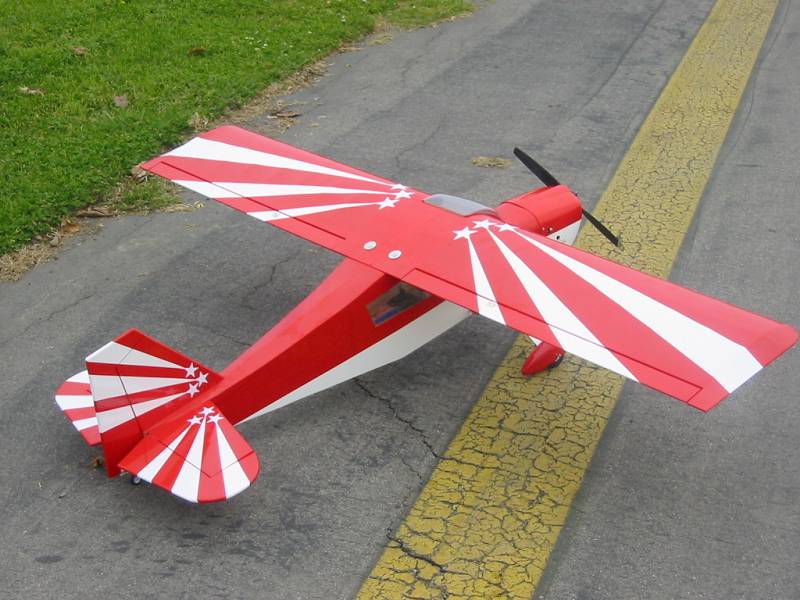

Alright; First flight went well. I had eyeballed the control throws and they weren't too far off but they were a little more than needed and the rudder was very powerful on the first flight so my takeoff roll wasn't that pretty.
So the first flight went well; I trimmed it out and did a few passes to confirm the trim slow and fast and it seemed good so I then went to slow speed stuff. I like to get real familiar with how and airplane stalls and this one seemed to stall to the right gently but then when I Would try recovery it would recover "badly" in that it was hard to get flying again. It didn't seem snapish just that recovery took some effort - so...don't stall low. Also I know I need to do some more balance work on it so maybe that will help a bit. Entry to the stall was fairly gentle and it didn't have a thing for snapping badly so that's all good.
Landing was nice too; I just brought it in with some power and it held a nice mild nose high stance and I just used the elevator to bring it down. It doesn't float in at all really and because of the poor stall recovery I wouldn't advise trying it.
The next two flights were some fun and aerobatics. It'll hold knifedge easily but it does have a lot of coupling issues. I had to hold hard opposite aileron and some nose down to keep it straight but it did it well. It also tends to go nose high in aileron/elevator turns so rudder coordination is a good skill to have (unless you're lazy and want to mix it in). Even with a little nose heavy as I had it it still did very well inverted requiring only a little down elevator to hold it. It snapped okay; I think the nose heavy held it back a bit here as it wouldn't really get into the snap until well into the second turn. Still it was fun regardless.
All in all I'm very pleased with it and feel like it's a good scale flyer even though I have it over powered. I think something like a strong 50 2 stroke or a strong 70-80 4 stroke is the sweet spot and that the 91 is a little overkill but that's what I had and it was the only engine on my shelf calling to me constantly for use (it hated being on the shelf and proved it today with its behavior).
With the tank moved as I mentioned earlier in the thread I had a nearly perfect idle with 20/20 and a 14x6 mas prop. I have an APC but the MAS looks better in this case; otherwise I would never use it (they flew way too much). I'll probably try the APC next time.
All in all I am very pleased with it and think it's going to be a nice airplane to have in my hanger. I do think it needs a few pinstripes though.

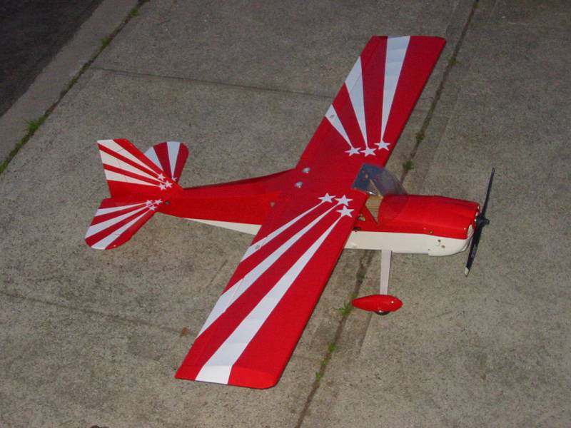

I think it would be quite snappy at 100mm; Today I started at 90mm and then 3oz fell off - now I'm not exactly sure where it is but I flew it nose heavy like that and it was fine.
I'm going to move the servos back into the tail in the coming weeks and liberally laterally balance it better.

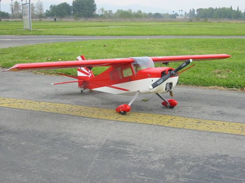

Easter Sunday morning, almost dead calm. Take off a little quirky, turns to the left, the tail dropped and it wallowed in rolls. Landed, put in quite a bid of differential on the ailerons and mixed a little left rudder, with left ailerons. Knife edge much better, rolls straighter left and right. Let a very experienced friend fly it. He had near perfect knife edges, rolling circles, very precise point rolls. The .91 4S with the 14X6 prop gives it nearly unlimited vertical performance. On low rates, flies very scale. On about all you can get high rates, it rocks.
My friend could not believe it was only a $120.00 ARF. I will fly it about 5 more times, so I can fly it in the scale fun fly I am CD'ing in June. Only need to paint the cowl on my Dynaflite SD and it will be ready to test fly in a couple of weeks. I finished the tedious task of pinstriping all the stars and trails yesterday, since it was too windy to fly.
The little Pheonix SD is really a neat little scale airplane. Mine will get floats put on it later this summer. It should have plenty of power to pull it with floats with this engine. That is the reason I went with a .91 in the first place.
Hope everyone has a Happy Easter!!!
