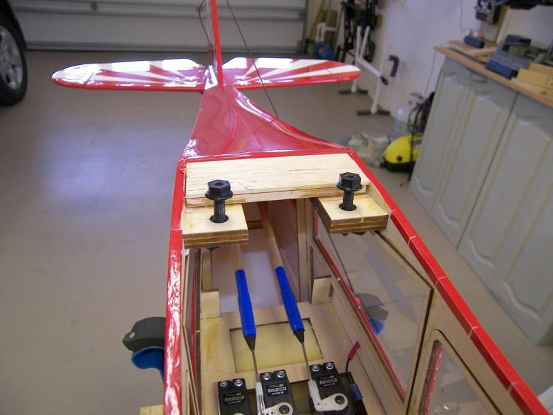

ORIGINAL: IronCross
I mounted my Saito .56 as far out on the rails as possible, in the stock position and also have to use a remote glow setup... Then angle on the plug would require a big ugly hole in the cowl and chopping out a section of the firewall to get the igniter on the plug otherwise... That one caught me by surprise... No problem though, I had one handy...
ORIGINAL: submikester
I mounted my engine last night, inverted. Need to get a remote glow ignitor though; that's the one thing that is really irritating about inverted setups - trying to hook up that ignitor.
I'll probably get it mostly finished tomorrow night.

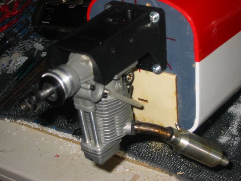

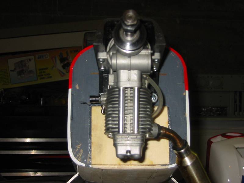

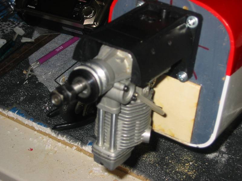

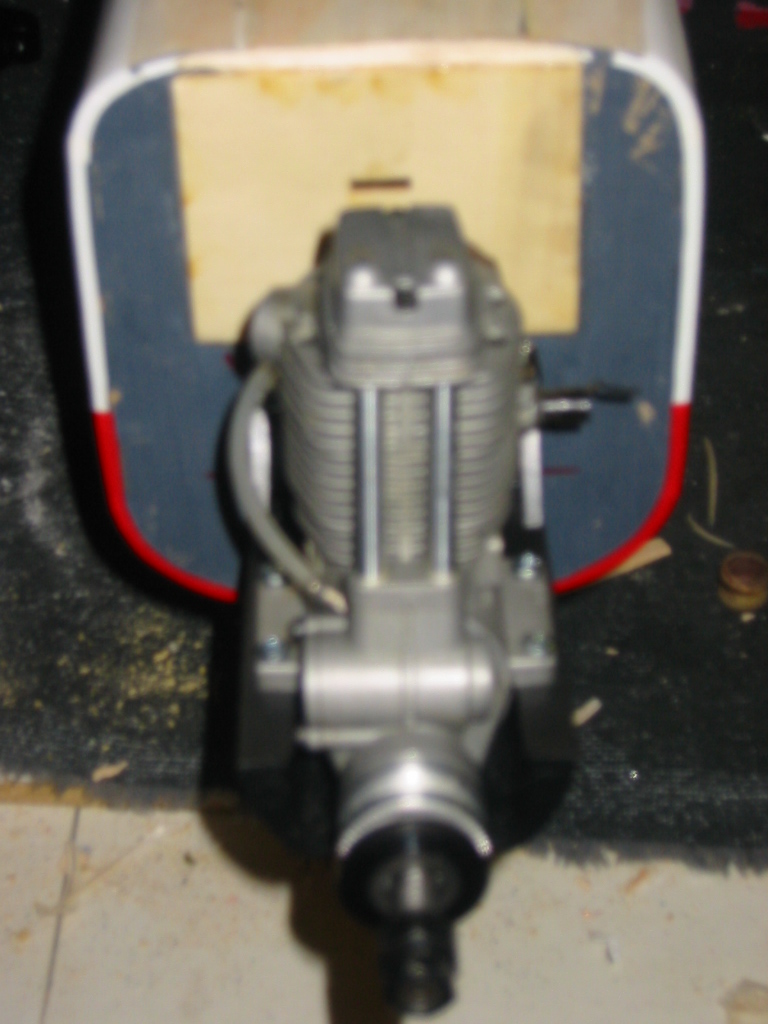

Slow going... Installed the elevator and rudder servos tonight. I didn't have as much time to work as I thought (kids will do that...). Means tomorrow night will be a bit rushed to get it ready for saturday (assuming the weather holds). It's been rainy/windy here like crazy. It's howling tonight...no telling about saturday though so I'm sticking with the plan.
Here's a few pics of the engine area since there seemed to be some interest...
#133
submikester
What size motor mount did you use on that... GP mount I presume...
I notice a peice of balsa added to the front of the firewall... Did you have
to recess the firewall to get the engine back far enough for the cowl to fit ?..
IC
IC
#134
Have you installed your engine cowl yet? I installed a .91 FS using the GP .60-1.20 mount and had to mount the edge of the mount nearly flush with the top of fuselage to get the thruse line correct and the cowl to line up correctly. With the inverted larger engine installation, the tank still lined up adequately without modifying the tank mounting position. The original tunnel, that you enclosed really makes a great exit for hot air egression. With your current modification, you may want to consider a fairly large airdam on the bottom of the cowl so you get enough airflow across your engine to keep it cool.
Please let us know how your new tank mounting position works out.

It's a magnum 91 rfs and a GP or hayes mount - can't recall. I think I got the thrust line correct but I didn't have to go all the way to the top as Mike mentioned. We'll see, if I'm off it's only an 1/8" to 3/16" or so - I can adjust that with up or down thrust...I hope...
No, I didn't have to recess it to get it in there that is just a peice of light ply covering the hole left from that box that is originally there for the standard muffler. And, yes removing that box does remove some cooling but I don't think it will be a problem. The cowl has a nice intake for fresh air - I just have to make an equally nice outlet for that air out the bottom of the cowl. Like I said - I don't think it's going to be a problem as I've had this configuration before in other airplanes. We'll see though I'm sure.

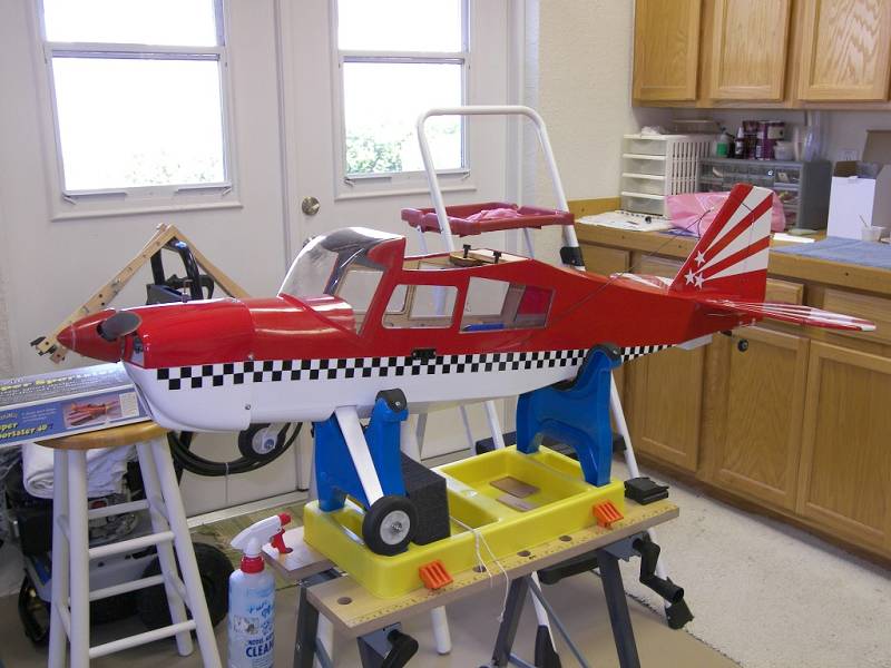

My Feedback: (55)

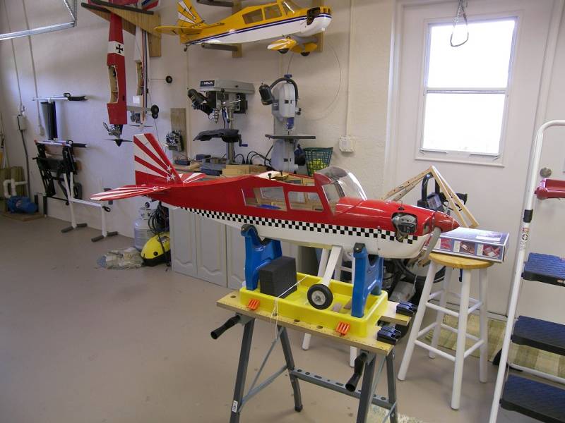

This kit may well be one of the best values on the market. I don't consider poor quality at any price to be a value so I am reasonably difficult to please unless the quality is built in and I am very happy about this one. I would readily recommend this to any of my flying buddies. The plane is now ready to fly but, the wind is very gusty and not cooperating. I decided to use an OS 70 II and now have about four tanks of fuel through it and have achieved a very reliable idle already. I mounted the engine sideways, using a GP mount, to accomodate my glow starter and to make it easy to add fuel. I can live with the cylinder head poking out of the starboard side of the cowl. I did add triangle stock to the front two posts that provide the load carrying to the frame of the fuselage. Additionally, I filled in the area adjacent to the wing hold bown bolts to give the wing something to distrubute the load when you tighten the wing in place. I used a GP 10 oz fuel tank and it sits on foam resting on the original floor.
I did find that some of the metal hardware was soft and replaced the engine mount hold down bolts with some better stuff. I did have to add 4 oz to the tail section to make a 90 mm balance point. The wheel pants are not going to work on our grass field so they are still in the box.
I will let you know how the flight test turns out.

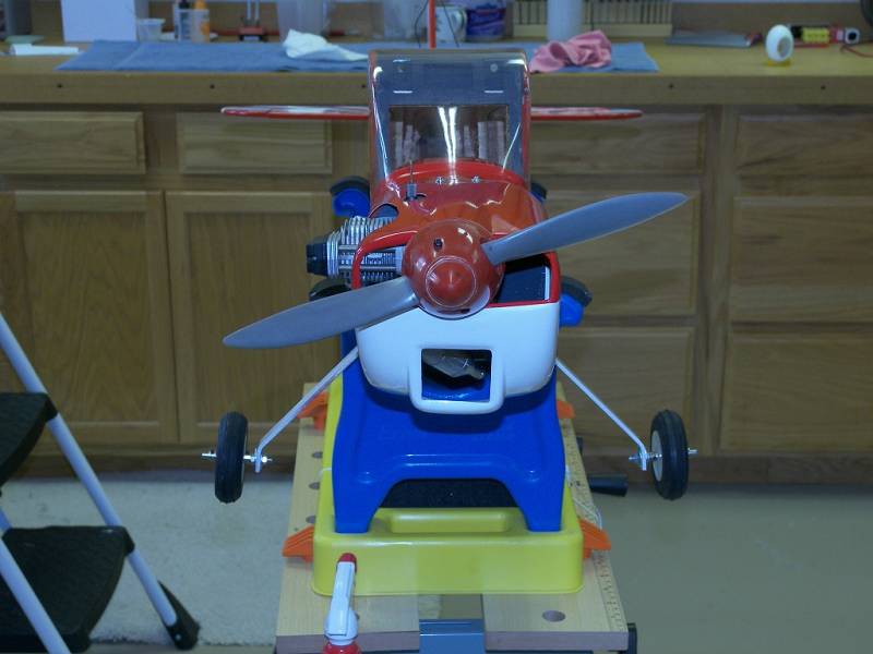

Thankx for the fine pics Howard. It looks like you are using the kit supplied wheels. I ordered some 3" TL tires as replacments. Our field doesn't seem to like smaller wheels. [8D]
#149
I had plenty of clearance with the original tail gear for a 15" prop, but since I installed the Ohio tail gear set, I had to go to a MAS 14X6 wood prop. It clears just fine.
